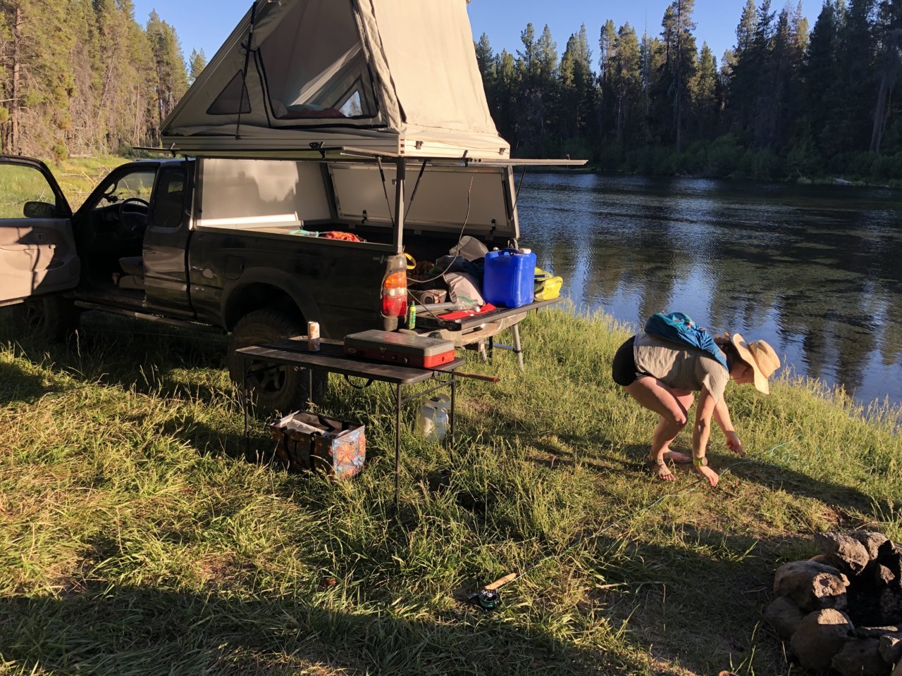

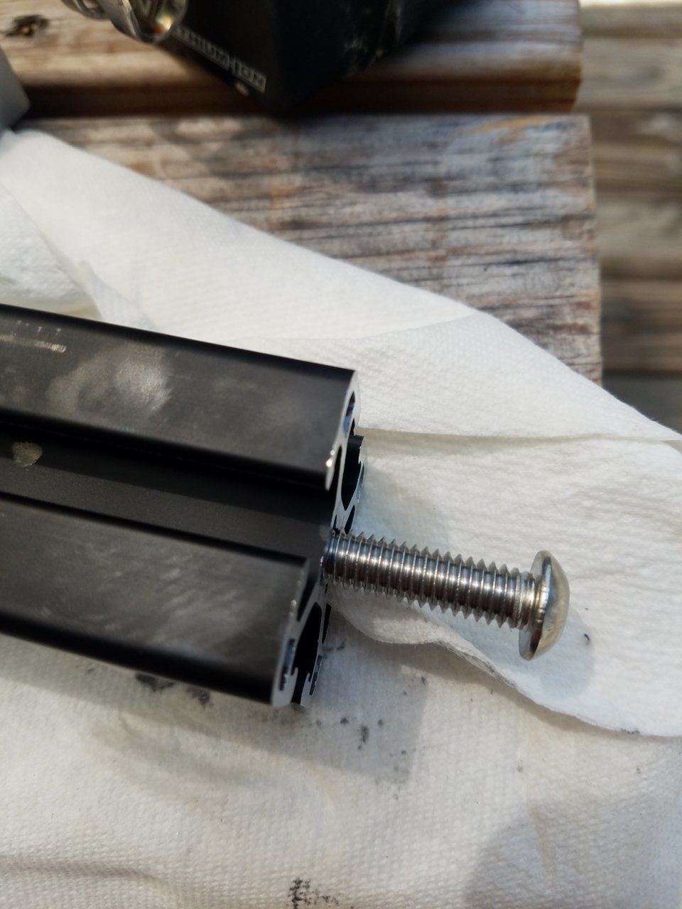

    Just got back from a 12000km trip and 30+ nights in the tent. Couple things I've noticed:
    - The tent IS NOT water tight when closed. If you drive during a storm water will get in. Even with the extra gasket I added around the corner connections water gets it from several places. Water also gets in around the screws that hold the floor and ceiling to the extrusions. The sections of gasket in between the screws is not sufficient, especially since the gasket is in sections to make space for the channel nuts. I will be redoing this with 3M double sided tape + the screws around the entire frame. However this will make my floor and ceiling pretty much permanently attached to the frame, which is why I didn't do the 3M tape in the first place.
    - The hinges in the front need adjusting often to maintain a tight seal between the frame and the bulb seal.
    No water issues while the tent is open. Sheds water well and dries quickly.
    I will post updates for these changes once I get around to them.
    Anyone else having issues with water?

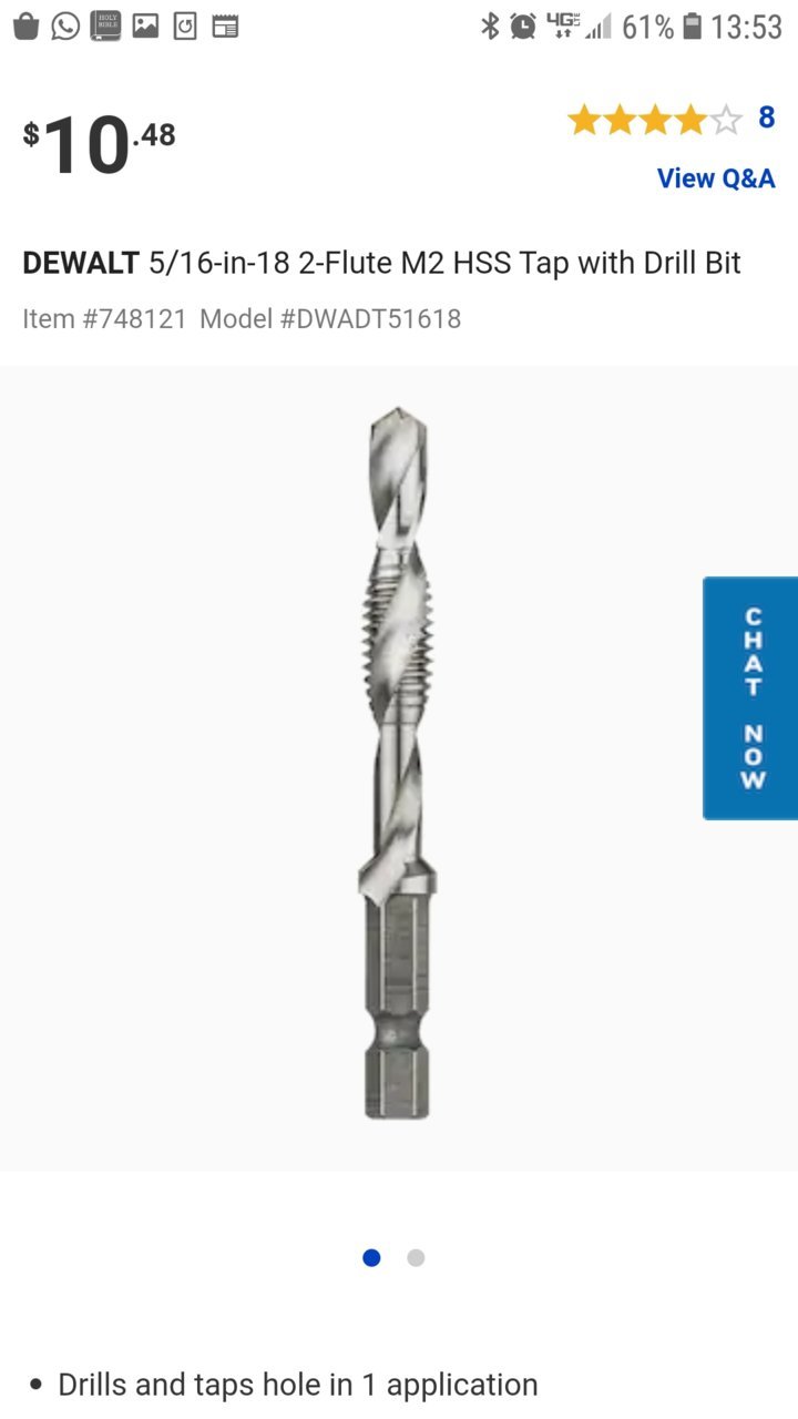

    Do you guys think this combo bit would work?

    ^^^ that's exactly what I used

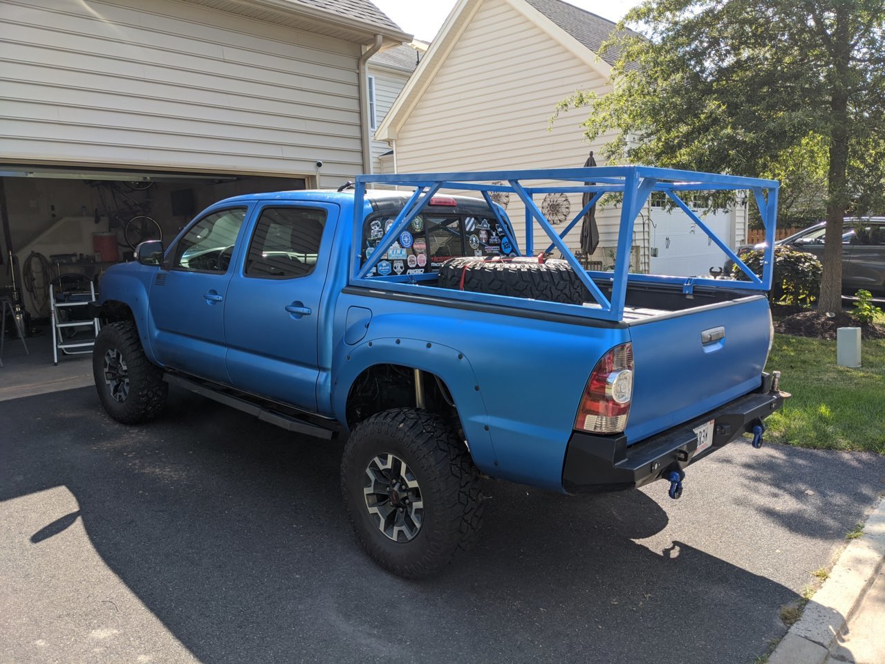

    Finally mounted up!
    Panels are getting cut and then a Roofnest Sparrow XL gets mounted on top. @Ripcord thanks for all of the info. Super excited about my version of your build!

    Did you run a regular tap down in afterwards?
    Just picked one up and it doesn't tap deep enough.15974229934948702572725607009399.jpg
