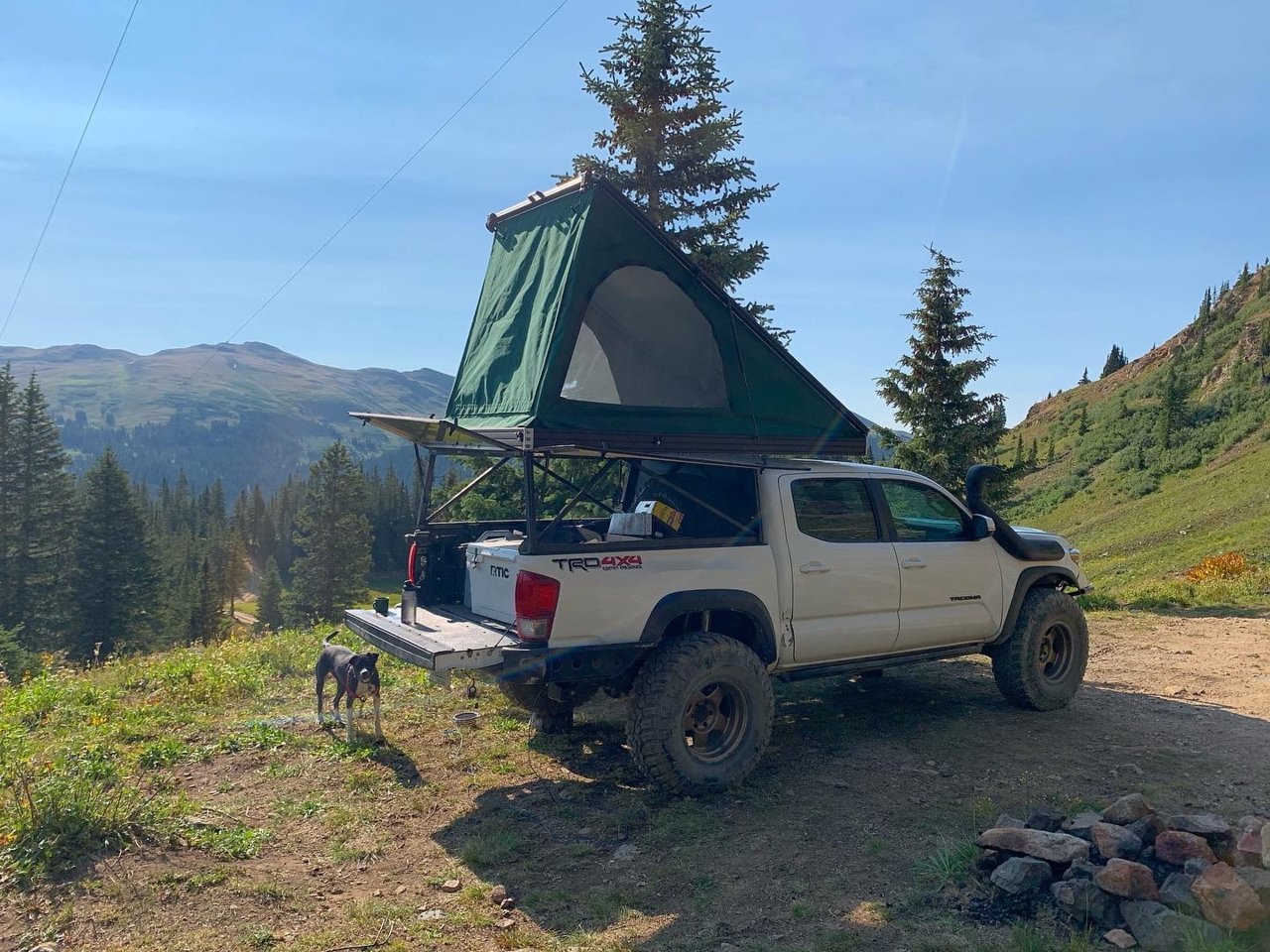

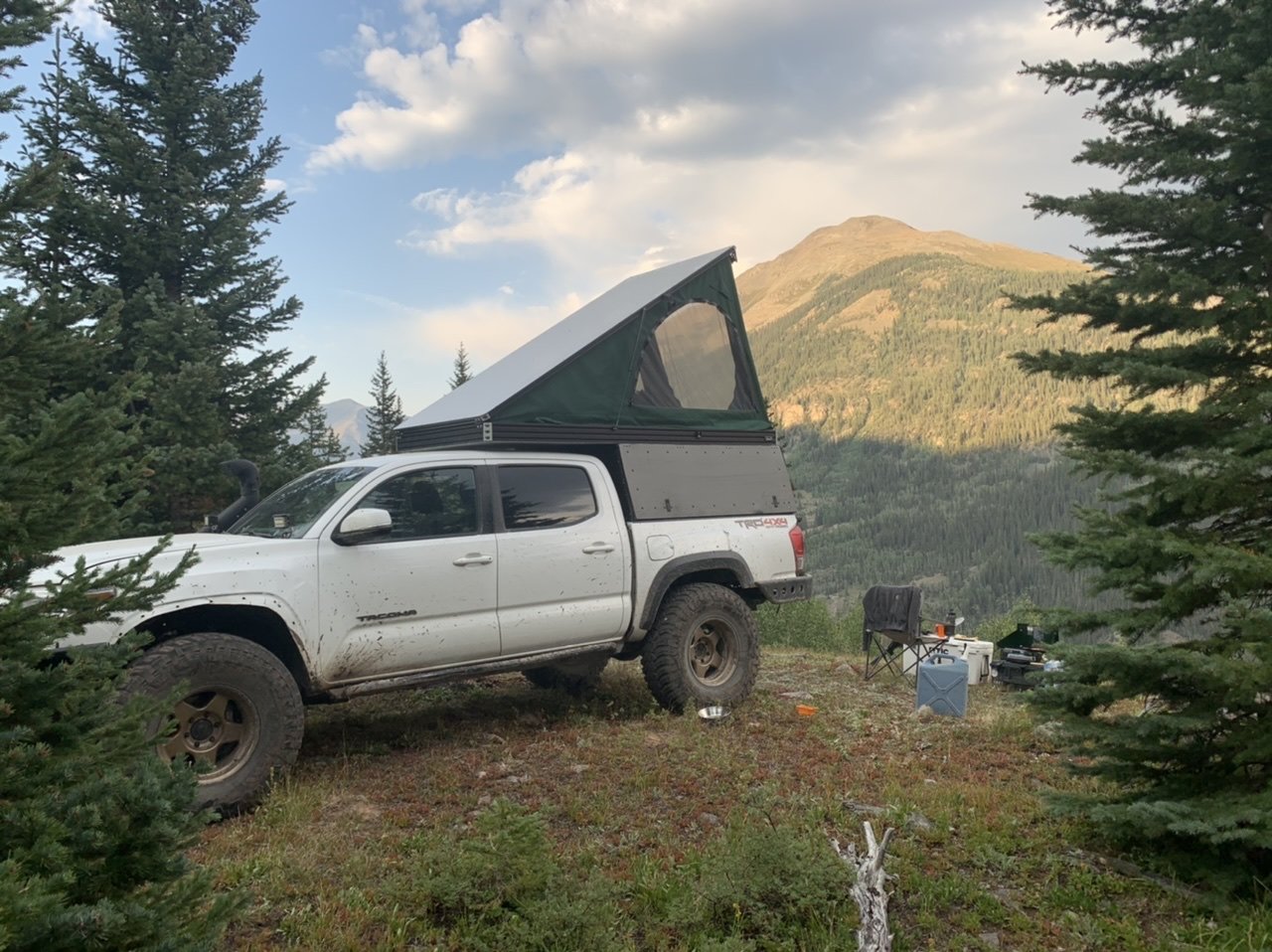

    Forgot to update with camp picture. Here’s a couple, including tonight’s spot
    553C92EA-583F-4946-8C53-B678C336D24F.jpg 523AD4A0-8072-48D9-B0BB-7401778FC70D.jpg
