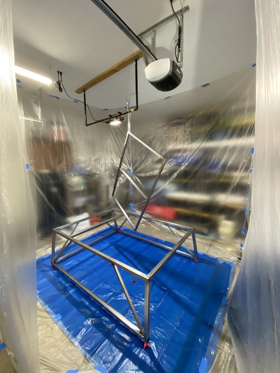

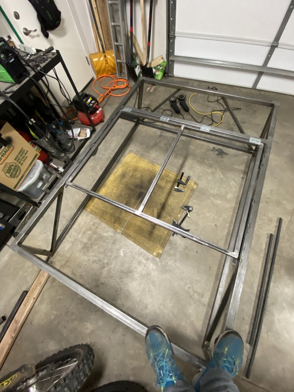

    Well welding and grinding is all done. Got the lifting floor panel portion all done up. Modified ripcords panel files in fusion360 to fit the first gen as well as my custom floor.
    Time to paint. I am unfortunately gonna be painting before drilling the rest of the holes as the weather is about to get cold and wet and I want my paint to be able to dry and to be able to have the garage door open to air it or without 30 degree temps getting in lol. I figure it will be fine if I just touch up all the holes with paint. I plan to also silicone every bolt that goes through or into the frame to keep all moisture out.
    Panels should be done here tomorrow, hopefully. Extrusion is assembled, just waiting on extra screws to finish it. Then it is basically down to assembly and what will likely be the hardest part, sewing...

    very simply is how haha. I didn’t want to think about any complex gas strut mount. The route I am gonna go is to either have a strap I can pull down from the tent roof frame to hang the floor in an upright position or I am going to drill some holes and make a prop rod similar to something like a car hood. The goal is to just be able to open it hang out or change in there if needed, so it doesn’t need to be fancy, just needs to move out of the way.
    I am going with the megamat as planned, I am just counting on it being able to slide up as you tilt the floor up. We shall see!
