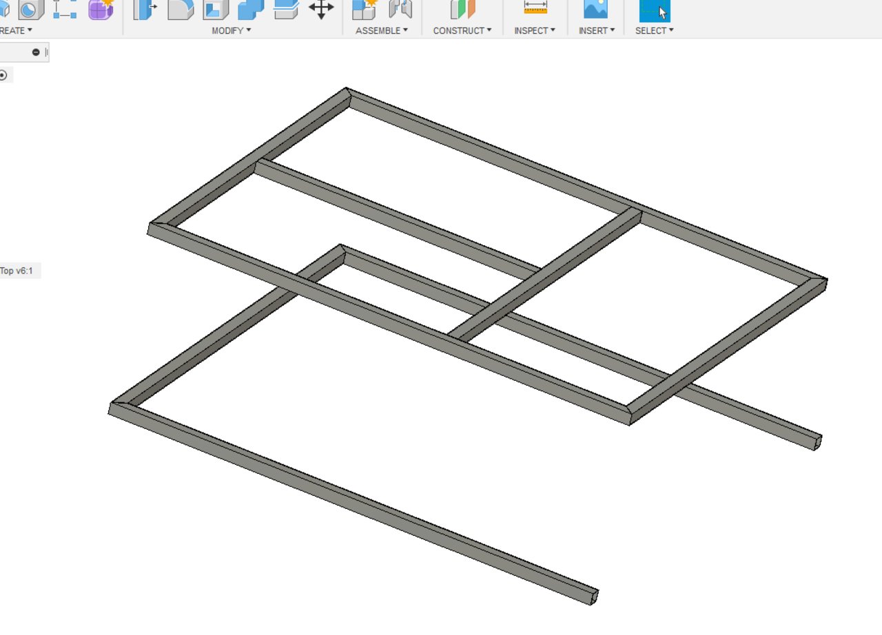

    cutting angles is my weakness. but these days I just cut them long and sneak up to it. Im going to have to miter the corners to avoid having to weld caps onto the end.
    I picked one of these up
    https://www.homedepot.com/p/Evoluti...d-Multi-Material-28-T-Blade-R255SMS/310500941
    we have one of the Evolution circular saws at the makerspace for cutting steel and its really confusing to take a circular saw to sheet steel or metal in general. Like your body resists you from putting the saw on the chunk of metal. A miter saw with an Evolution blade will also work well, just go slow. I invested in a complete metal miter saw because I will use it for many things and it can use wood blades / its better than my current $50 miter saw

    So I am definitely a noob in the fusion 360 dept. How do you angle the tube? I have the frame built.

  8. Nov 7, 2020 at 7:22 PM
    #748
    JMcFly
    JMcFly Well-Known Member
    Aug 11, 2020
    #337348
    1,338
    Central FL
    2012 Tacoma SR5 4x4
    welcome to my world.
    I just remembered how to use joints to get the top and bottom aligned in free floating space. What I am going to do next is make my vertical support pieces and probably do the joint tool again since you can align it however you want. and then use some sort of offset plane or an intersect tool to trim the tubes to length.
    I'll probably dork around with it tomorrow.
    --friend of mine sent a video of him doing what I need to do in fusion and I can confirm the joint tool is what youll use and then redo the extrusion on the support and do "to face" or surface and boom... compound angles. I cant share the vid he made because I don't want to share the dimensions and such since those are part of the paid files

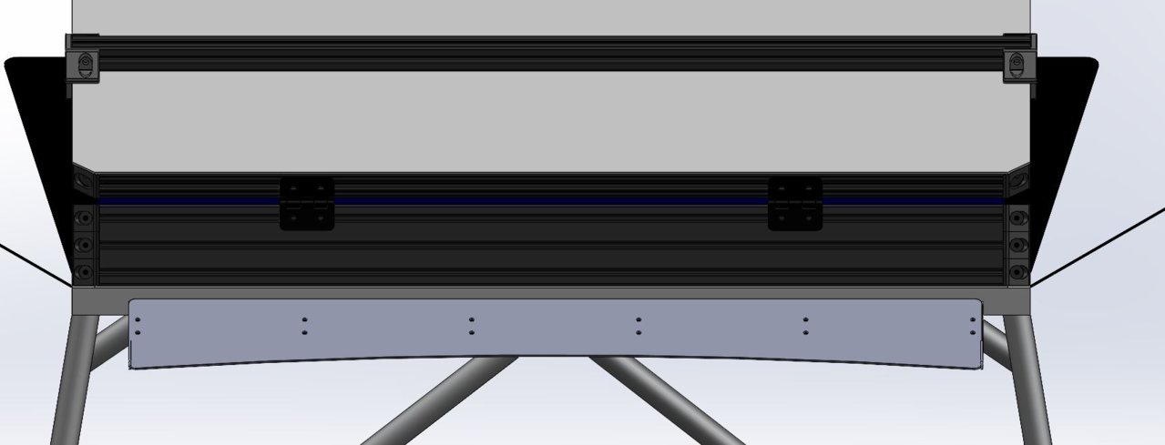

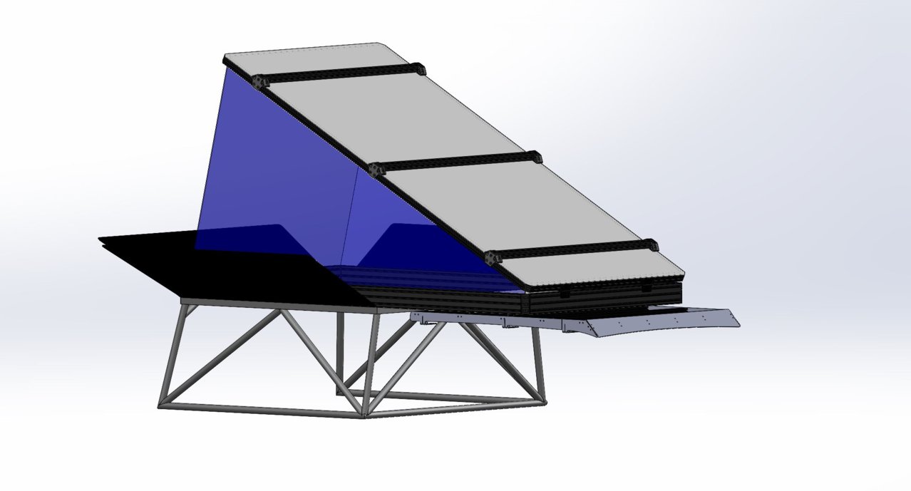

  17. Nov 8, 2020 at 4:33 PM
    #757
    CayucosTacoma
    CayucosTacoma Just think outside the Yota
    Mar 9, 2012
    #74580
    5,597
    San Luis Obispo/San Jose
    2004 Double Cab 4x4
    Specs in the Build Thread
    Huh that's a bummer.
    Thanks for trying it though, guess that saves me some time.
    Ah, that does reduce the interior a bit. that'd put you at like 43" interior space if you're using 1.5 extrusion.
    There was a member a few pages back who is using 1" extrusion for weight, could ask for his opinions.
    As far as appearance wise I don't think it looks too bad to have the stickout. I think a flush with Prinsu would look better but not sure if it's worth the sacrifice in space.
    Here are a few screen shots of my CAD with my DIY roof rack which is about the same width as a prinsu. (this is for a first gen though).
