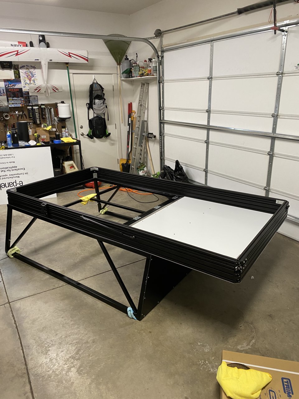

    Current state here
    I think the aluminum rivets I got are problematic, havent tried the black ones, but the silver ones are. Two different rivet guns and they wont break off where they should. The rivets that came with the gun (same size) work perfectly. Hoping the black ones arent problematic

    I'm curious how did everyone else sealed their 3mm roof alupanel to extrusion. I'm trying to use 1/16inch ultra-soft foam but it does bulge out the panel quite a bit in between the bolts, almost back to 1/16inch and it looks kind of crappy and probably has a weak seal in the middle. I could double up on bolts but would have to drill 48 more holes and the bulging would not go away entirely.

    This is why I scrapped the butyl tape, it didnt compress easily enough and had bulges. I resorted to some of this instead
    https://www.lowes.com/pd/GE-Silicone-2-10-1-oz-Clear-Silicone-Caulk/3084963
    Dont know how it will seal, but as long as the panel sits flush, this should fill in any gaps and keep water out
    They were breaking off too soon. I suppose you will find out if its just me or my guns lol. It isnt the end of the world if you try one and it doesnt break where it should. I was able to fix a few by taking the rivet sizing piece off the gun to get the gun further onto the rivet

    Thanks for the advise on the sealant it seems like its the best option for this material choice.
    I did try a couple of the flushed and black domed rivets. My first impression is that both of them lack the clamping force to pull the materials together and form a tight joint. I have never used rivets before so I do not know what is normal. But I assumed that a rivet would apply a significant force to compress and join to panels together. If you have better rivets in mind I would like to know.

    I'm coming to the conclusion that these rivets perform in such a way because they have aluminum mandrel. Instead, we need aluminum rivets with steel mandrel.

    My butyl tape had bulges as well (and still does slightly) but I was able to work my way around the perimeter with a clamp and compress the butyl between fasteners. Much less bulging after that but doesn’t completely get rid of it. Probably could have done an even better job if I had applied alittle heat As I went around.
