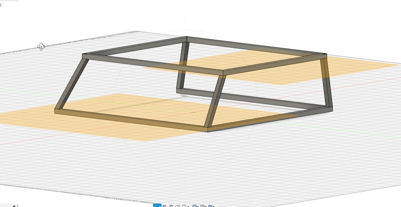

    Not sure if I even want to get involved in this conversation as I am like very new to Fusion 360, but my process was like this:
    Created bottom portion, then using offset plane - made a top portion, used lines to draw the uprights and then moved my square piped instead of lines, aligned it all and used planes as a cutting tool to split the body.
    https://www.youtube.com/watch?v=pNVSiTv4_c0 all I learned from literally this video within one day, if someone is looking for it.
    JMcFly[QUOTED] likes this.
  16. Nov 11, 2020 at 12:00 PM
    #796
    jowybyo
    jowybyo Well-Known Member
    Nov 19, 2013
    #116863
    6,092
    Joe
    Baltimore, MD
    '14 MGM DCSB Postrunner 4wd Conversion, Debadged
    No problem. I was genuinely curious. I know some of these CAD packages let you do some not so legit stuff. Lots of times they let you do these kinds of things and automatically make assumptions about the missing information. Great for small projects, but a real nightmare if you do a huge assembly of parts without fully defining everything.
  17. Nov 11, 2020 at 12:05 PM
    #797
    JMcFly
    JMcFly Well-Known Member
    Aug 11, 2020
    #337348
    1,338
    Central FL
    2012 Tacoma SR5 4x4
    yours looks like it has a lot of rake to it.
    Thats one way to do it. I made two different assemblies, a top and bottom, and brought them into a third file in the event that I wanted to change the sleeping platform it would automatically update the assembly file.
