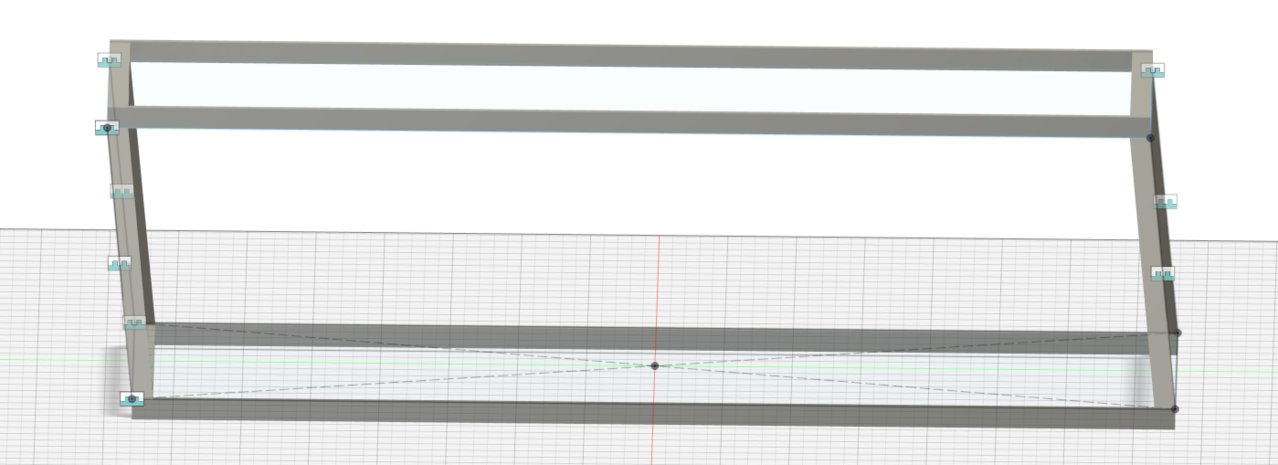

    This is what I figured out in the last 3 days. How do I use the fold flat feature to print templates?

    What I did was make the body a surface. Then unstitch. Then you can create a flat pattern. Then you can create a dxf file from that and use a dxf program to then create a pdf with the correct dimensions.
    This was the only way I could figure out how to make a template that was the correct size. I pieced it together with multiple 8.5x11's. We will see how it goes.

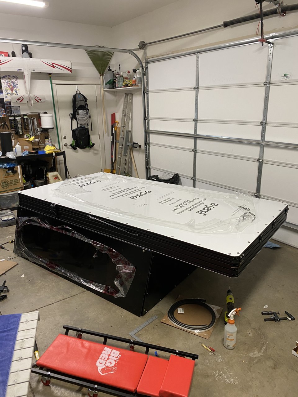

    We are getting there
    Anxious to get it on the truck! I think the door files are maybe a 1/4 inch too tall for a 1st Gen, but we will see. They stick past the bottom of the frame when closed. Luckily however, the frame is right at the edge of the bed rails, so it should not be a problem with how the bed side slopes down and away quickly.
    If I had to do it again, I’d probably modify the door files slightly and move the latch holes up. Still could, new doors would only be $185, so def not the end of the world. We will see how it works out in real life once it’s on.
