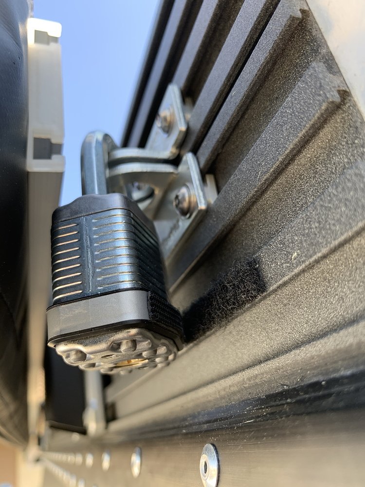

    You could always get some security bolts and make some small tabs with holes for a small padlock by the handle or something too

    It's pretty easy. You just need to cut one bolt off and trim the plastic a bit.

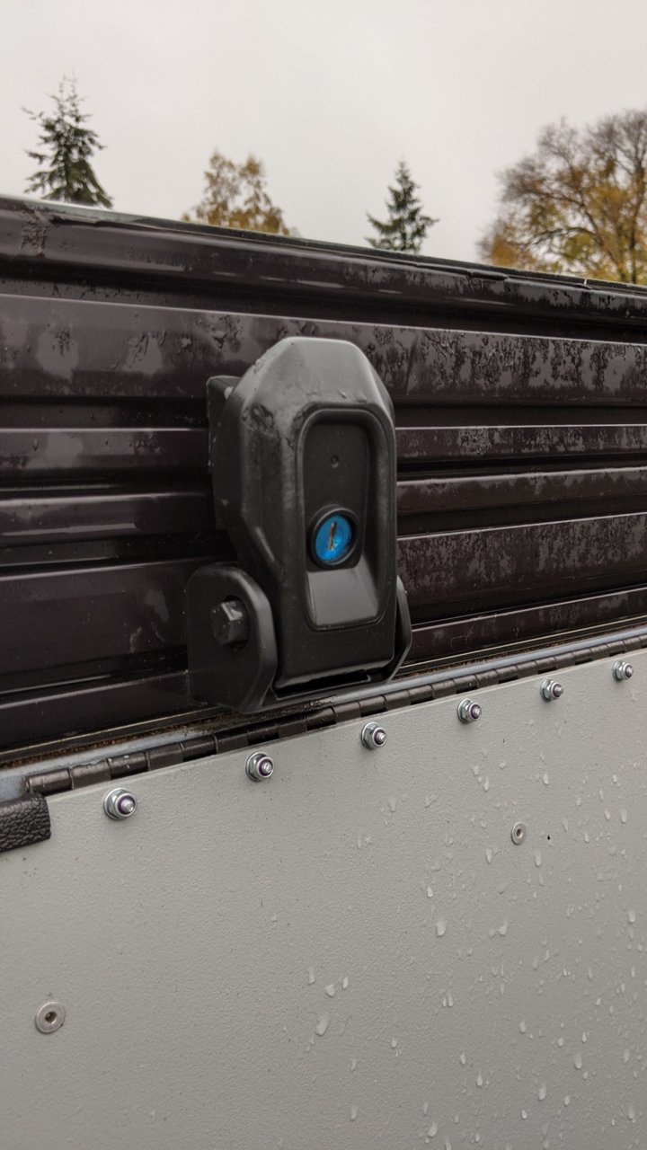

    80/20 has a locking latch. I bought one to try out. I bought the regular keep latches too but might just use two of the locking latches.

    Thanks! Can you still use T-NUT with those? Do you know the diameter and threading of those bolts?

    You can, that is why you have to cut one of the bolts off. You can just spin the whole thing to thread it.
    Edit
    Not sure what the size and threading were but they were exact fit for my tnuts.

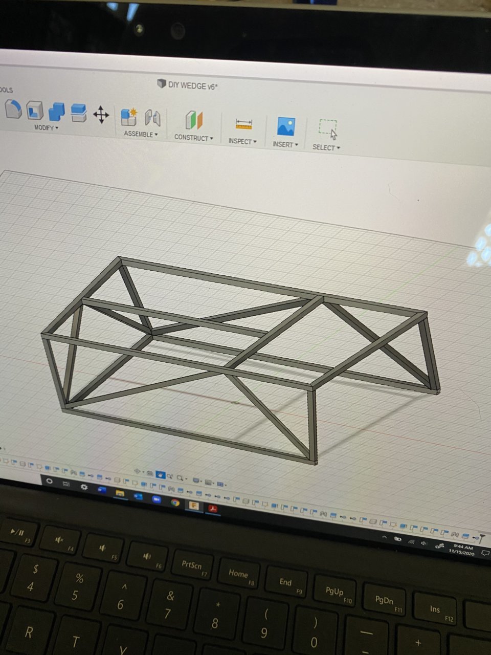

    I'm not familiar with fusion 360 (if that's what you're using). I did mine in solidworks but all I did to make full side templates is create drawings with a 1:1 scale and 3 projected views (1 for each side) in addition to the parent view and then printed those on a plotter. I just had to create a custom sheet size so it fit on the sheet.

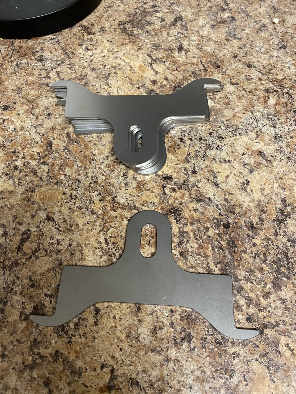

    I second this! $45 and had the parts in 4 days. 95F4BC49-1A12-435C-B7AF-C369EA2C4E32.jpg
