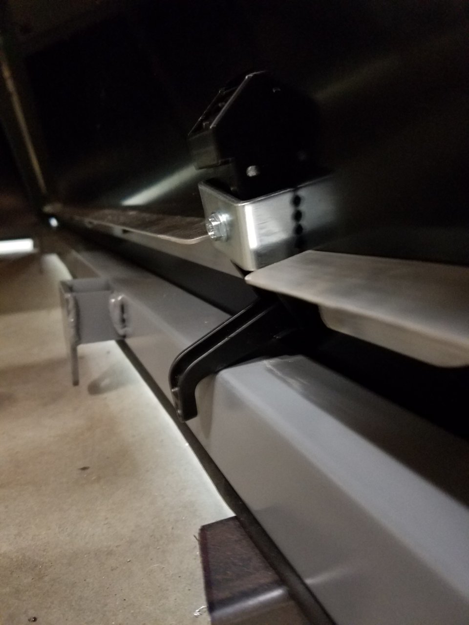

    I had this same issue. What I did was, I cut a slit into the arm which allowed me to bend the arm further up. To finish the job, I simply tacked a few spots with the tig.
