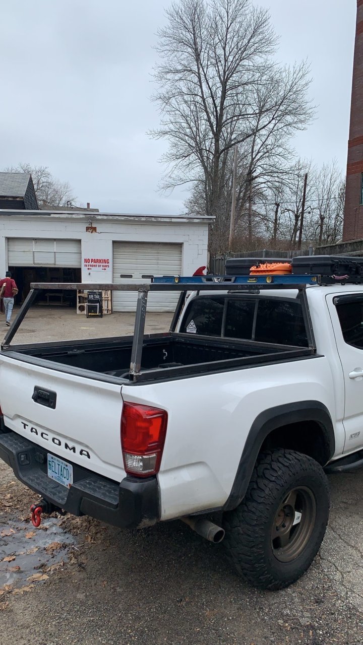

    jp_flynavy
    jp_flynavy IG: @TrailLimoOverland
    Dec 30, 2016
    #206065
    1,013
    2015 Tacoma DCLB
    Is that in yellow? I dig it!
  2. Nov 26, 2020 at 6:42 AM
    #902
    JMcFly
    JMcFly Well-Known Member
    Aug 11, 2020
    #337348
    1,338
    Central FL
    2012 Tacoma SR5 4x4
    Grinder and paint make me the welder I ain’t....
    and maybe filling gaps with weld...that too

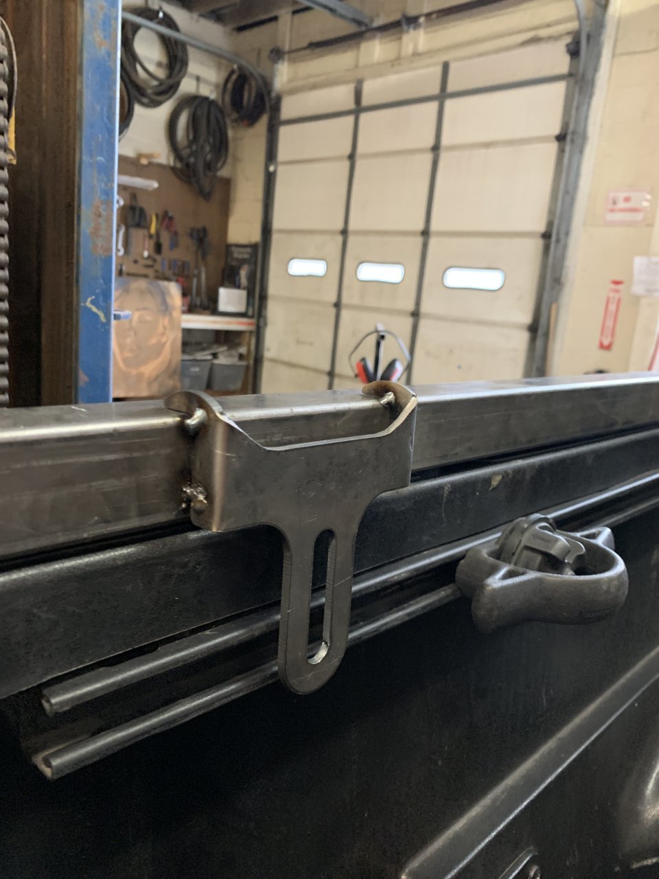

    vitodaniel
    vitodaniel Well-Known Member
    Nov 27, 2018
    #273969
    82
    Vito
    Southern NH
    2016 Toyota Tacoma TRD Sport

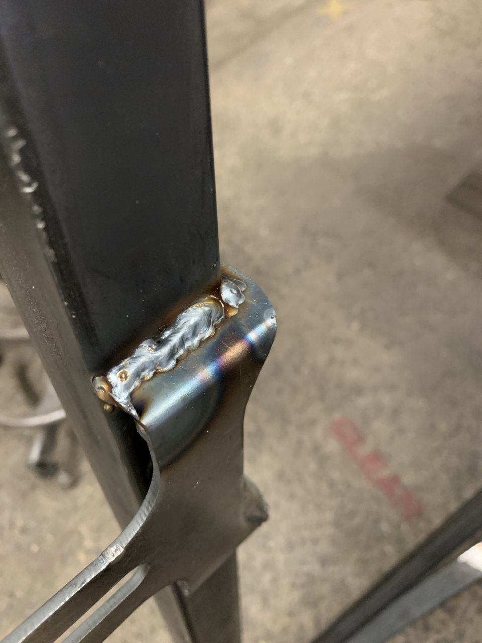

    Yessir. That exactly what I did. Tack welded all gaps until gap was fully covered! Monday brackets will arrive, will bend them and weld them on.
  4. Nov 27, 2020 at 9:06 AM
    #904
    expomax
    expomax Member
    Jan 30, 2018
    #242908
    21
    Max
    97 Cruiser
    Lots lol
    Yessir! 8020 sells powder coated rails in the 1.5" and 3"
    jp_flynavy[QUOTED] likes this.

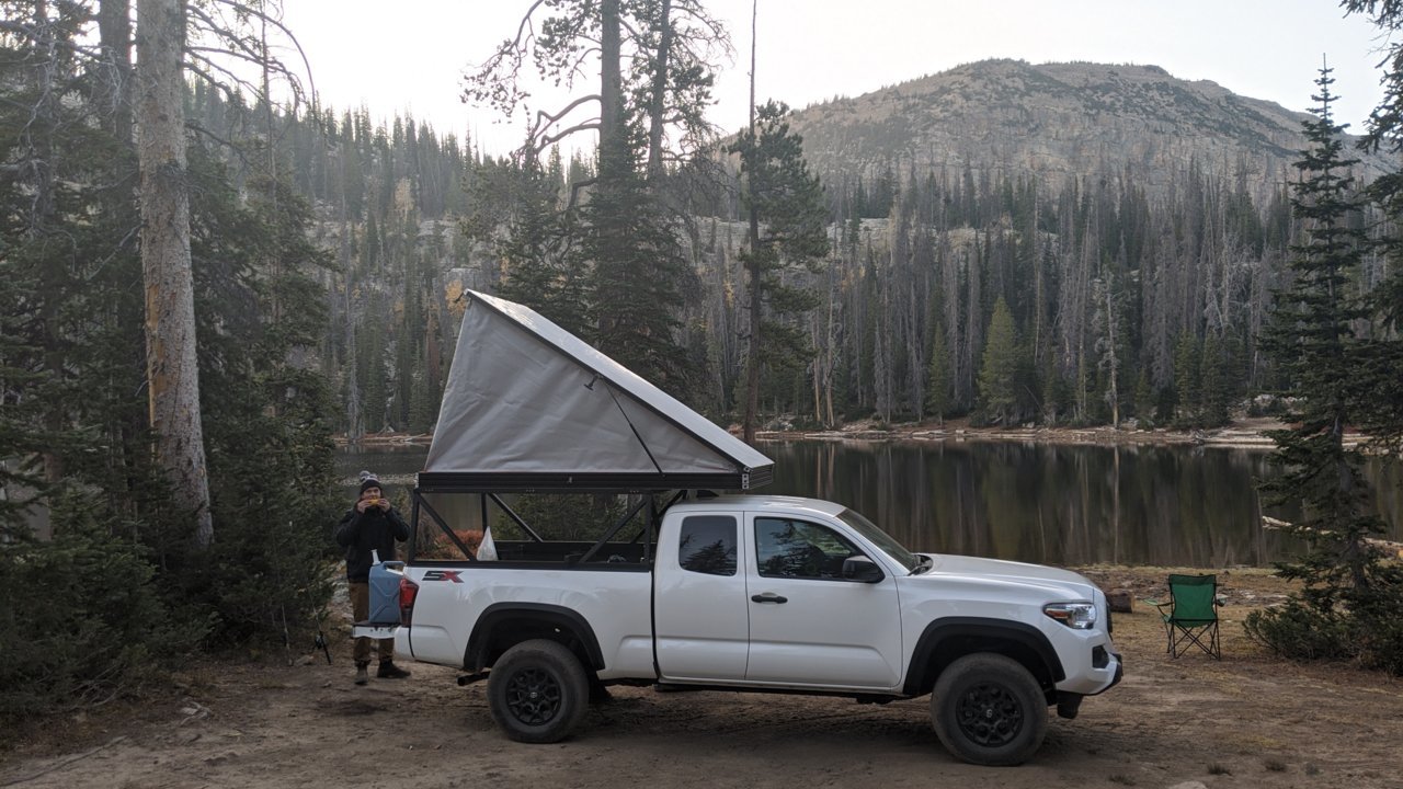

    My buddy sent me a photo since he knows I’m building one of these.
    Wish I could’ve checked in out in person :wave:

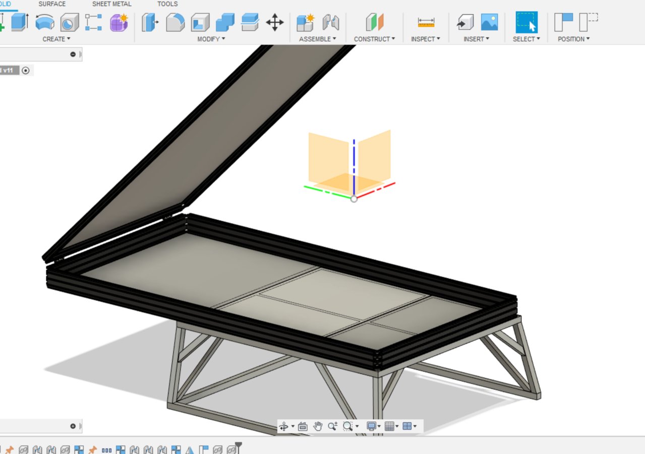

    Did more CAD work tonight.
    Going with removable floor panels like the vagabond drifter.

    What are your plans for making the floor panels?
    also nicely done

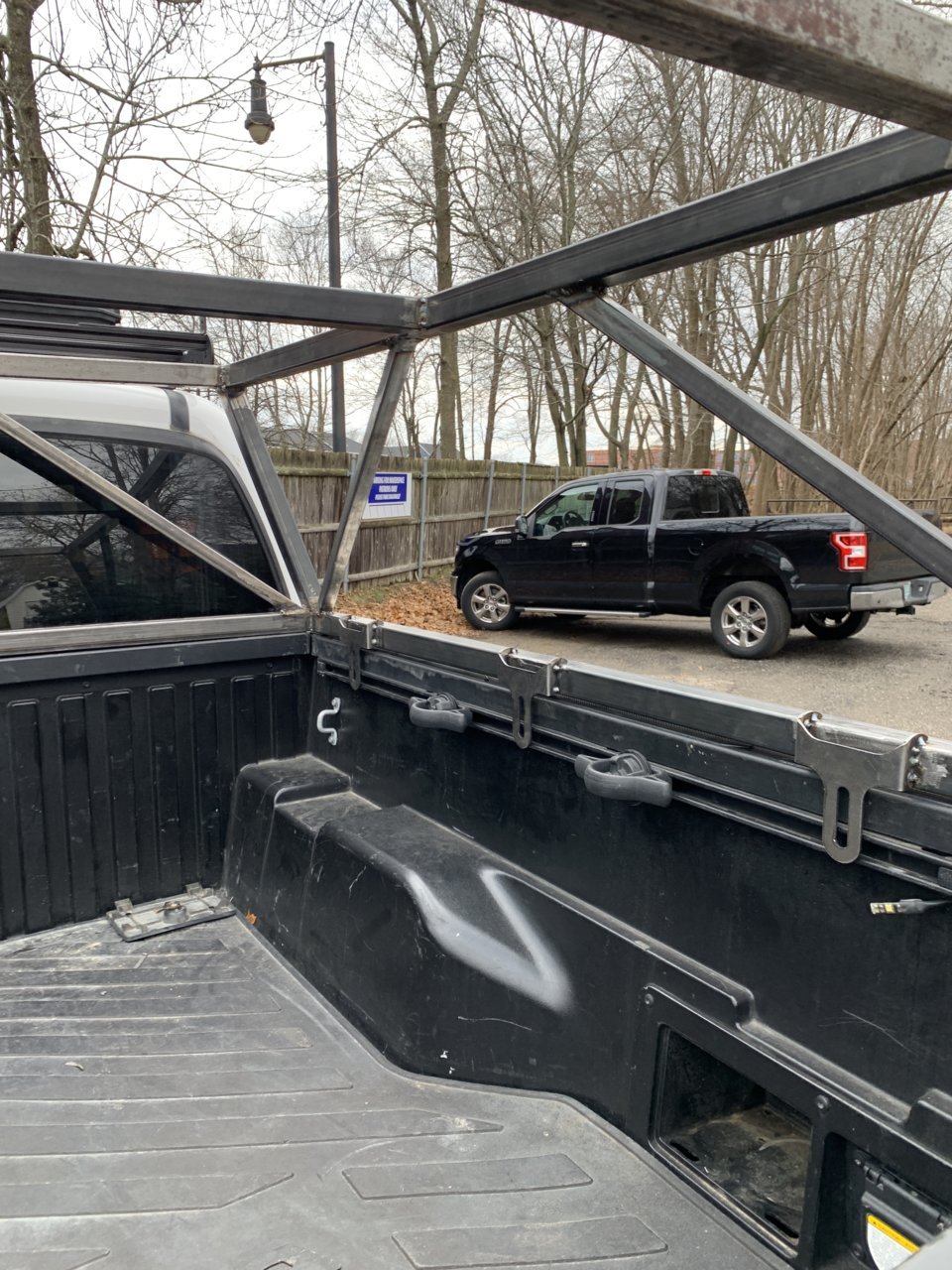

    vitodaniel
    Nov 27, 2018
    #273969
    82
    Vito
    Southern NH
    Welded mounting brackets on, they seem to be a little short, I guess will see once I get my T-nuts.
    Also dumb me completely forgot to drill holes for gas strut ball before welding the gussets......
    Next is welding the cross bars. You think 2'x1' rectangular tube would be strong enough to have the rtt mounted to it?

  15. Nov 29, 2020 at 1:06 PM
    #915
    jp_flynavy
    Dec 30, 2016
    #206065
    1,013
    2015 Tacoma DCLB
    Those brackets will be too short with the dust seals installed.
  16. Nov 29, 2020 at 1:10 PM
    #916
    vitodaniel
    Nov 27, 2018
    #273969
    82
    Vito
    Southern NH
    Dang. They been cut out using @Ripcord dxf file, not sure how that happened....
  17. Nov 29, 2020 at 3:16 PM
    #917
    lukester78
    lukester78 Well-Known Member
    Nov 3, 2016
    #201425
    885
    Luke
    97 Tacoma Single Cab 4x4
    Is it just me or is your frame too short? Unless you’re doing something other than bolting the tent extrusion directly to the frame?
  18. Nov 29, 2020 at 3:17 PM
    #918
    vitodaniel
    Nov 27, 2018
    #273969
    82
    Vito
    Southern NH
    Modified DXF file and ordered new brackets. Will be fun removing these haha
    I am making just a camper, no wedge. Will weld on. cross bars to mount my GFC superlite.
