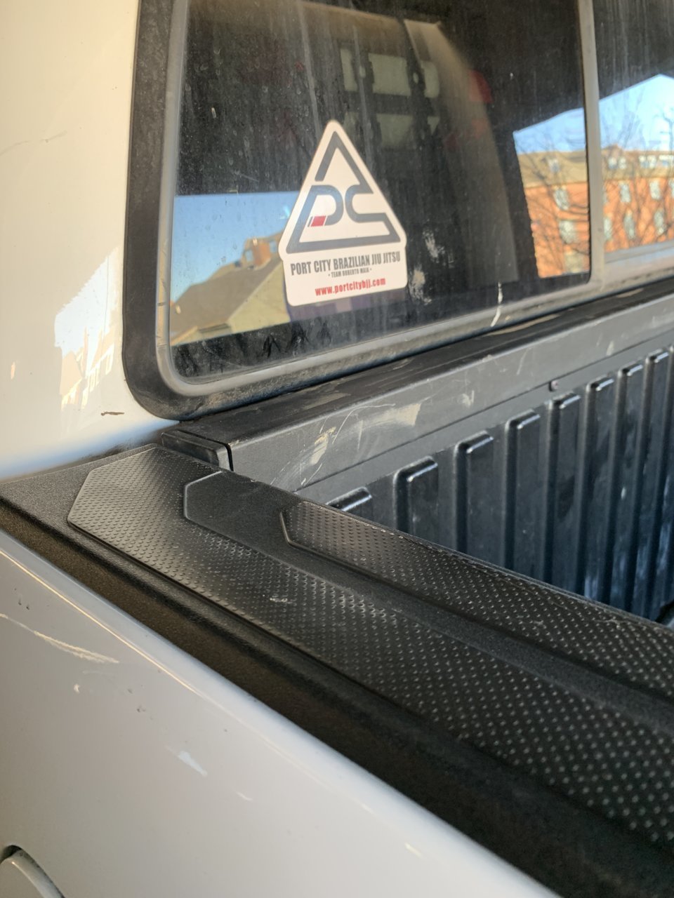

    3d Gen folks, has anyone used some sort of gasket or something in order to level up bed rails? There is nearly 1/8” height difference between side bed rail and bed rail under rear window. Thanks in advance

    Mine sealed but there is a small gap in the middle almost midships (at the tire). I 'm thinking of using a different gasket but have not done the research. I have double bulb down the sides but it's def not big enough. The rail at the back window is fine.
    Zim
    EDIT;
    https://www.mcmaster.com/gaskets/ed...-resistant-hollow-rubber-surface-mount-seals/

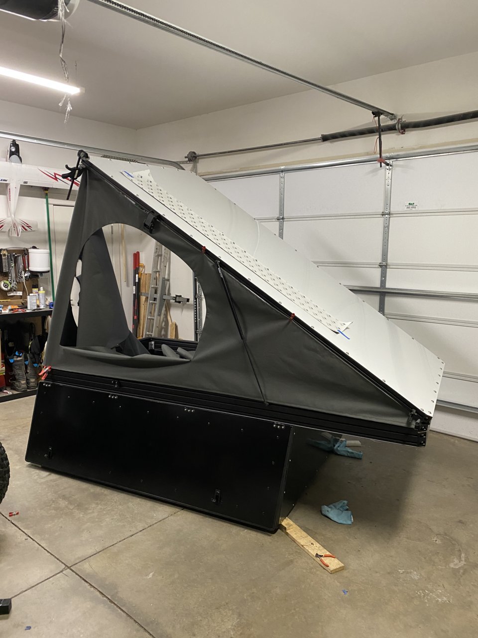

    Couldnt resist clipping the fabric roughly into place to get a look at it before I stitch the zippers and mesh on.

    Two layers of electrical tape. Works great!

    What fabric do you go with? Looks awesome!

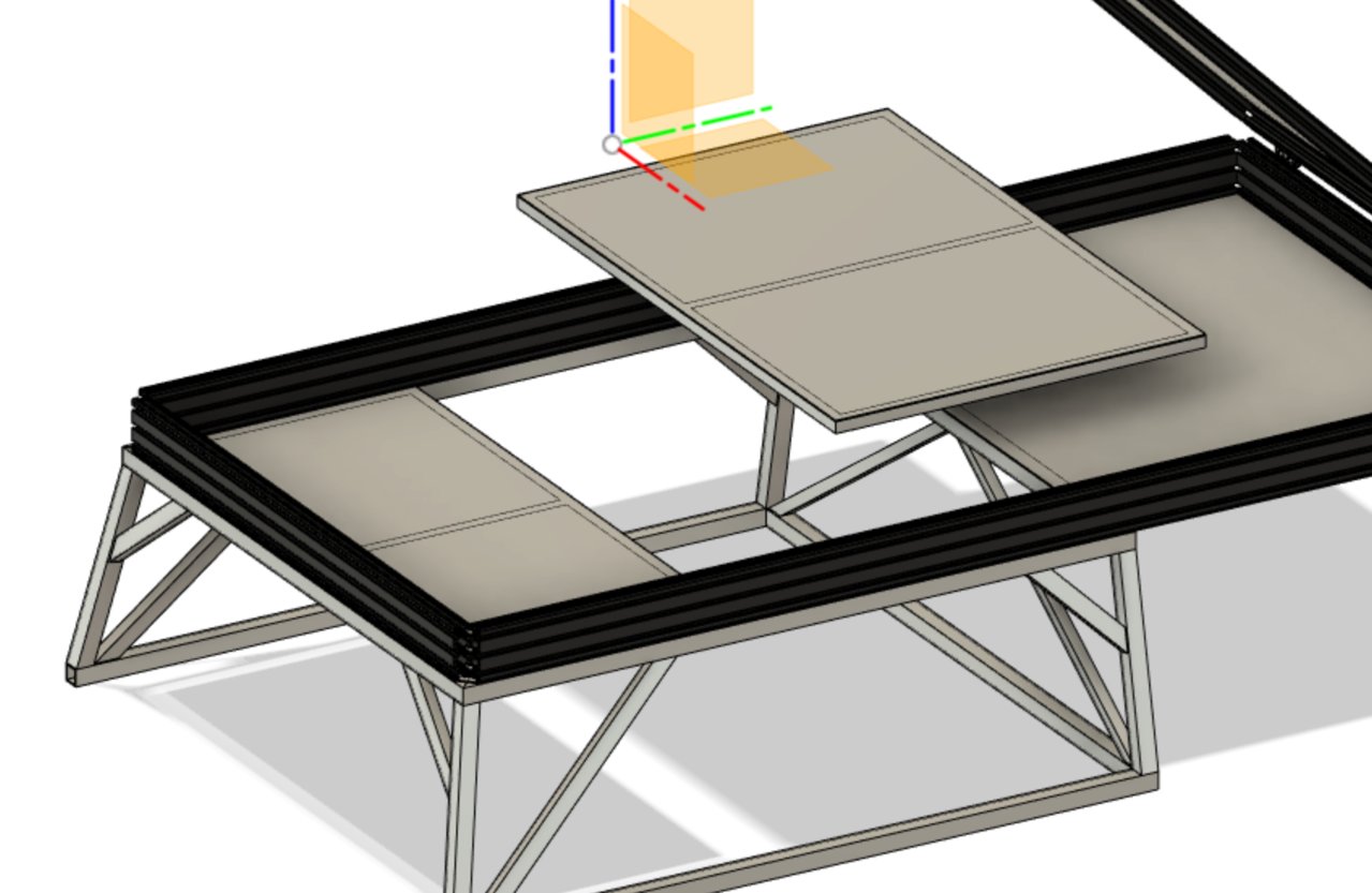

    The middle panel was long enough to support the length of the exped matress, and the rear one just makes up the rest.
    Just a simple box frame with a middle brace and then use the remaining portion of the alupanel to make the top sheet. Countersink the screws, and that's it.
    It'll be supported with angle track running front to back on the inside of the space frame. Probably some felt/delrin on top to help it slide.
    Basically exactly what the Vagabond Drifter does.

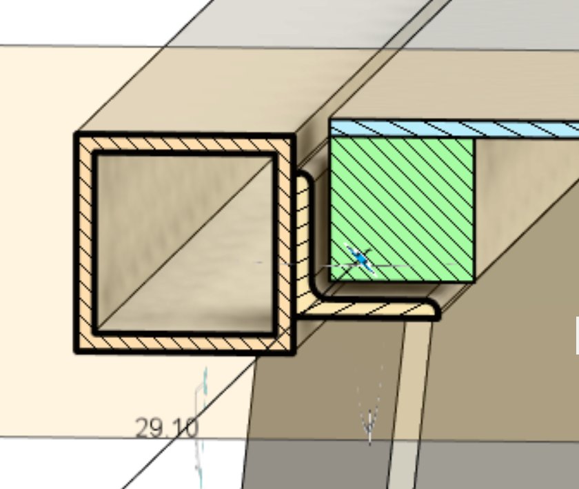

    Cross section for better view:

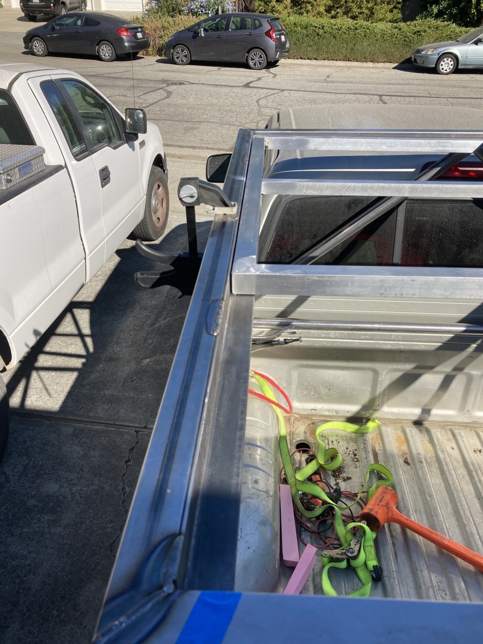

    Just something I came across when I was doing mine (similar idea).
    Since the angle iron has an inner radius the square extrusion won’t be able to sit flush against the outer edge. I cut my square tube short (so it lined up at the edge of the radius) and lined all contacting edges with an outdoor carpet material. I think it’s the general stuff used to stereo boxes and what not. It filled the gap nicely and got rid of the metal on metal noise.
    just something to consider if you haven’t already accounted for it.
    Edit: you can see what I mean here. Before the carpet material was installed.

    Awesome, yeah I left about a 0.25" gap on either side for that. Tough to see in my cross section analysis.
    I was thinking the same thing about the carpet, or even some strips of that slippery black plastic from mcmaster
    https://www.mcmaster.com/4296A177/
    Your carpet idea is probably quieter, I'd hate to hear it clank around all the time.

    right on. I think I used a 1/8” gap and the carpet fills it perfectly.
    Enough friction to hold it in place but can move freely enough with a shove.
    Sounds like you have it all figured out though :thumbsup:

    Why angle instead of flat bar? Seems overkill. I used 1/8” flat bar and it holds up great with 400+lbs up there between 2 adults and the dog.
    I used these EPDM rubber strips to pad my floor support rails and it works great. Grippy enough panels don’t move and keeps everything nice and quiet.
    I just cut them lengthwise to match the width of my flatbar.
    https://www.mcmaster.com/8990K62/
    Also word of warning be careful bringing your floating floor panels to the very edge of the frame as you have it modeled. Remember you need to account for clearing the keder rail bolted to the inside of the wedge frame when you move the panels. I know at least one member had issues with that and had to reduce the width of his floor panels after the fact and live with a bigger gap to be able to remove his floor with the tent installed.

    are the panels made with steel for its frame or aluminum and then skinned in alupanel? Thats my main question really. I can weld steel, maybe thin steel if I am careful but Im not setup or skilled for aluminum

    You can make the frame from 1" steel or aluminum, then the top of it is skinned with the leftover alupanel.
    I'm making everything from aluminum to save weight but you don't have to if you don't have a way to weld it.
    My space frame will weigh 35 pounds from what Fusion has estimated.
