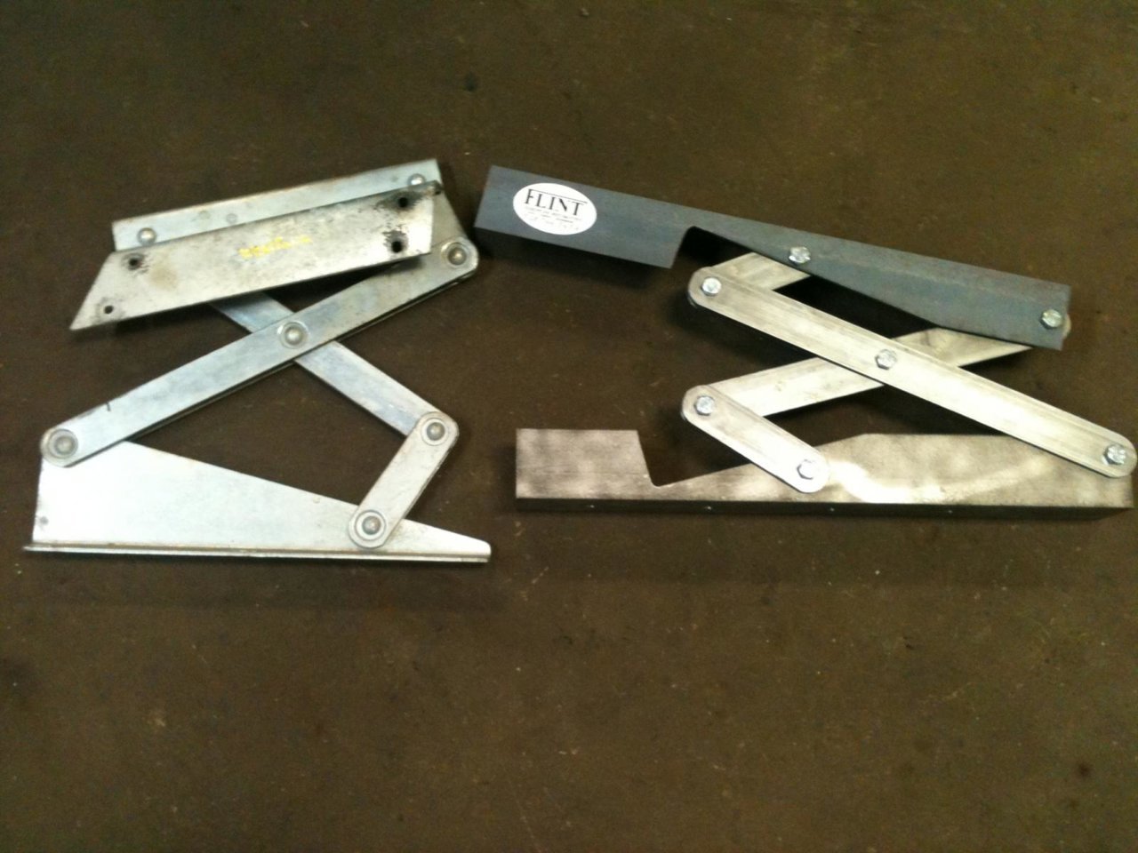

    has anyone looked into doing a hinge design similar to the Westfalia design
    I'm looking at doing something like this hoping to create extra space around the foot
    asanelli likes this.
