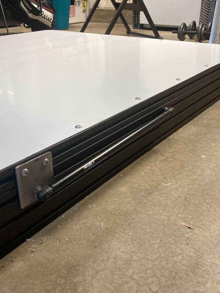

    maybe position them closer to the gas struts? I have noticeable bowing until I close the side latches and then it all sits flat and seals.

    How’s this working out for you? I need a better seal on my wedge. Thinking about doing something similar.
