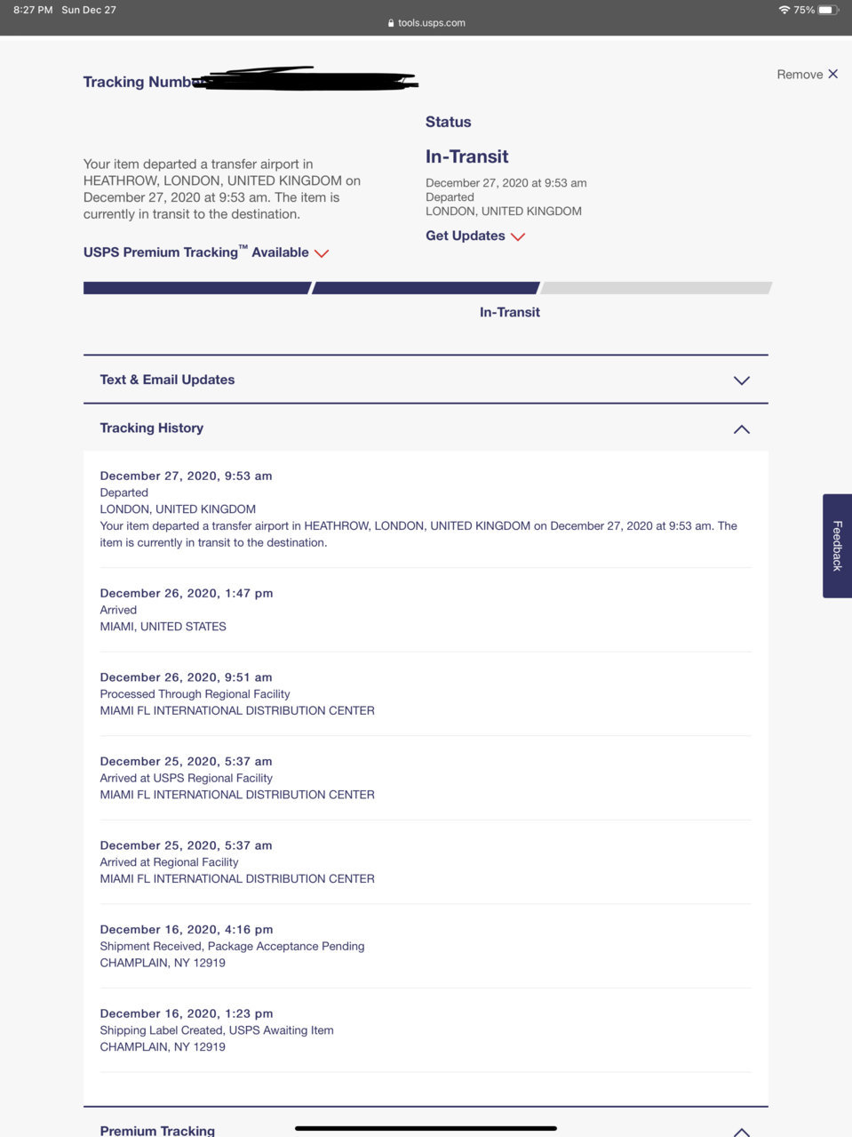

    Well I think my corners for the extrusion might be a little bit lost
    pretty sure the quickest way from New York > California doesn’t involve Florida... or London

  12. Dec 28, 2020 at 7:06 AM
    #1072
    b1g13en
    b1g13en Well-Known Member
    Mar 23, 2017
    #214168
    74
    ben
    2019 TRD Off Road
    Scenic route? haha
