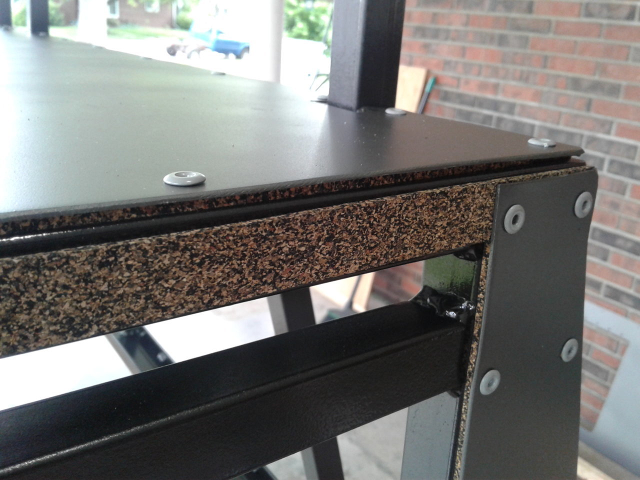

    Looking great! Thanks. How do you like rubber cork gasket? I have a roll but debating between that and butyl tape?

    Hows that cork/foam working for you for waterproofing? I'm seriously considering just sealing everything with silicone rather than deal with gaskets and stuff.

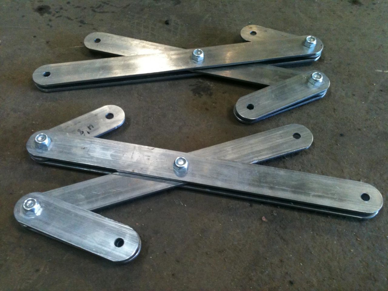

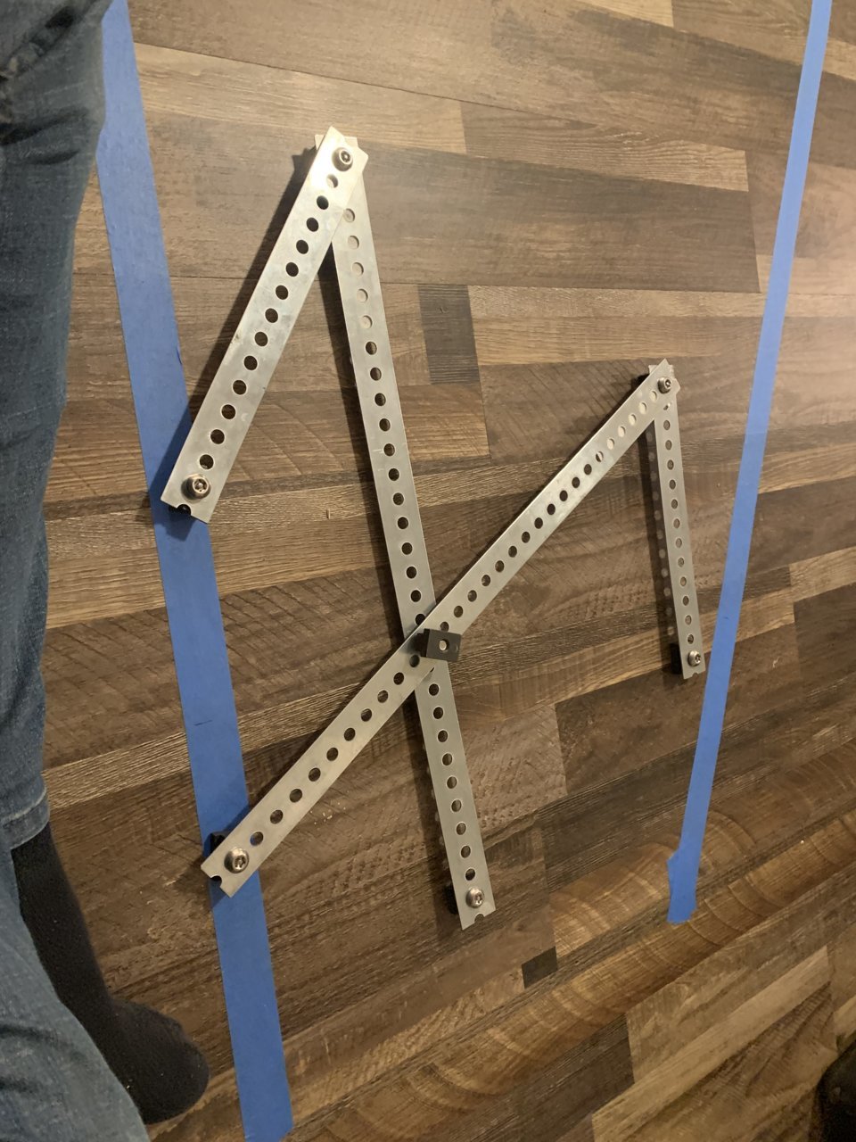

    I think I might have my hinge design figured out
    Anyone have any input on a better anything, or why it might not work
    A plan to use 1.5” x .25” bars double stacked similar to this (2nd photo is not my photo)

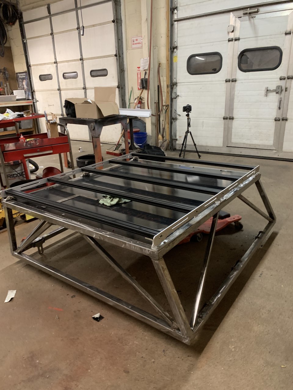

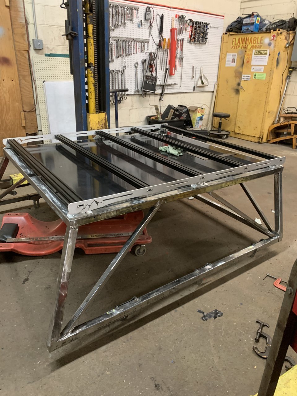

    Test fitted my top rack, next step is drill holes for buckhead panel, finish few welds here and there and painting!
