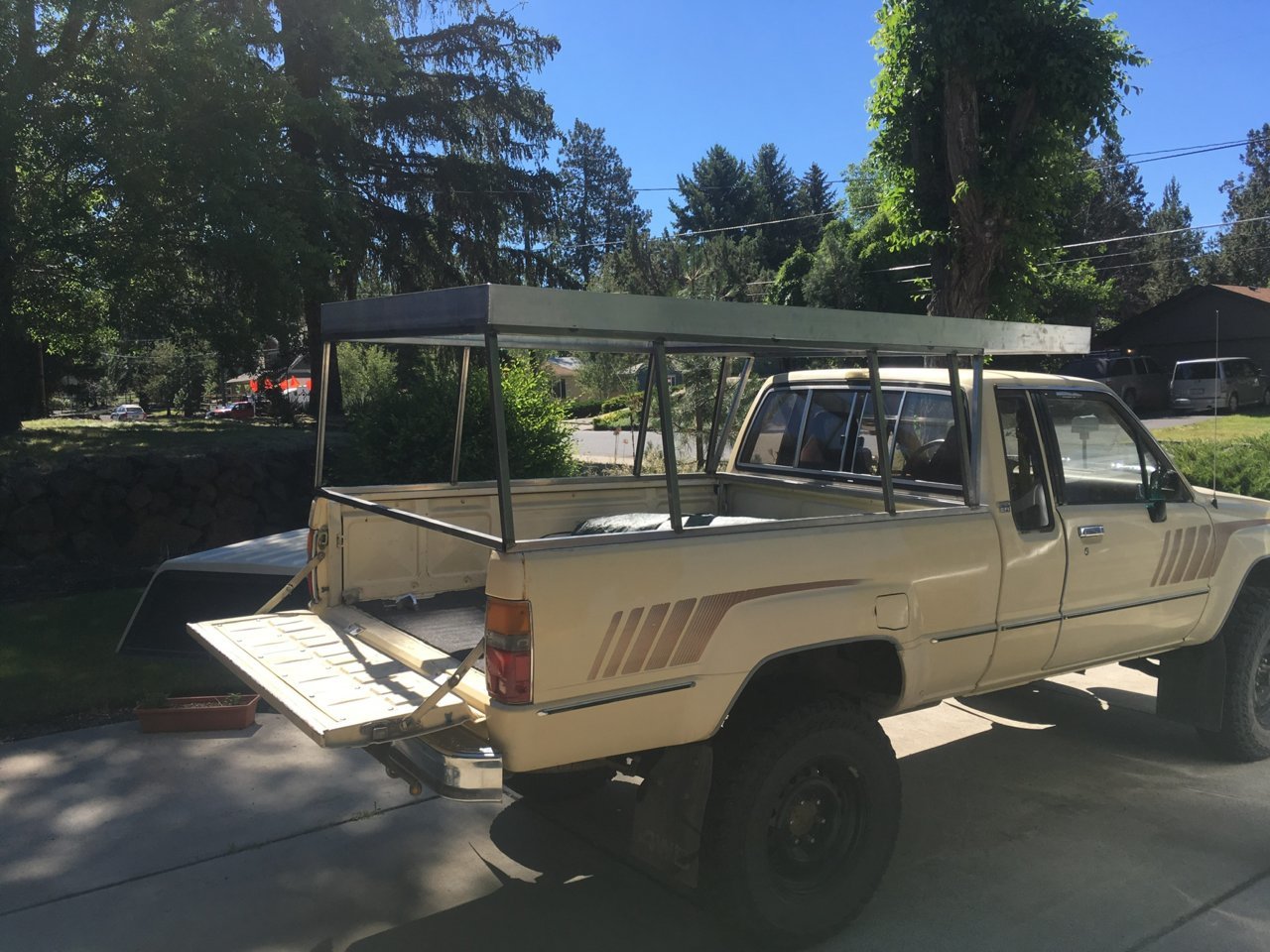

    I have a question about the side panels. The “space” frame uprights are at a 79* or whatever angle but the top and bottom 1” square tubes are at 90*. When installing a side panel does the bulb seal soak up the difference and make it negligible? _/

    Yeah, the bulbs take all that into account.

    Awesome, thanks for the response. What are the seal dimensions that you used? I used 1” square tube for my build as well. Also the southco latches I see on Amazon don’t have the clamp capacity for the 1” tube. Where did you pick up your latches? Thanks again

    Knowing that bulb seal makes up the difference saved me a lot of time and screwing around trying to cut sheets to size and then break them in a press.
