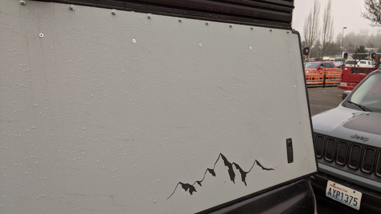

    I rolled mine with the raptor coating. Worked great.

    Picture? Curious to see how it looks after some time!

    It's dirty but holds up great. I do try to avoid larger branches but the sides have been drug across a few.

    Actually what bed liner did you go with? I love how it doesn't have too much of a texturte.

    It was the Raptor two part bed liner. I ended up rolling it on with a foam roller and it came out good. It has some texture to it but not a lot.
