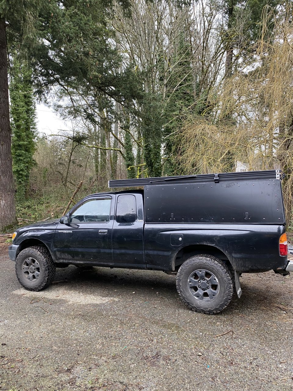

    Wow. Finally able to take this thing out, but have a few minor things left to do. This was the most fun project I’ve done, but did also cry once (trying to attach space frame to the top). Well over 100 hours of work and around 4K (tools included). Don’t underestimate how much time the latter half of the project takes..
    thanks to everyone here who answers questions. It definitely takes a village.

    is your bottom section shorter? It almost looks only 3” tall in the photo

    yep. I went with a smaller bottom section of the tent. Just liked the look of it more.

    Did you go with 1.5" or 1" 8020? Looks good!

    3 inch on the bottom and 1.5 on top. both 8020.
    thanks! It passes the 10 foot test (looks really great from 10 feet away..)

    No problem that’s enough. Did you just give them dimensions? Or did you give them ripcord files?

    How’s the mattress and tent fit with less room? Did you still go with the exped?

    I just have a self inflating mattress in it now. You definitely can’t keep as much up top, but didn’t bother me.
    I can share more once I get it fully loaded and let you know, but I cared more about how it looked.. #neversacrificestyleforspeed
