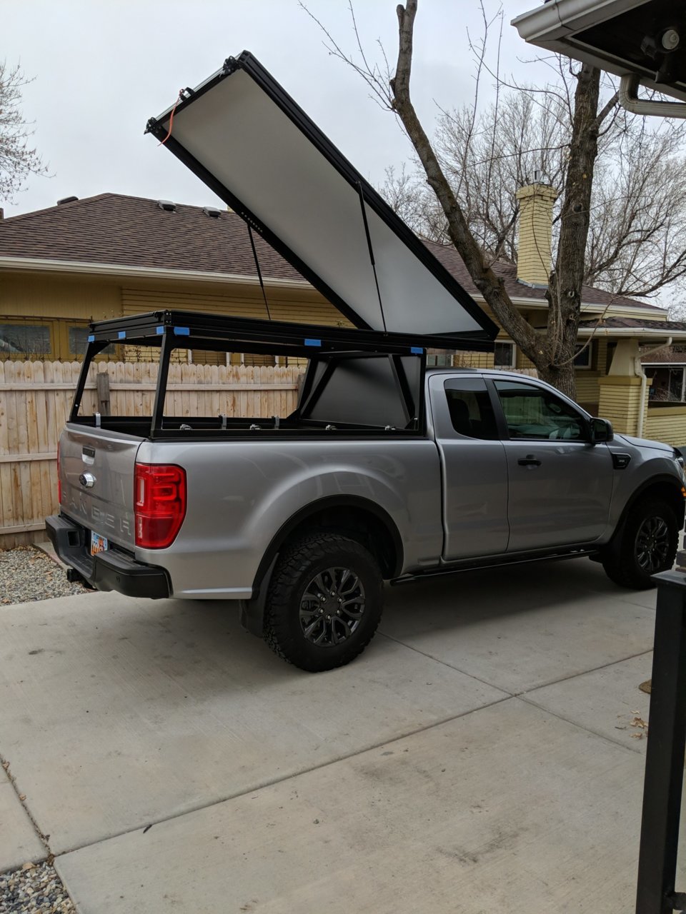

    Progress! This thread has been invaluable and I look forward to sharing the modifications needed to make it fit my needs:

    Anyone have any tips/advice for mounting the panels / cutting the holes for the latches, etc?
    I'm guessing you'll want to orient the struts as vertical as possible when closed...
    I didn't pre-cut the holes for the southco latches as I didn't know exactly how high up I should mount them on the panel.. anyone care to share their measurements?

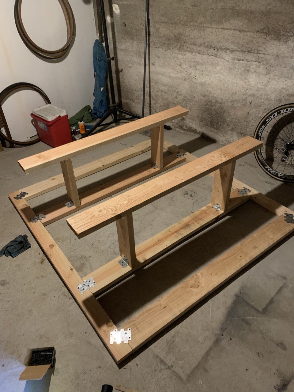

    Finally got started on this project! The easy part is done.

    I just temp attached the doors to the space frame and lined up the latch from the inside. Marked it and made the cuts. Worked out great

    My plan is to use a piece of cardboard to get the measurements dialed for the latches, then transfer that to the panel. I’m still waiting on my panels to be cut, so hopefully I’ll get to see if this works next week.

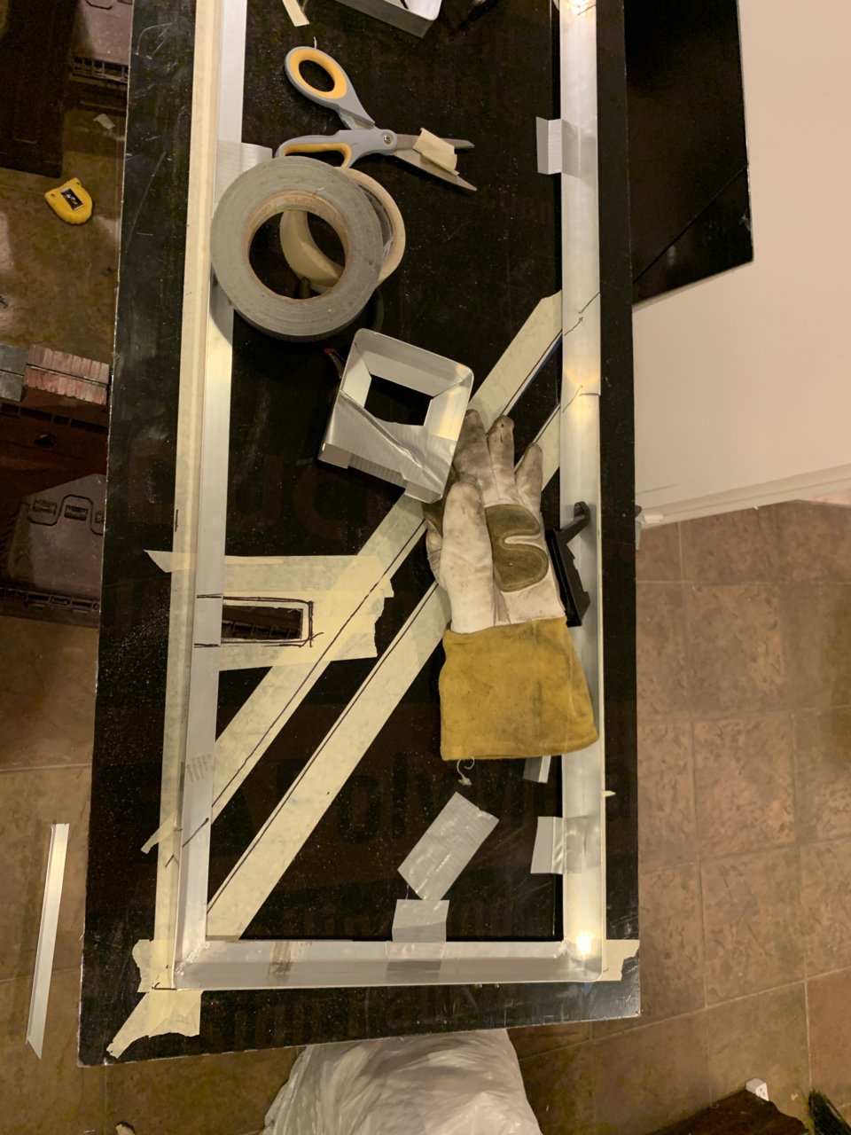

    Just wanted to post a helpful update for anyone working on their panels. I found positioning the stiffeners 3'' from the panel edge ('L' bracket facing outward) was just about perfect for strut placement. I used 1x1'' 1/16 aluminum angle.
    For the side panels, the latch (southco) holes (3 3/8'' x 1'') fit really well on the 1 1/2'' tubing with the bottom cut of the latch hole 2'' up from the bottom the the panel.
    For the rear panel, as the tubing was at an angle, the measurements were a little different. I found that 1 3/4'' in from the side for the latch fit best, but everyone's frame angle will vary so yours may be a little different.
    Hope this helps!

    Got the photo of your l brackets by chance? I went ahead and used aluminum rod brazing but not sure if it’s a good idea. Have to do lots of cuts... considering other options

    Here's one of the side panels (long bed). It's stiff enough for now. I may create a bracket later to bridge the section behind the latch.
