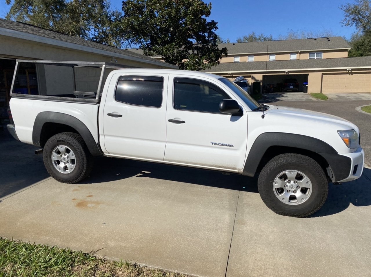

    Waiting on brackets and will do the side supports this week.
    I noticed in the BOM for Ripcords V2 his southco latches cost like $7.10 each. I suspect he used the wish.com version because they are $31 each through southco and most places that stock them. I'm on the fence if I want to buy the cheap knock offs. If I don't then I will only have the rear panel open, I still do not feel a need for the sides to open

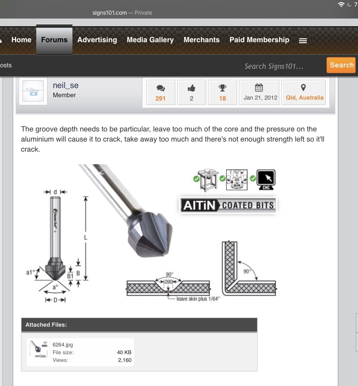

    Instead of the aluminum angle stiffeners for the door panels I am planning to route and bend the Dibond like shown below. I’ll run a bead of aluminum/composite epoxy in them when bending to make sure they are strong. Planning on these bends being very similar to the v2 GFC. If anyone has experience or ideas with this, let me know- looks like the sign forums are hip to these kinds of routed bends with Dibond. Cheers

    That might be pretty cool to get solved. The camper shell makers at super pacific seem to do the same thing.

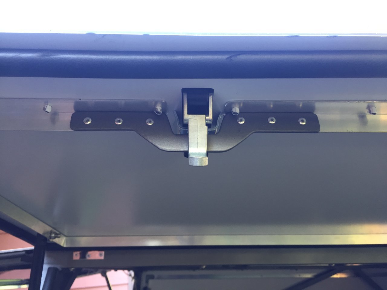

    anybody think about doing the 20 lb 17" gas struts instead of the 28 lb on the BOM? wondering if this would help with flex on the panel while still having enough strength to lift the door adequately.

    That’s probably wouldn’t hurt. The doors don’t take a lot of force so I’m sure the 20lb ones would do the job perfectly fine. When installing one strut was plenty to hold the door open.
    When closed the gas strut force is pretty much inline with the length of the vertical stiffeners. I had quite a bit of panel deflection before I installed my gas struts so I’m pretty sure my main source was from compressing the bulb seals.
    I haven’t had any issues since I added some brackets that tie the stiffeners on each side of the latches together. Haven’t thought twice about it since then.
    JMcFly and bfaris1[QUOTED] like this.

    what did you end up making that bracket out of? it looks good!

    Leftover 1/8” steel flat bar, angle grinder, and a cutoff wheel.
    I just made a cardboard template that fit around the latches without hindering functionality, cut 4 out, painted, and riveted to the aluminum angle.

    beautiful! thanks a bunch
