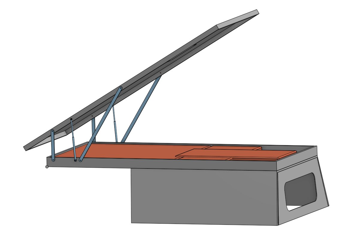

    Looks awesome! I am starting to draw up plans for my own. Are you satisfied with the alupanel for the roof? How do you feel about the vertical space at the "front" of the wedge? That is the biggest issue (in my mind) with the wedge campers, and as such I am toying with the idea of a dual hinge system.

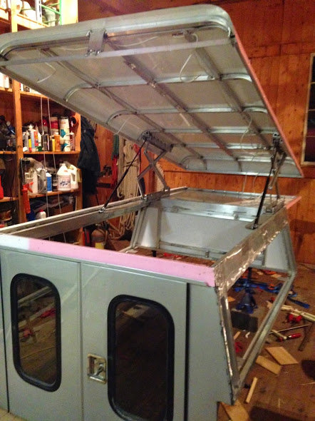

    You could always do a roof that moves purely vertically, like a roofnest or CVT hardshell tent.
    Or a compound hinge like THIS GUY did.
    I considered both of these options and stuck with what I did for simplicity. Been working fine so far, I just stick my feet towards the front.

    Appreciate it! Yeah, I am thinking about doing a compound hinge with 2 differently sized bars and a strut for support.

    I'm personally not a fan of how much forward translation that hinge setup has. Turns the canvas section at the back of the truck into a slanted roof of sorts. And keep in mind you enter the bed area from the back and would want as much space there as possible, so this canvas leaning into that area would bug me.
