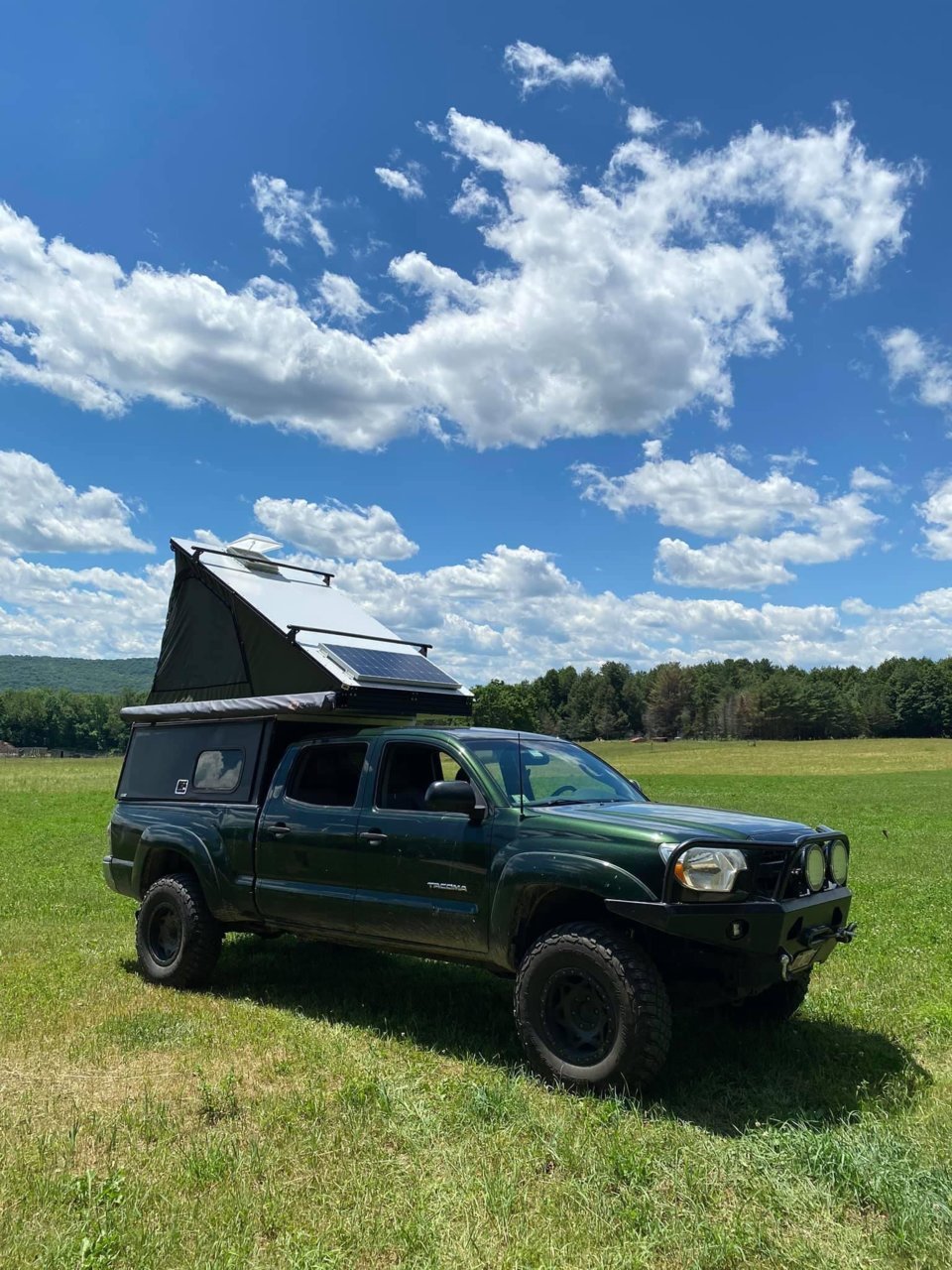

    I guess I never actually came back here and posted the finished product, but since I am here chatting, here's mine! Scabbed the tent onto an ARE Contractor cap. Cut the roof off of the cap, tied the tent into the ARE frame. I am planning on pulling it back apart soon to reinforce everything, she has proved unhappy with all the weight up top. A year of abuse has the patchjob cracking here and there, but otherwise it made for a great summer of weekend trips! It doesn't help that I was rushing to wrap it up for a cross country trip that was eventually cancelled anyway. Oh well.
    Thanks again @Ripcord!

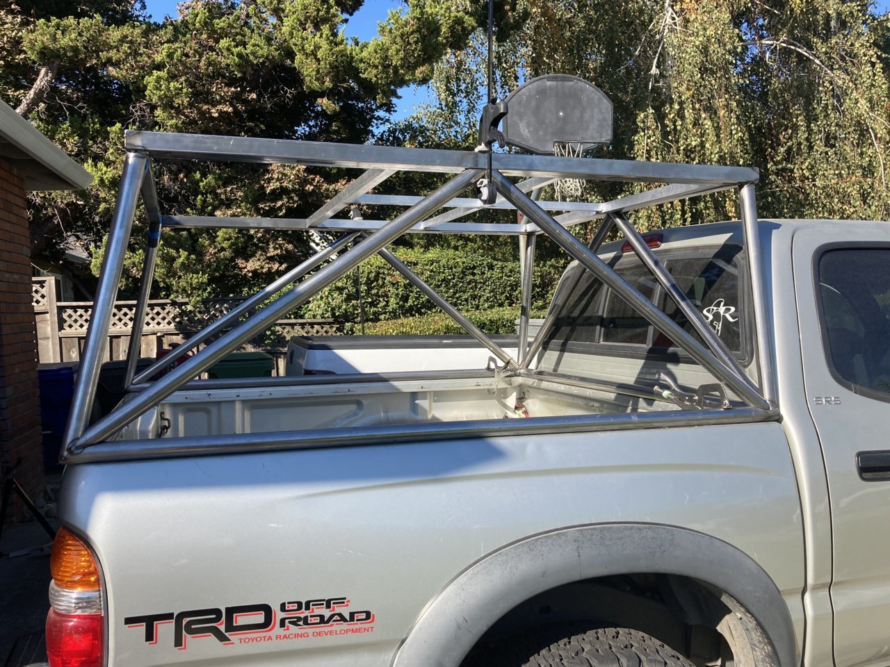

    Awesome! I'm pretty sold on aluminum tubing, do you mind posting or sending more pictures of how the top square and the round bars meet?
    Did you draw all this up in CAD first too? Or just wing it?

    just dig through my posts in here, I don’t post much anymore so shouldn’t be too hard to find. Basically just cut the tubing to line up with the square, nothing fancy.
    Used CAD, but you could also wing it if you have some decent Fab skills. Photo of CAD is floating around in here somewhere. Second time around I would just build it as I went by building the base and going from there.

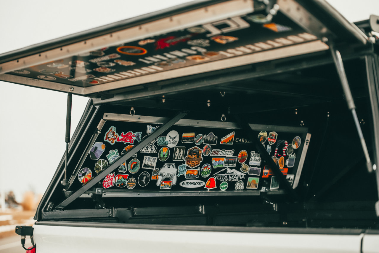

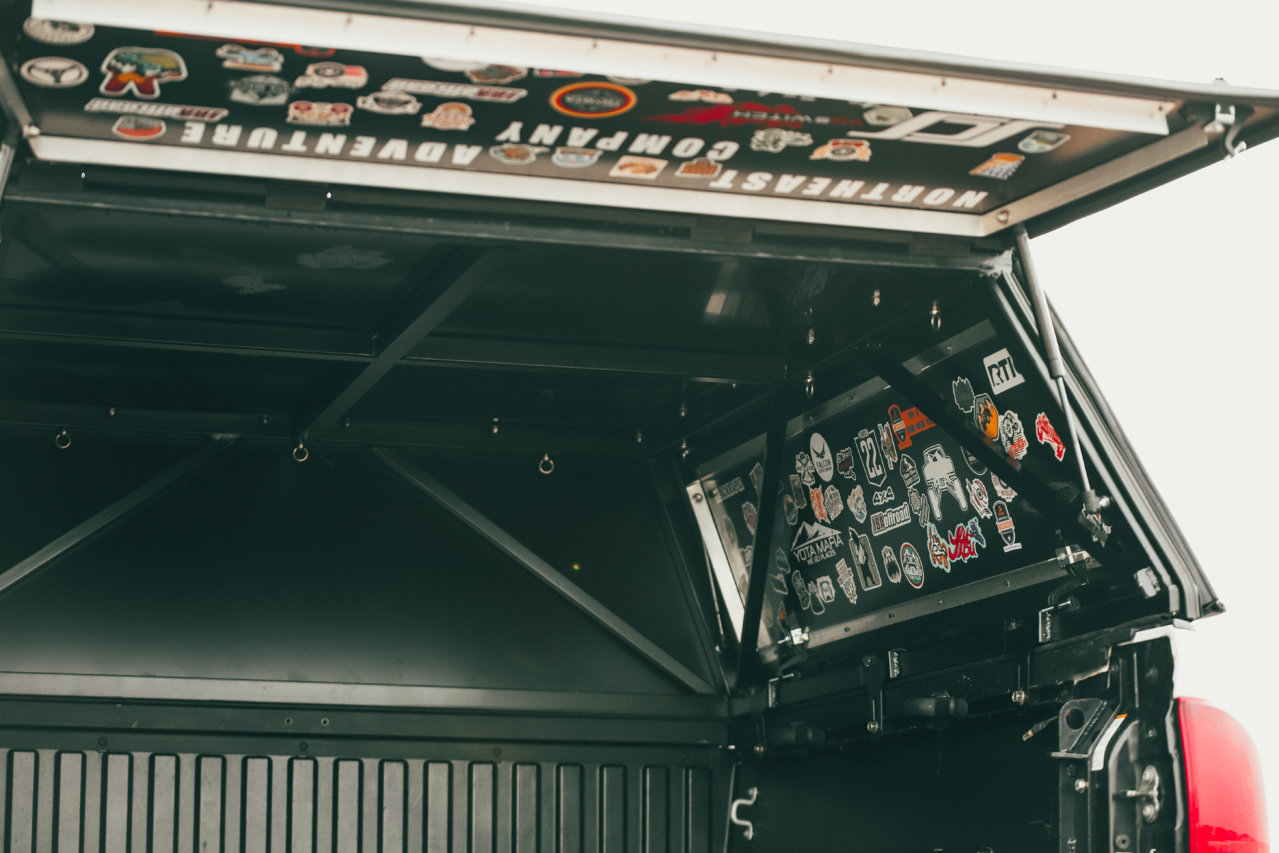

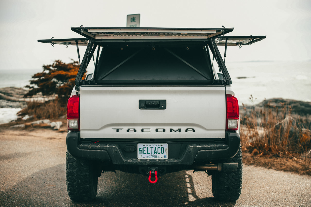

    6112 #700/5160 w/ Wheeler’s AAL RCI Skids Front to back RCI sliders SSO Slimline (Hi-clearance soon) Sungtop Various other crap

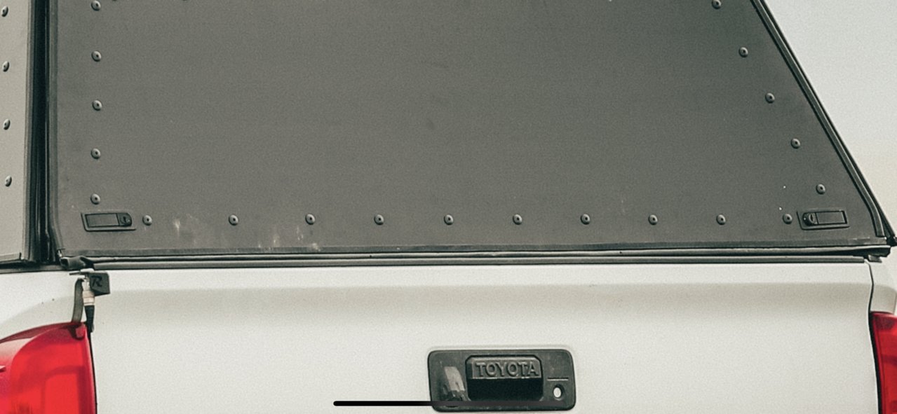

    any chance you have any closer up photos for how your rear door seals with the tailgate? I think mine is currently going to be a little short
  5. Mar 2, 2021 at 2:00 PM
    #1385
    vitodaniel
    vitodaniel Well-Known Member
    Nov 27, 2018
    #273969
    82
    Vito
    Southern NH
    2016 Toyota Tacoma TRD Sport

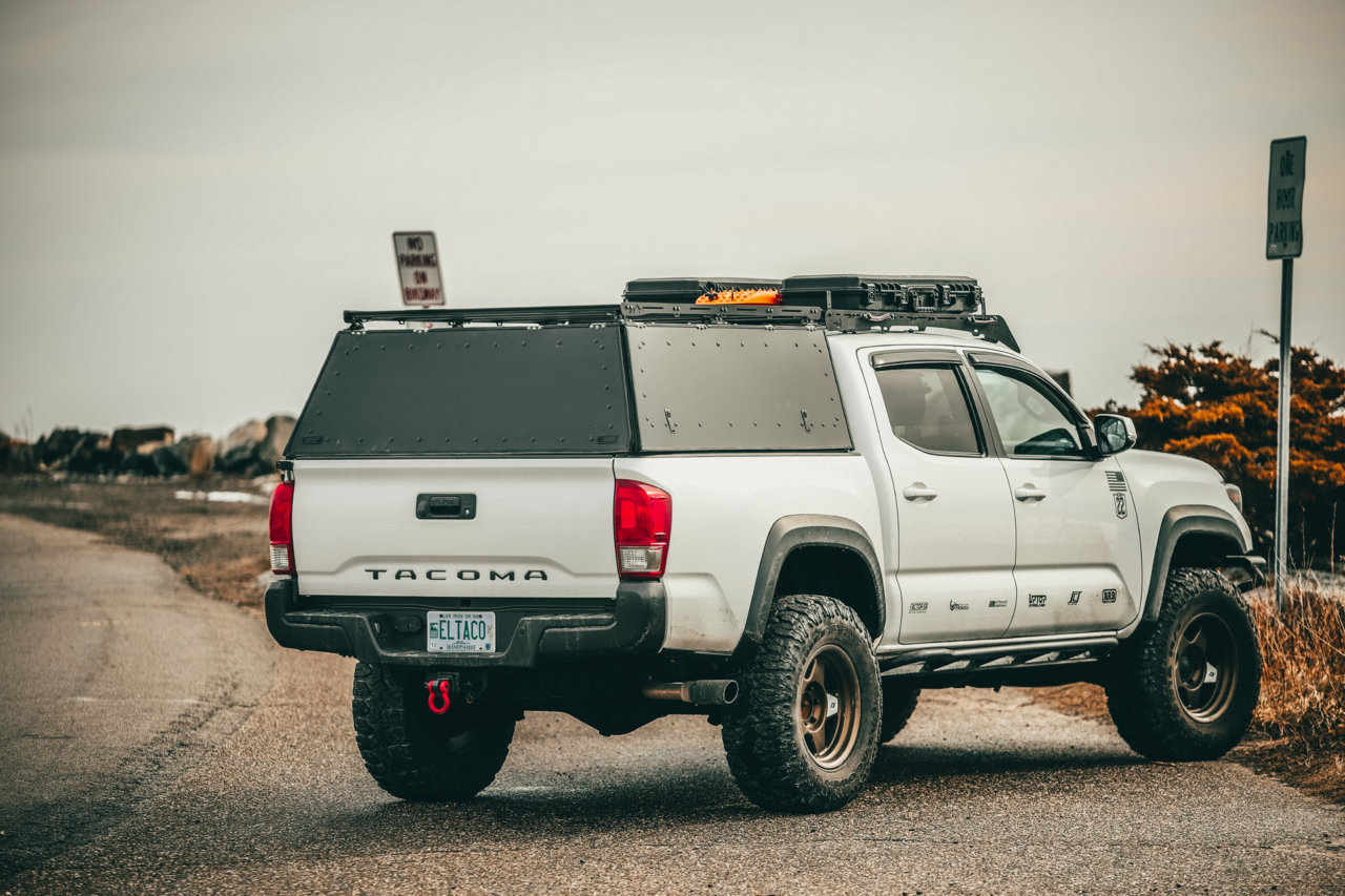

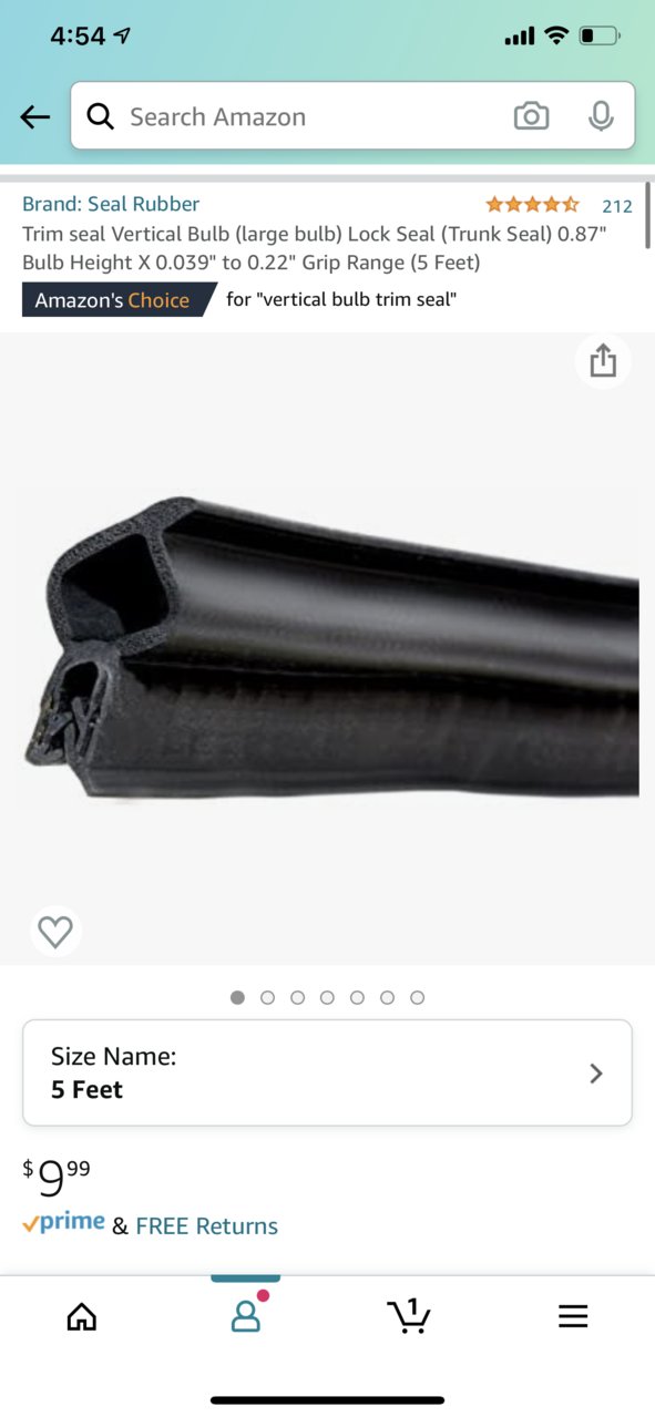

    Hope this helps. There are small gaps on the sides, but I don’t care much. Below is the seal I used, it was a perfect size. Also I am able to open and close the tailgate without having to open the hatch.
  6. Mar 2, 2021 at 2:06 PM
    #1386
    bfaris1
    bfaris1 Well-Known Member
    Jan 23, 2018
    #242143
    286
    Brian
    2018 White TRD OR
    exactly what i was hoping for thanks!
