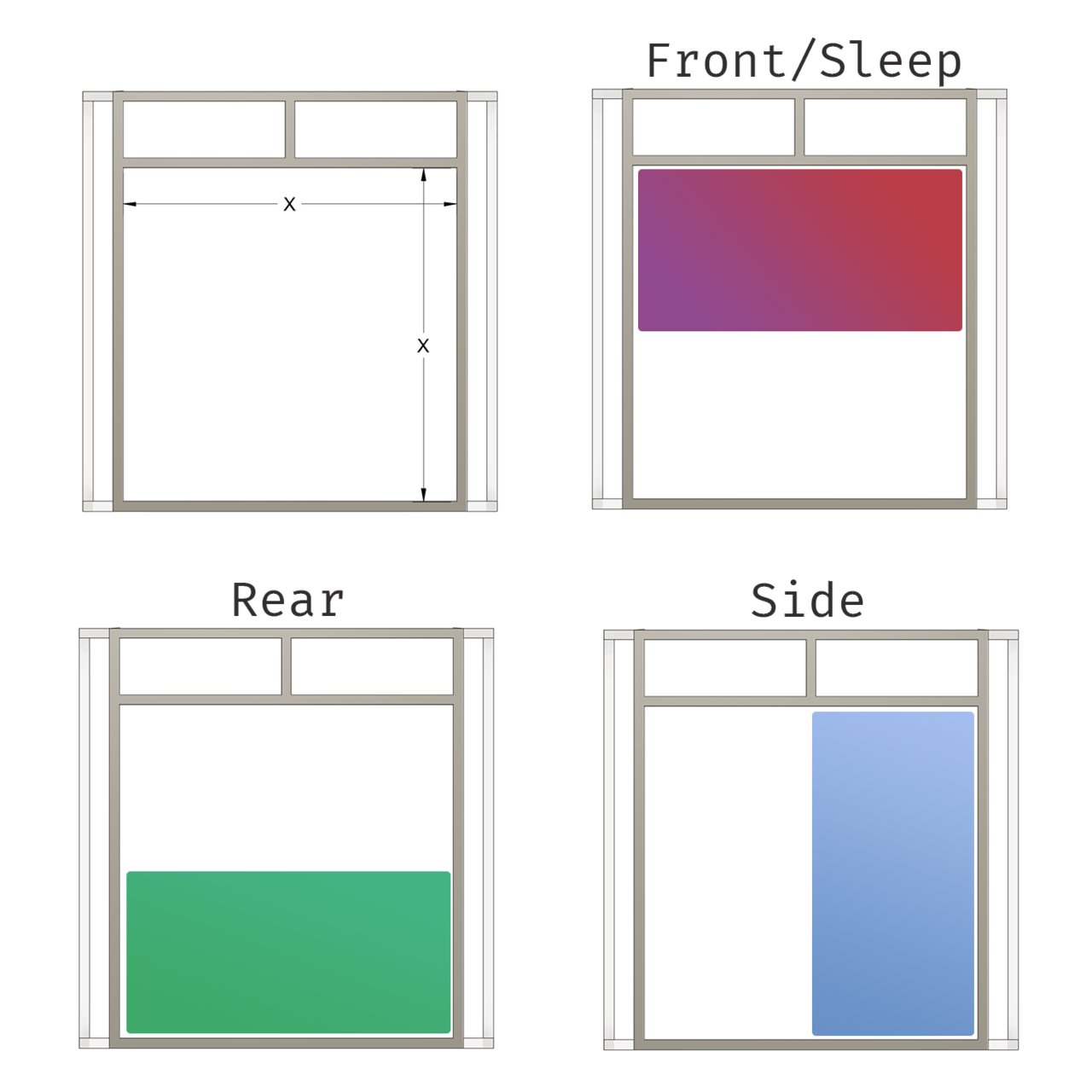

  2. Mar 3, 2021 at 7:03 PM

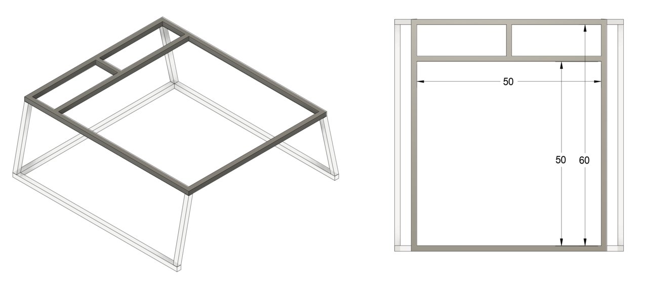

    Hey y'all. I'm planning to make a removable floor panel that, when removed, basically leaves the entire bed (short bed) of my truck open to the tent for bad weather hangout times. One slight concern I have is that this removes a ton of the regular floor panel, which I imagine will impact the stiffness to the wedge itself. It also will remove the center cross support of the space frame. In a long bed I wouldn't be as concerned since less of the wedge remains unsupported, but since a fair bit of mine will be hanging over the cab, I'm wondering if I'm going to have a problem with deflection.
    Any thoughts here? Has anyone with a 5ft bed truck done this? Thanks as always!

    I'm taking a somewhat similar approach, so I can let you know if it breaks. I'm confident that it will be alright, especially since I don't plan on doing any hardcore wheeling.
    I'm leaving a square hole (X by X) in mine with a rectangular floor panel (X by X/2). This panel will sit on some welded-on angle iron that will run the perimeter of the hole.
    When I sleep, I'll put the panel at the front, leaving an egress (or I-need-to-pee) hole at the back. When hanging out, eating, or maybe even working I can position the panel on the side or at the rear, making it an impromptu table/desk.
    (Edited to remove poorly formatted pictures)

    Nice! Yeah that makes perfect sense to me, a bit similar to what GFC does but with the full-time exit hatch and without the complication of three removable panels.
    It looks like you're leaving a cross support in the spaceframe about about 12in or so from the cab end, is that correct? So I assume the permanent tent floor will extend to there? I'm hoping to have the full bed of the truck open when the panel is removed, which basically means I can't have a cross support on the space frame. Hoping to get it welded up this weekend so we'll see how sturdy it seems without it...
