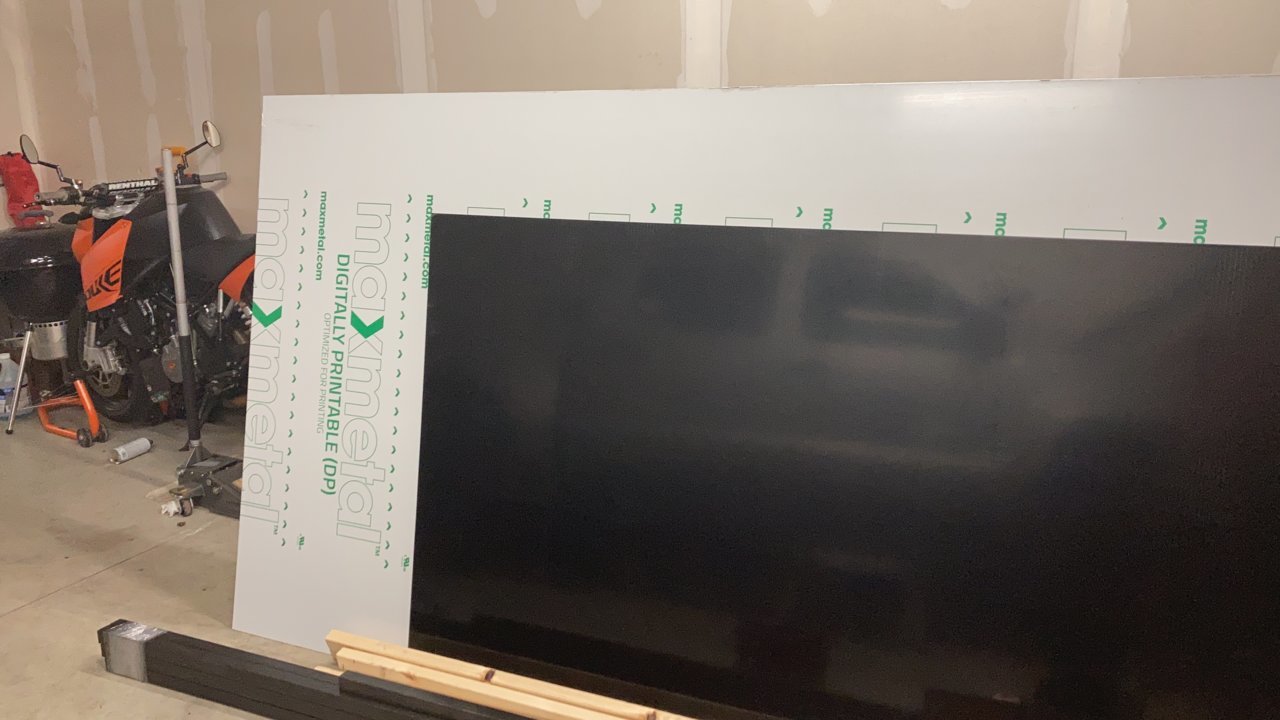

    I finally got my panels and I would like to share how, in case someone gets the same issue.
    basically Grimco told me when they declined my request, that I could call them and they would give me the contacts of their Lokal customers. I ended up calling a Sign-A-Rama and the woman was willing to order them for me. She just charged me their purchase price +tax. So I left her a 20$ tip for the effort and picked up the panels the next day.

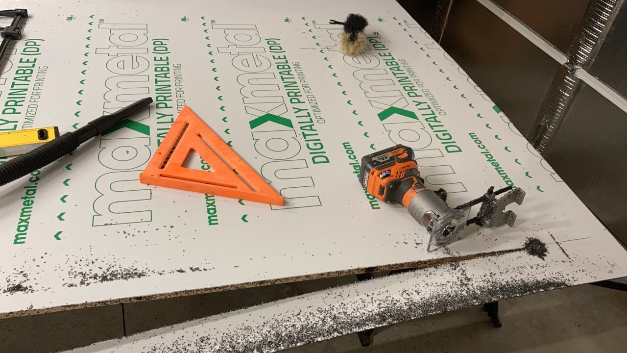

    I found one shop who would do it for 75$ one panel. But my biggest issue is to get the panels transported to them.
    so I ended up borrowing a router and cut them out myself and it works much better then I anticipated.

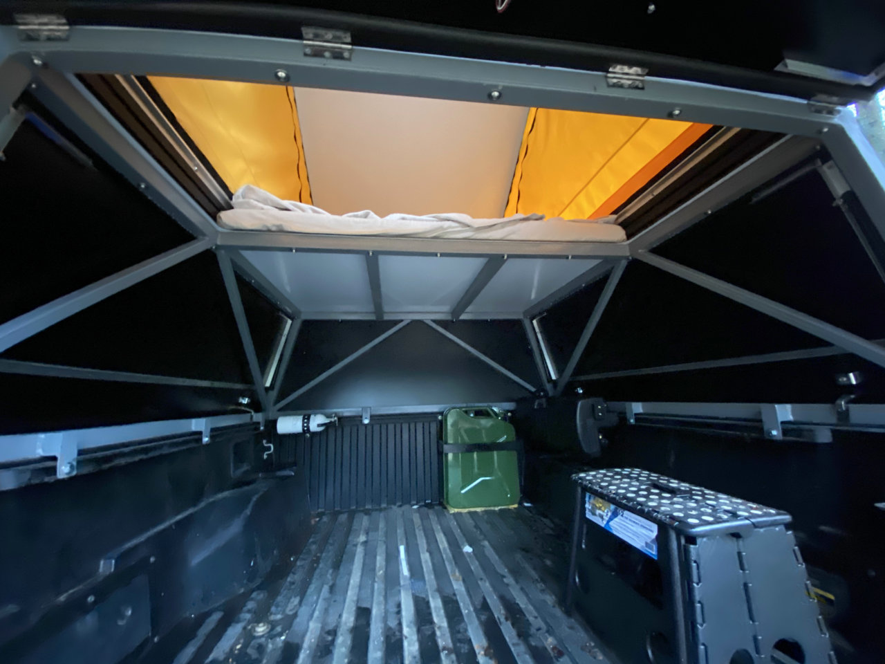

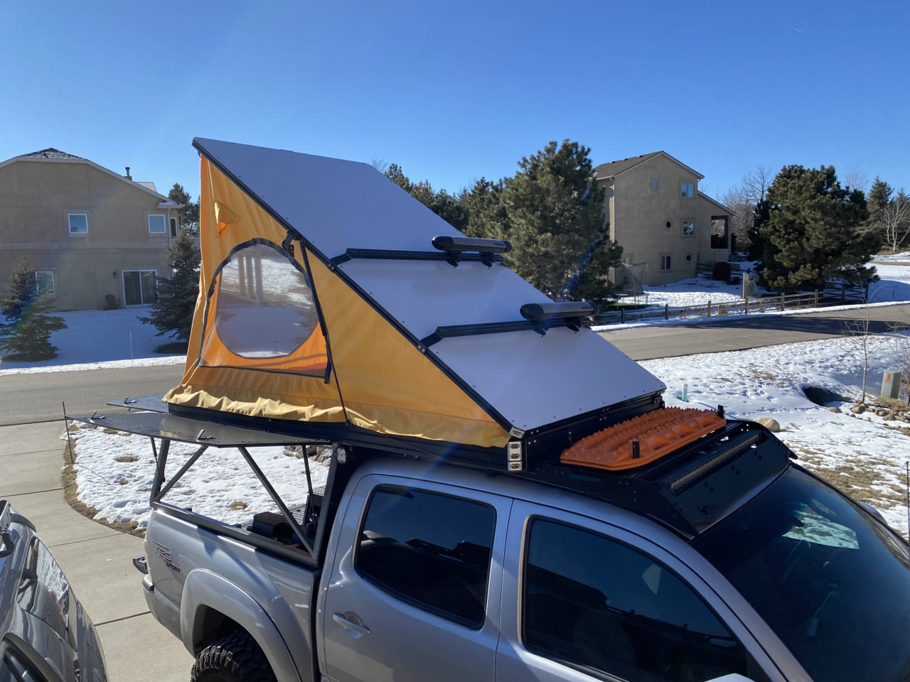

    King 2.5 /TC UCA 33" Falken MT 16" SCS Ray 10 DIY Wedge Camper
    Here are a few pictures of my finished camper. Beginning to end took 21 days to complete. I've spent a few nights in it so far and I'm pretty happy with it.

    I’m going easy mode :D. Cut out test panels today and they all fit perfectly
