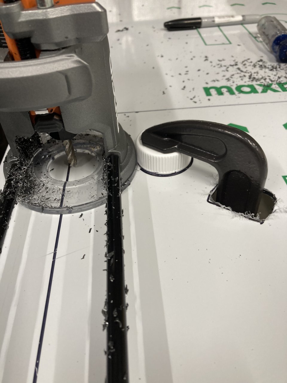

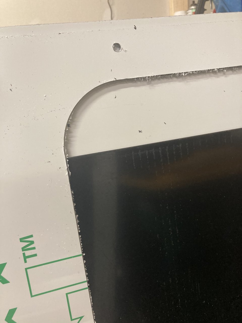

    Update on the cut out with a router and how to get the radius cut.

    Whats the purpose of rounding it? About to cut mine and was just thinking about straight.

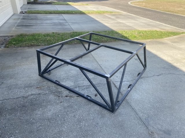

    is the .065 wall thickness equivalent to 14ga square tubing? Calling around to my metal shops and they can only get 14 gauge in 1.5" square tubing

    Makes since. Are you running 40" of overhang?

    I think you want 16 gauge square tubing
    https://www.atc-mechanical.com/tube-pipe-101/tube-pipe-size-overview/
    I bought my steel from Metal Supermarkets and they listed it as 1.5x1.5x.065

    welding done. Now I can paint it and hide my shame.

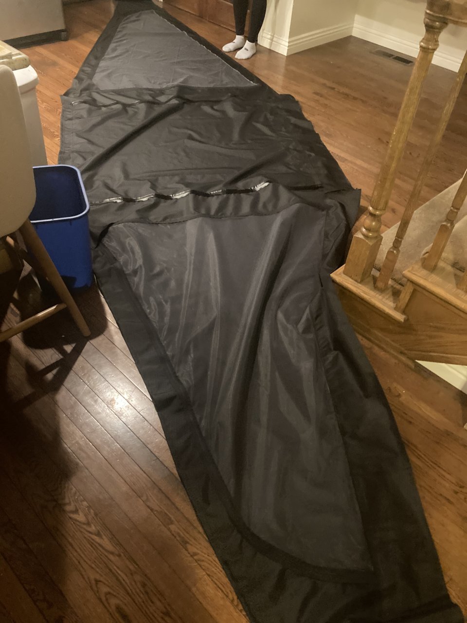

    Turning out pretty good having never touched a sewing machine before this.
    Super excited to almost be “done” with this project

    I like those windows!

    that tent looks pretty sweet. Does the bug netting zip off as well?

    thanks! Was trying to avoid as many curves as possible and have big openings. Should be good.
    thanks! The zip down like the doors but not completely off
