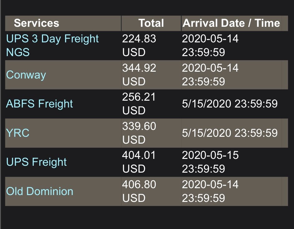

  16. Mar 19, 2021 at 7:23 AM
    #1536
    Taco Camper
    Taco Camper Well-Known Member
    Aug 19, 2020
    #338162
    83
    I just found the shipping options they quoted, May 2020 (mfg. ship direct to my house, Phoenix AZ). Correction I did use UPS freight.
