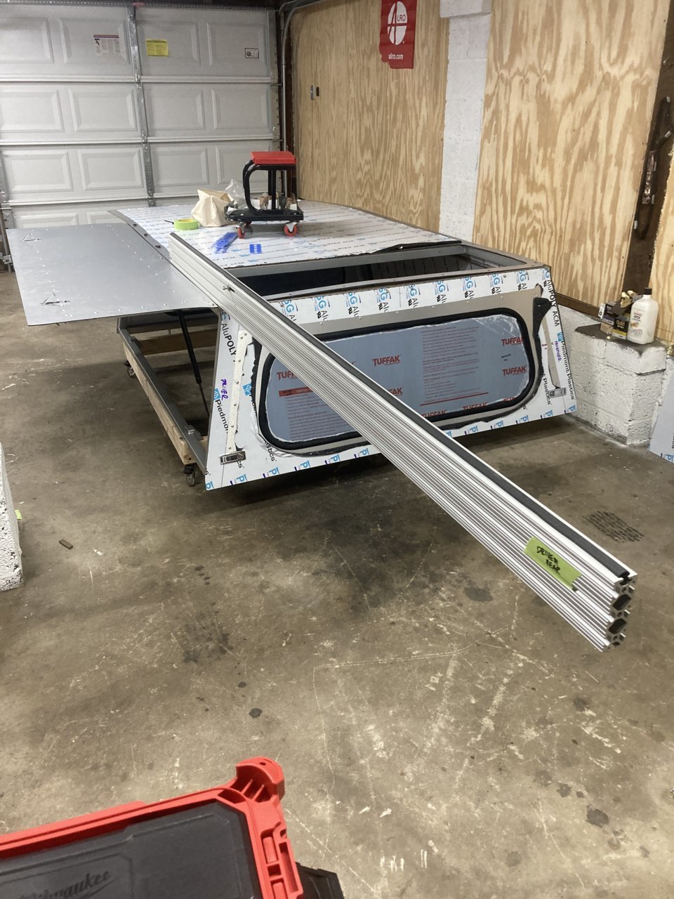

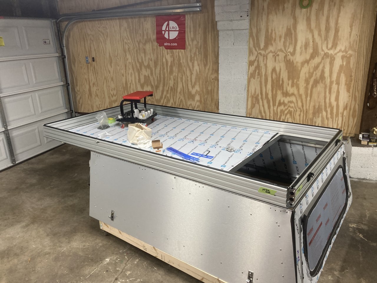

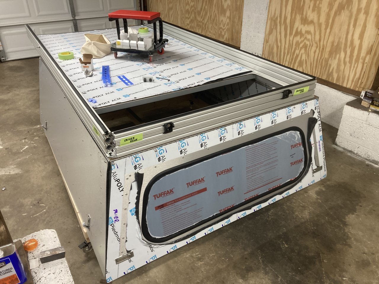

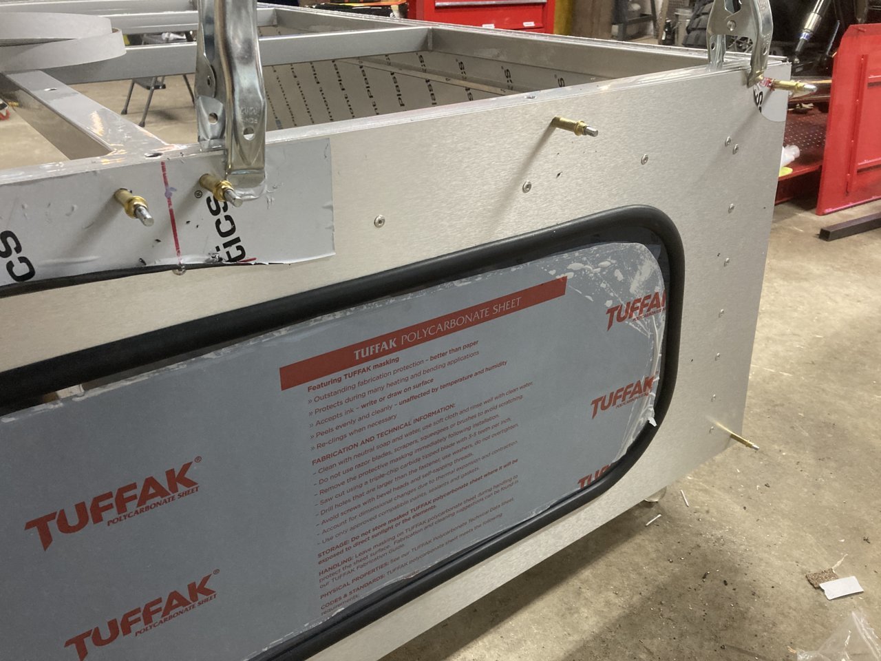

    Updates:
    I got the frame back from powder coat, it's a shade darker than I would have liked, but I didn't spend any time talking to the guy about it in the beginning. He said, "Silver?" I said,"Yeah" that was the end of it. Ultimately I'm real happy with it. I reattached the side and rear panels with the flush mount rivets, and put a bead of silicone behind the hinge leaf that contacts the space frame. I Mounted the front Bulkhead panel. I drilled through the panel and the space frame at the same time. There was no cracking or splitting in the powder coat as somebody mentioned in the paint vs. Powder conversation. I used Clecos to mock up the bulkhead panel. I've been using them for this project the whole time, just haven't posted photos of them. If you don't have some/know about them, I'd highly recommend them. I know I saw somebody else in this thread using them. Super easy and clean. I siliconed the panel in place for final mounting rather than have it offset the thickness of the cork rubber gasket... time will tell.
    The Final Assembly of the extrusion to the space frame is done too. I assembled it right side up, no problem. I inserted the bolts with washers into the holes, threaded the slot nuts on with only a thread or two, and taped the head of the bolt to the underside of the space frame, so that the slot nuts were sticking up. (use the real deal masking tape) I had to rest the end of the 100" pieces on a toolbox that was approximately the same height as the camper, just to get the first slot nut in the channel (and because i'm building all this by myself) but after I got the first one or two slot nuts in the channel it was pretty easy. I put a thin bead of silicone on the floor before I slid each extrusion into place. Mostly the extrusion pushed the silicone all the way to the end, but it left a tidy little bead on the outside corner between the floor and the extrusion. The whole process of putting the extrusions in place took maybe an hour and a half. There was a little more friction than I expected and having the ball stud still in the channel from the gas shocks gave me a little handle to pull on during the last few slot nuts. F*%C#King with threading bolts into slot nuts in the channel is one of the most maddening things about this process, I can't imagine trying to do the assembly upside down. I didn't even have to cry once, like that one dude said...

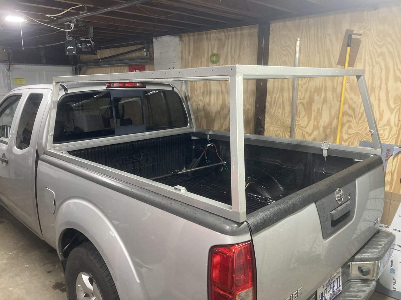

    What size square tube did you use for the mounts to the bed?

    That is leftover from a previous project. 2" square tube, .125" Wall. I hope it holds :fingerscrossed:
