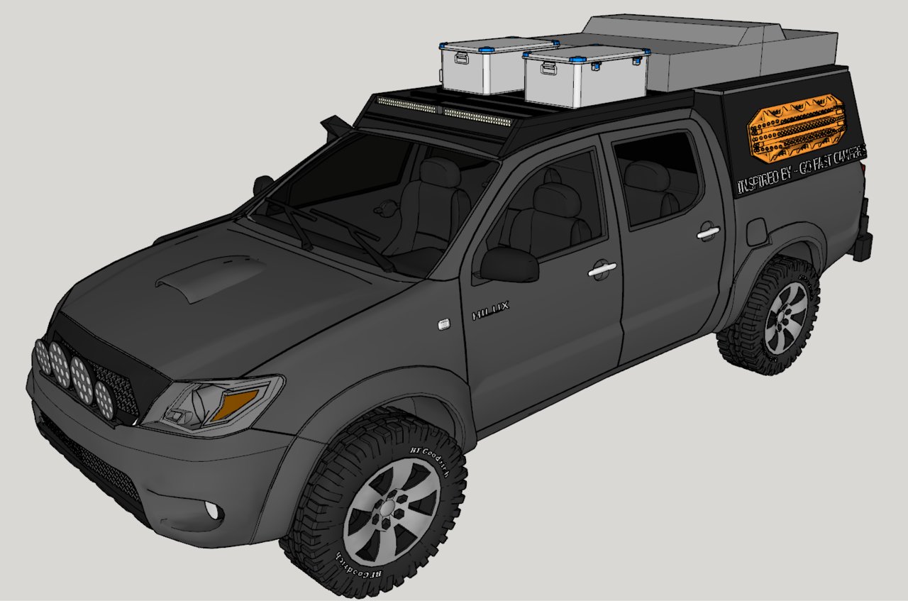

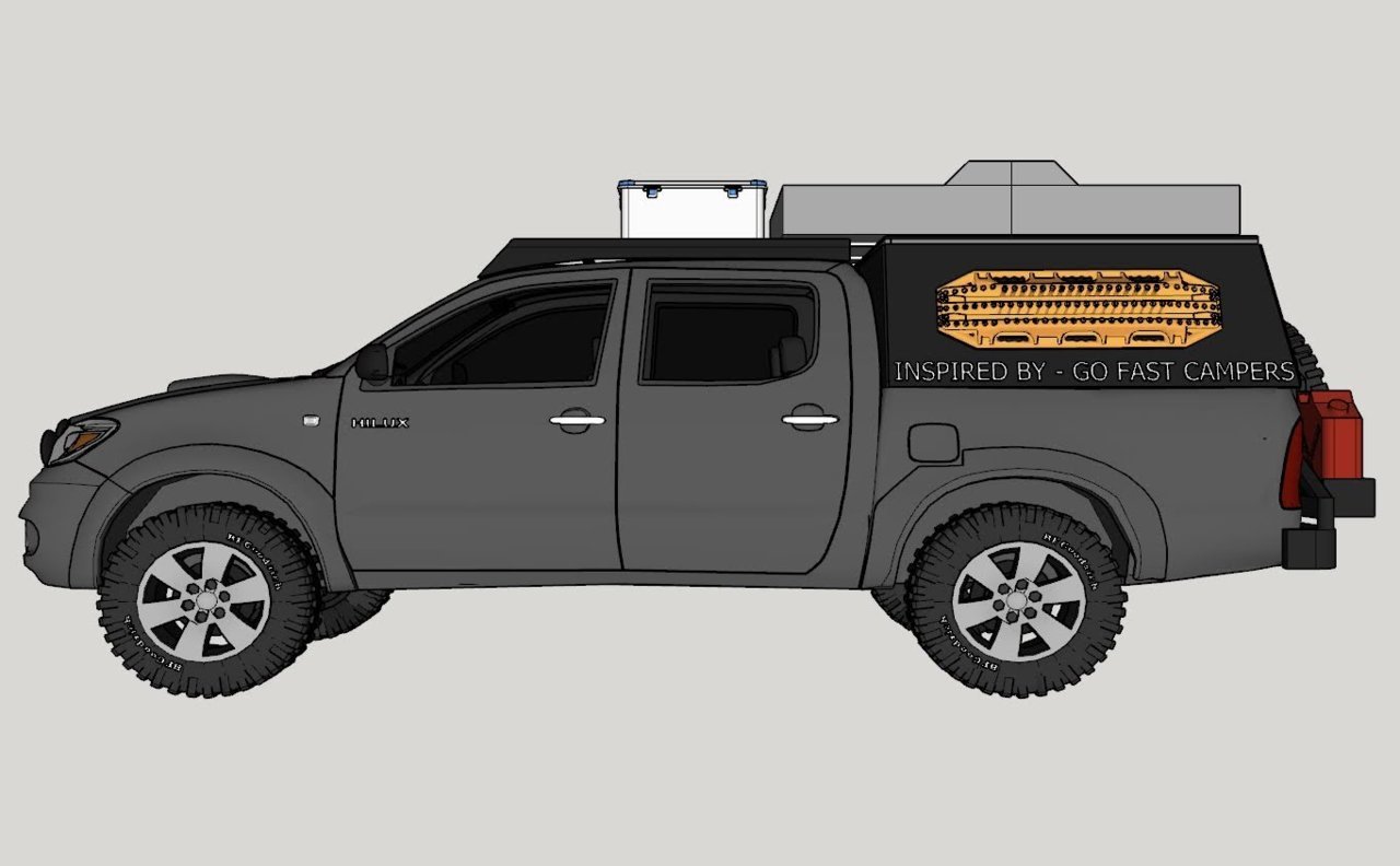

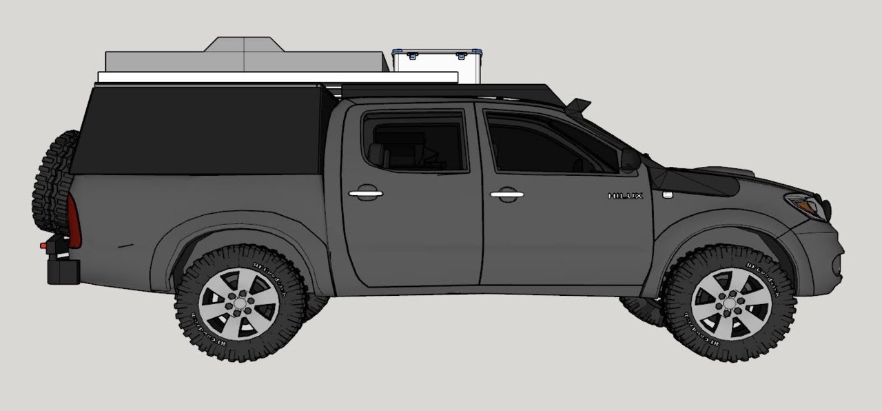

    Thanks for clarifying that Jim!
    I will have to measure that and see how it will fit on the Hilux.
    Do you know the reason for why its done like this? I reckon GFC has done the same, but for what purpose I wonder?

    I think it is to follow the line of the cab better. You could copy the same slope from the front to the back if you wanted to keep it looking symmetrical but it likely doesn't matter much. Mine is (in drawing form) the same offset (2") to keep my material sizes the same for easy of fabrication.

    You may be right there, the more i look at it the more i like the slope design. Almost all canopy mounts for the Hilux is pretty much dead square which is quite boring and the reason i have not bought one yet.
    Jim's and GFC's design really sticks out! Me likey!:drool:

    where did you get the maxtrax and hilux models?! they look awesome!
