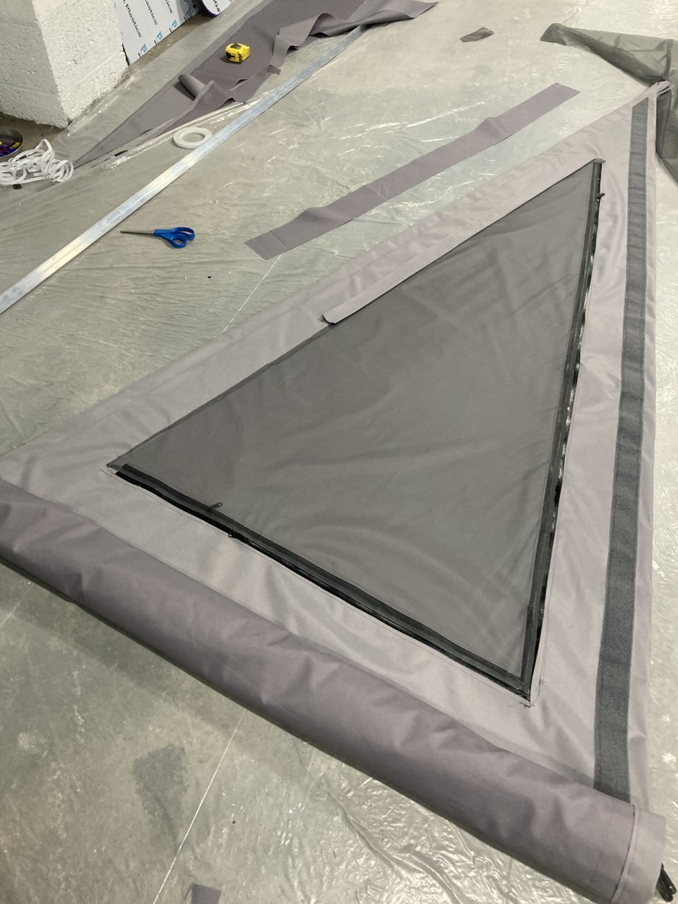

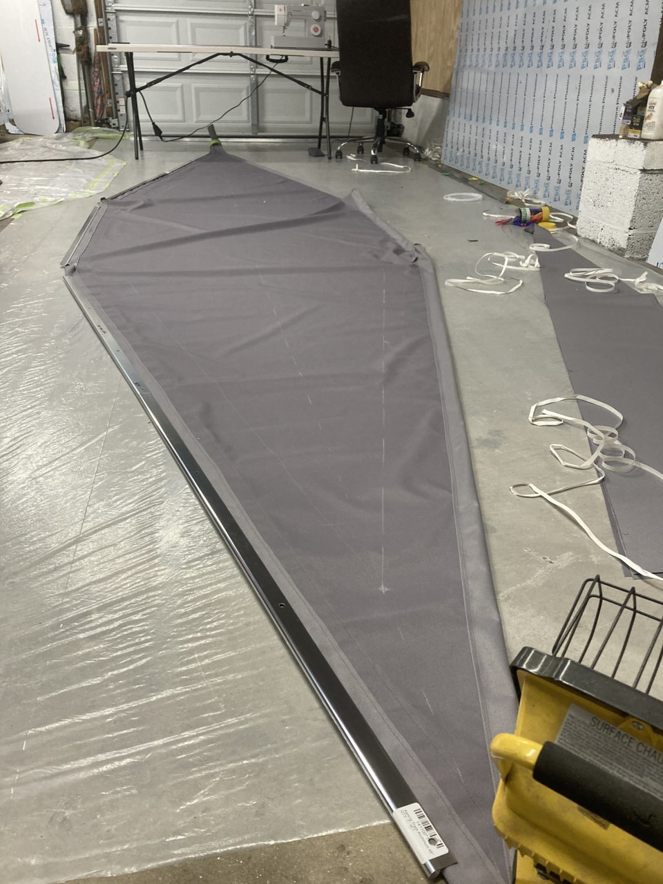

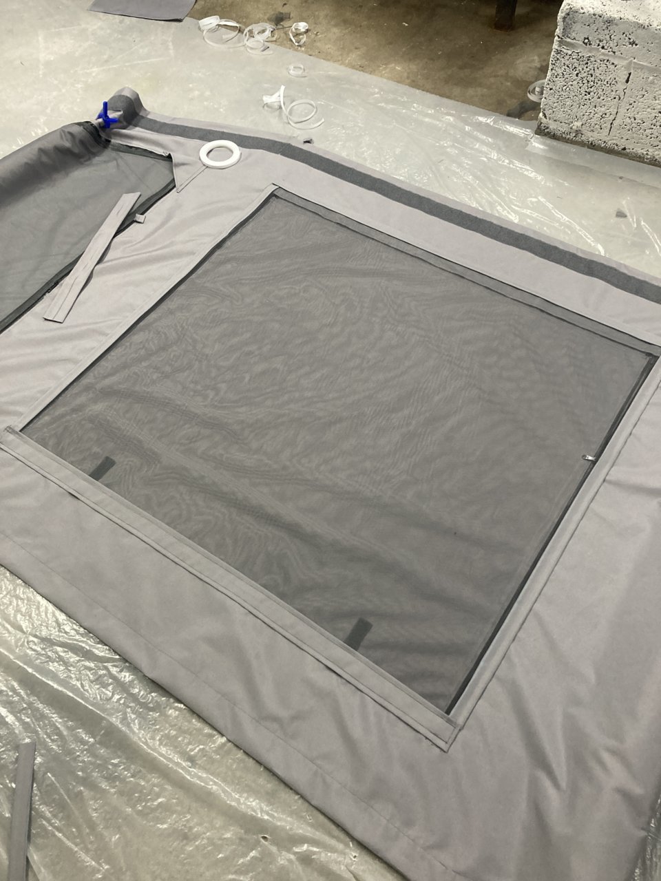

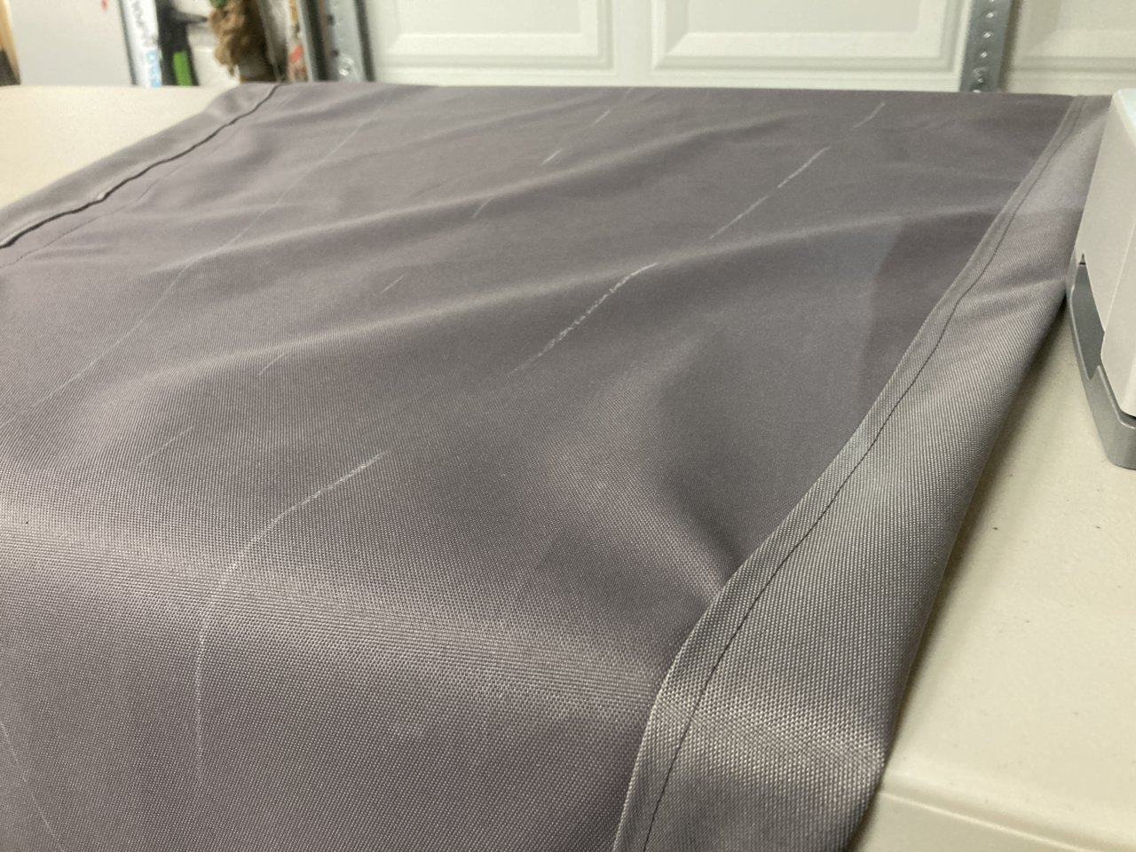

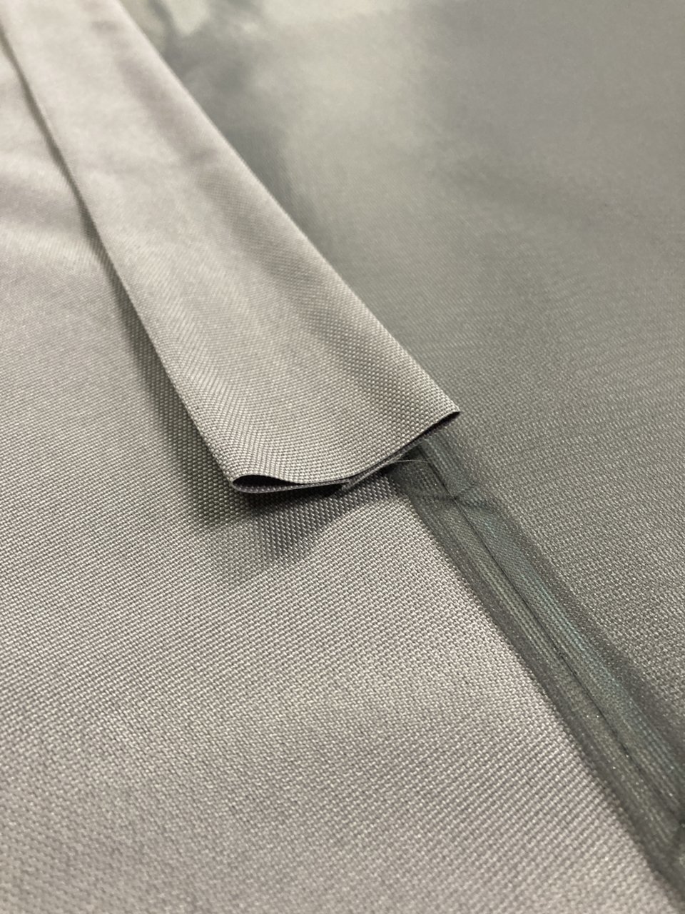

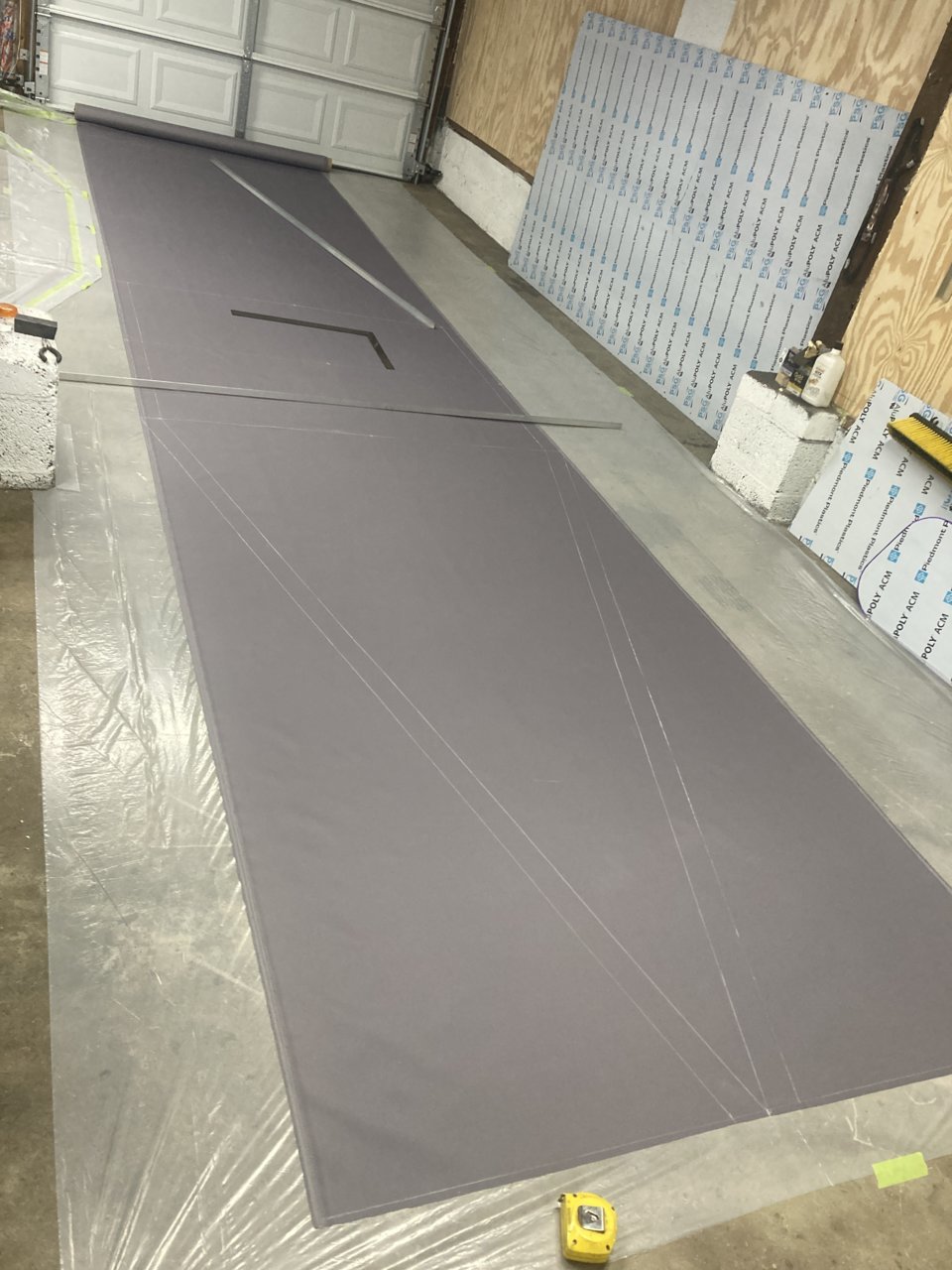

    I'm well into the sewing portion. I'm going to attempt to write/explain what I did, and then post the photos below. I laid out painters plastic on the floor to protect the fabric, also since the basement garage is the only suitable place for a project this size. I sewed in 2" velcro, about an inch lower than where the hem for the keder rail is, I did this first because of how the stitches had to go in, and so that I wouldn't make the "tube" that the keder cord slips into, too short. (The Velcro, is so that I can attach/Remove a big awning/rainfly later) After the Velcro, I sewed in the hem for the Keder Cord all the way around, And did a test fit on the camper. NOTE: I hate threading bolts into slot nuts and so I pre-threaded the slot nuts onto the bolts through the keder rail, took off the end of the roof frame and slid the keder rail, with the tent canvas attached, into the frame. Super simple, not much trouble at all. The bottom portion isn't a pain, because it sits vertical. I left the frame in place on the bottom. I took it back down pulled the Cord, and the rail, and started on the windows. The Triangle windows utilize a double zipper, which is just two lengths of the uretek coated zipper stitched together, the corners at the top are, as best I can describe mitered together. I'll have to put metal zipper stops in soon, to keep the zipper pulls from coming off the end of the inside corners. (Sailrite sells them). This double zipper yields a real tidy appearance and I can open the tent wall, to reveal bug mesh or the whole side right from the same spot.
    I have taken to sewing binding to border the windows. There are some SailRite Videos about binding and how to work with it. Basically it's just double hemmed strips that help strengthen and secure the edges of things. I chose to do this for strength and for aesthetics. The Middle rectangular window has straight zippered sides and the top of the flap is lengthened with a piece of 2" binding, utilizing 1" velcro on the inside of the flap side and the inside of the tent. Basically you pull the velcro flap and pull the zippers straight down to open the window, the bug mesh is fixed here and does not unzip. (couldn't figure out a more elegant solution) the bug mesh seams are bound with 1" binding, and the top of the window is shielded by a 4" Storm Flap, since there are some tiny gaps left exposed where the zippers meet the top edge of the window around the binding/Velcro.
    I still have to finish the passenger side triangular window, and make/sew in the rain skirts. Turns out, I kinda Dig Patterning and Sewing giant things. More to follow...
    IMG_3870.jpg IMG_3872.jpg IMG_3871.jpg IMG_3874.jpg IMG_3876.jpg IMG_3877.jpg IMG_3878.jpg

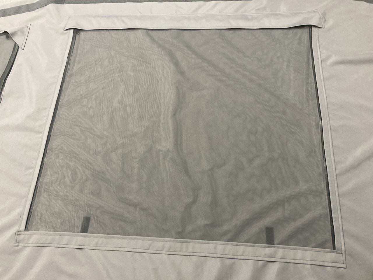

    ^With such a thin material, like the bug mesh, The binding helps pinch it down and cleans up the appearance. At least thats how I see it.
    In the Photo Below the Binding helps secure the velcro strips for securing the window flaps in the rolled down position.

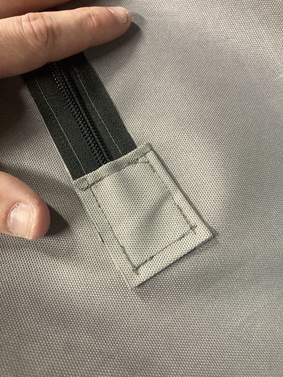

    ^ These little Patches are pieces of 2" Binding, that are stitched on the inside of the wall, at the bottom of the zippers to tidy up the
    ends and to act as a foolproof zipper stop. They are in the same position as the binding strips on the bottom of the outside of the wall,
    so that the rectangle stitch pattern isn't visible. These just have to go in first, so that the outside binding covers the stitches.

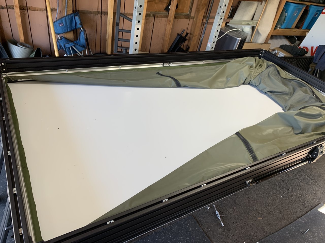

    Alright, as my build will hopefully be finished in about 4-5 days here are my main tips/changes from the main diy post (that I don’t recall seeing throughout the thread) for anyone in the process or about to start.
    1. Order extra boxes of 5/16 -18 3/4 and 1/2 socket caps. I ended up being short and had to run to Home Depot on some last minute trips.
    2. spend the extra 100/200 on the full size slot nuts. The extra cost in my opinion is worth it for additional strength in your camper and ease of use. The leaf spring style slot nuts for tnutz I found to be especially helpful because you can actually drop them in as well by pushing them in sideways. The hold their place very well also.
    3. Put the tent in before you seal the roof and floor. I found it to be much easier to access every slot but with room to work. I had no trouble sealing the roof and floor with the tent in place as long as you tie your bungee cord around the canvas so it all stays in place.
    4. Buy yourself a nice set of t handle or offset handle hex wrenches they are worth their weight in gold in this project.

    tent stays tucked in very nicely
