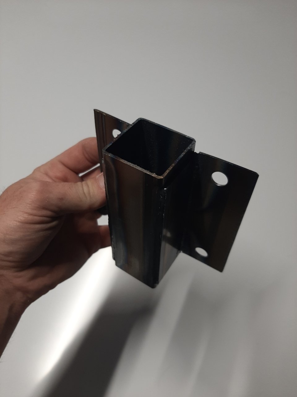

    Did work on my other idea of 4 vertical pieces attaced to the roof then have them go through receivers attached to the frame. Here is 45 minutes for 4 pieces. Tomorrow Ill pick up some vertical pieces after work.
