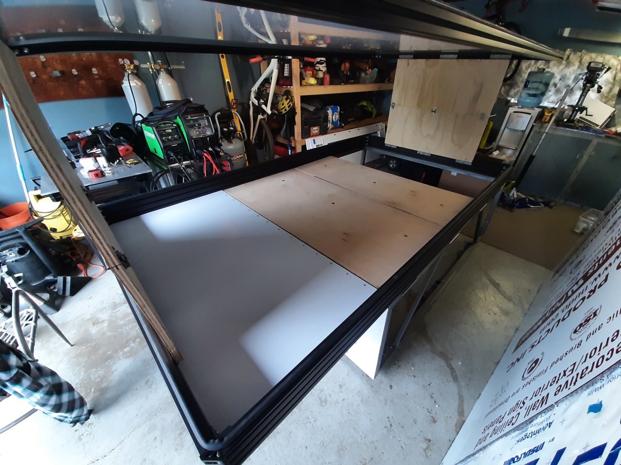

    I'm currently attempting the same style as you are with the full pop up vs wedge. Put 1515 cross bars on the roof for extra support. Have the struts for lift, just trying to narrow down the mechanics for the support. Been researching for the last few weeks and have come up with basically the same thing you have, just trying to land on a solid idea/design. Good luck and keep us posted!
