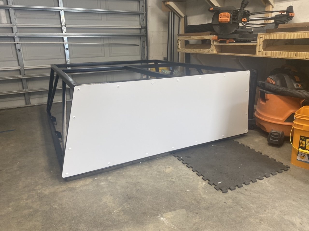

    @Ripcord Amazing stuff! This post inspired me to pull the trigger on long-awaited purchase. Just bought '15 Tacoma and looking to get this build before end of this year.
    Quick question: Why did you not go with the punched square tube? Thought it helped reduce weight (or may be not if wall thickness is larger) and gives modular storage solutions.

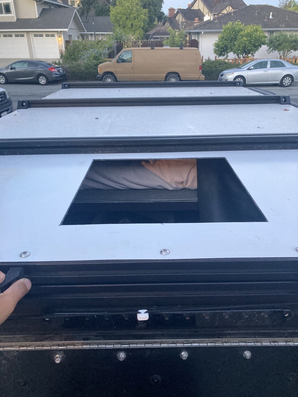

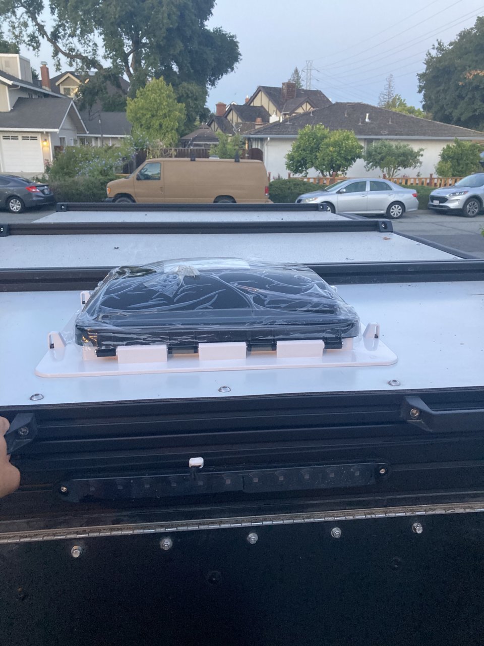

    please Keep us posted on this!
    Cutting a hole in the roof for a fan today but if this ends up being effective might do both!

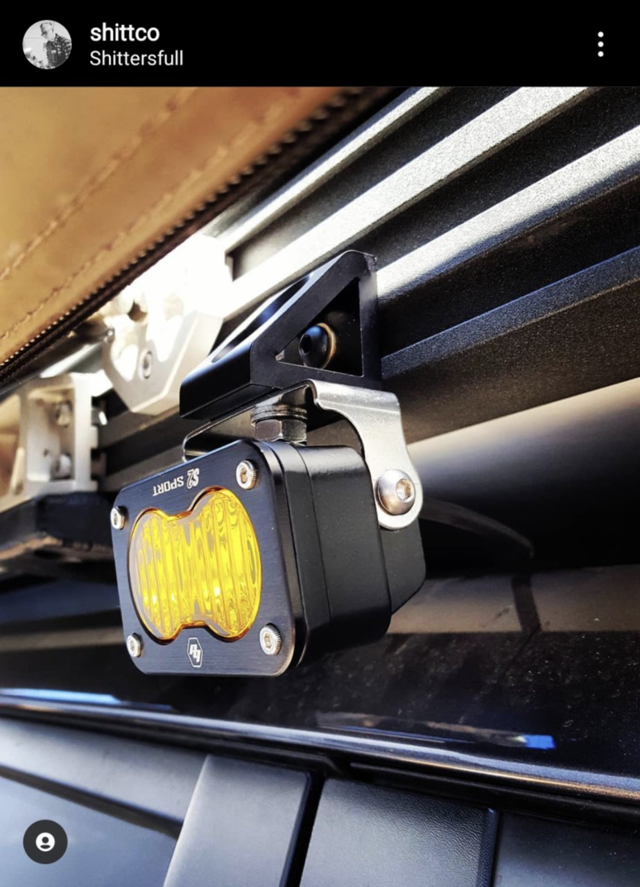

    For anyone looking for a good way to mount lights...

    Not sure what felt worse...
    drilling a hole in the fender for a snorkel or cutting a 14x14” hole in the roof Lol.
    Should fix all the condensation issues, hopefully.
