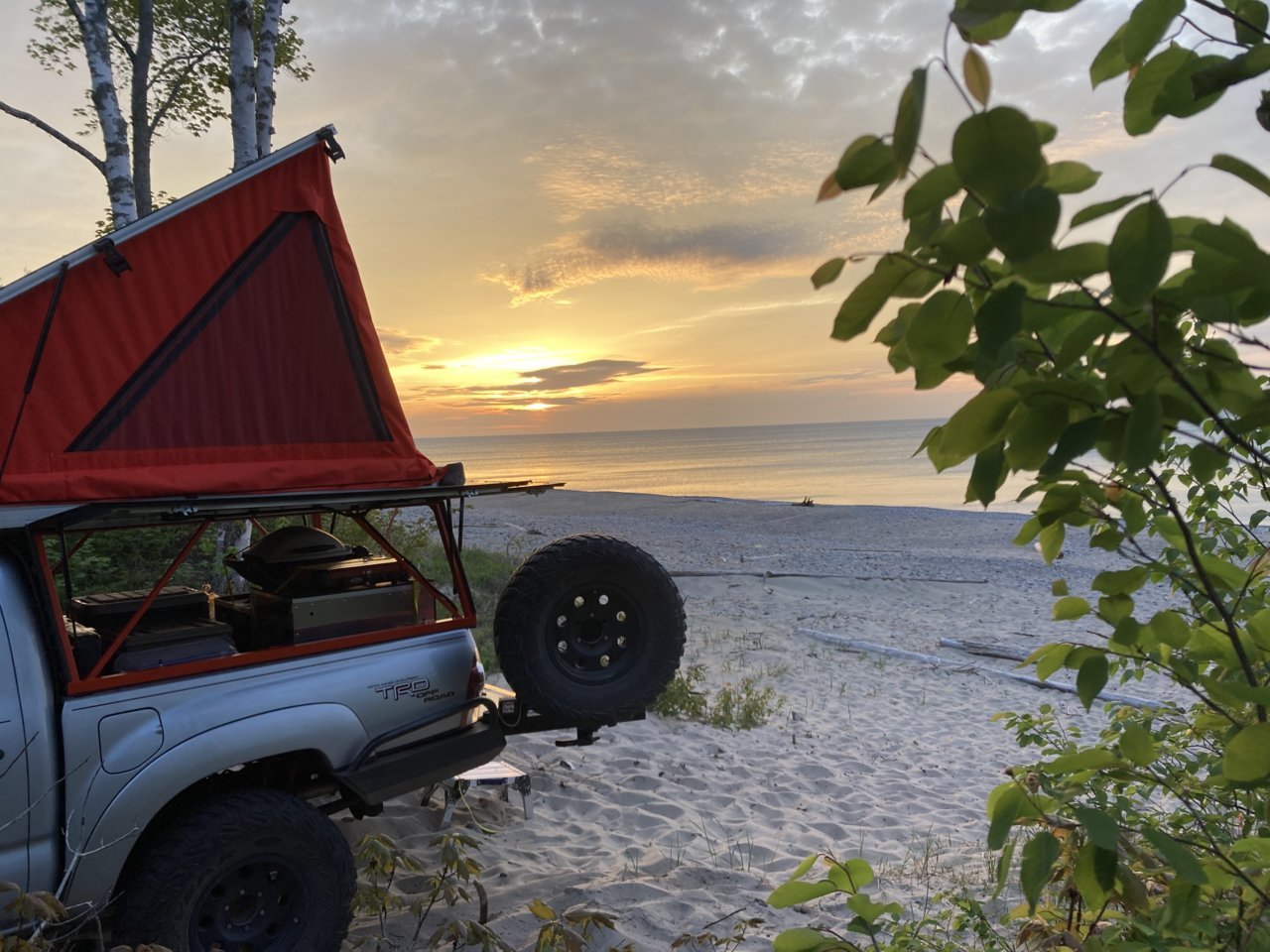

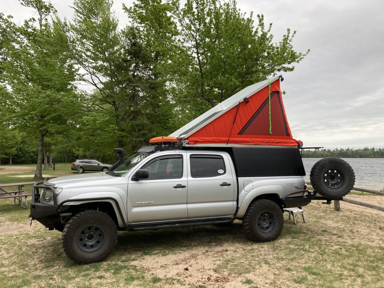

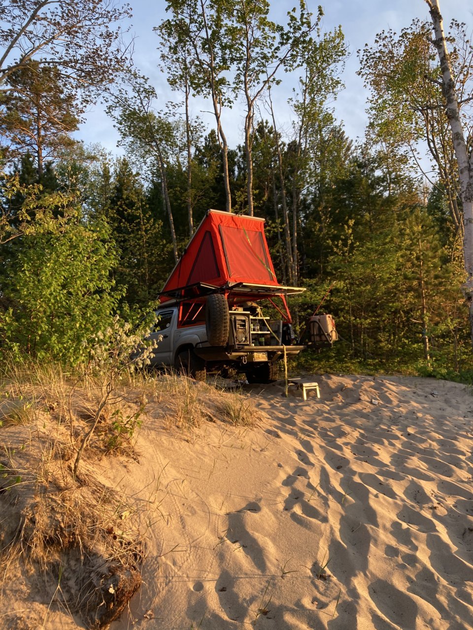

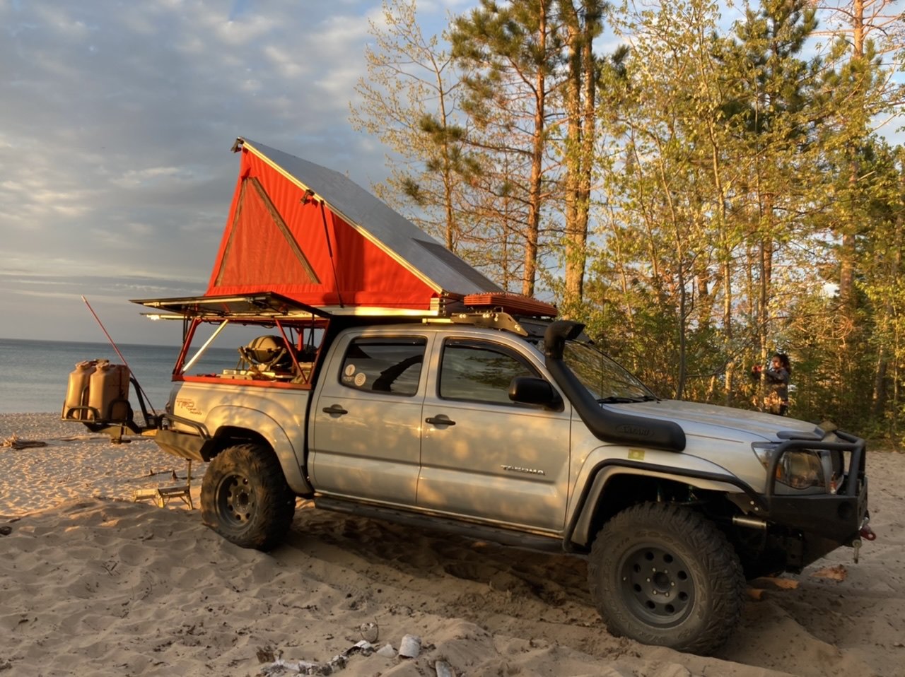

    I also finally got mine finished. Here some pictures from Lake Superior.
    things to rework so far:
    1: shorten the bungee for more tension
    2: seal the seams of the tent. Not all 100%
    3: get a solution for getting the piano hinges water restistance.1F52C2CF-A481-49F3-8026-C215F0AE0802.jpg0B45C409-0C96-475F-AF41-1E2DA414BEE2.jpg175CF251-FFBB-4243-BEC1-8C258AB62045.jpg5704FF20-AE46-41B7-A6F8-C2C1C2BC44EE.jpg

    The hinges do leak a little, but nothing terrible so far. The bulb seals seem to be doing of good job of keeping out the water. Its not a waterproof hinge so it was expected, but the holes in the hinges are smaller than the home depot hinges, so less open space = less water... at least thats how I see it.

    Awesome first campsite. I'm pretty sure I know exactly where along Lake Superior you were.

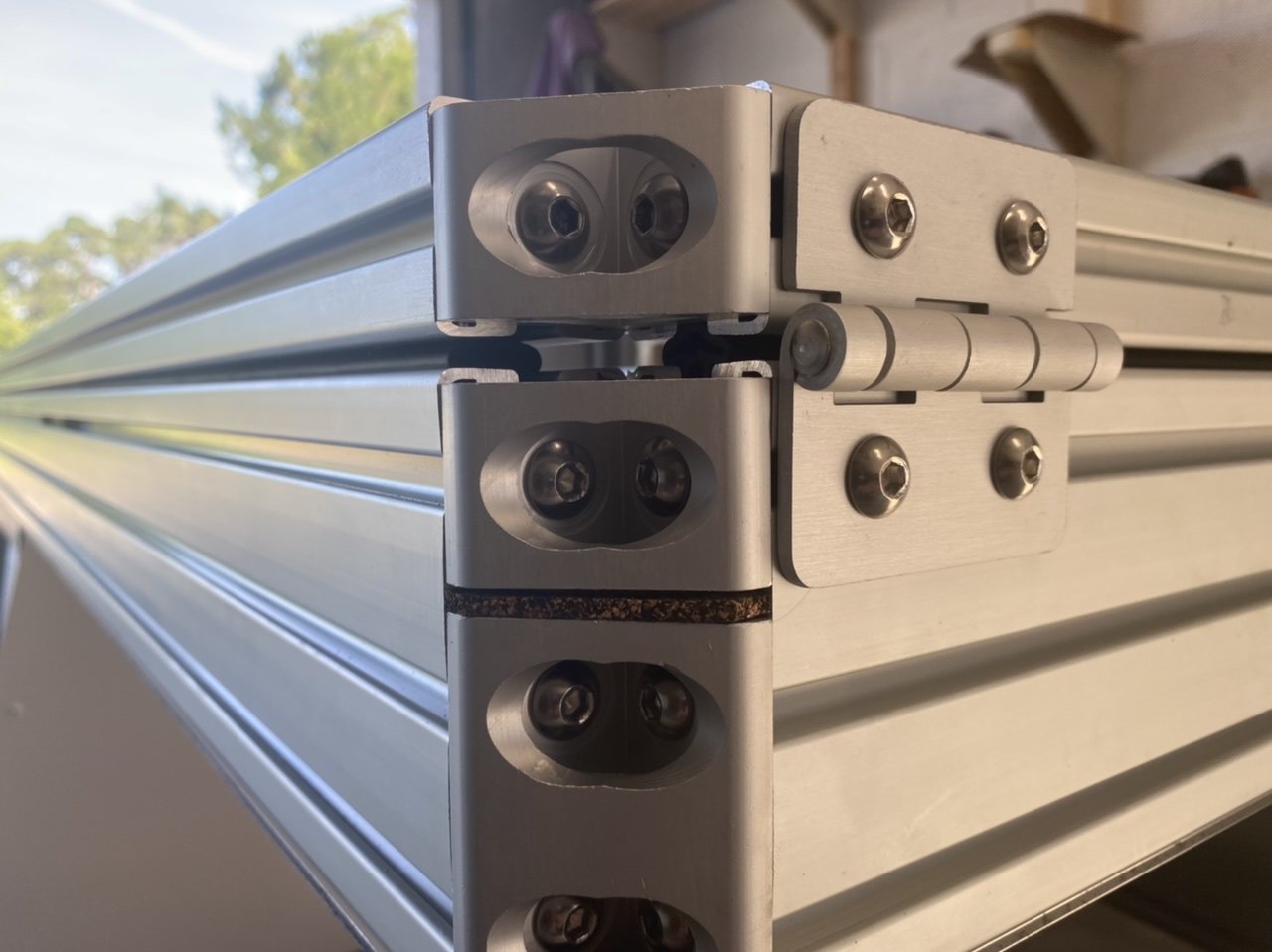

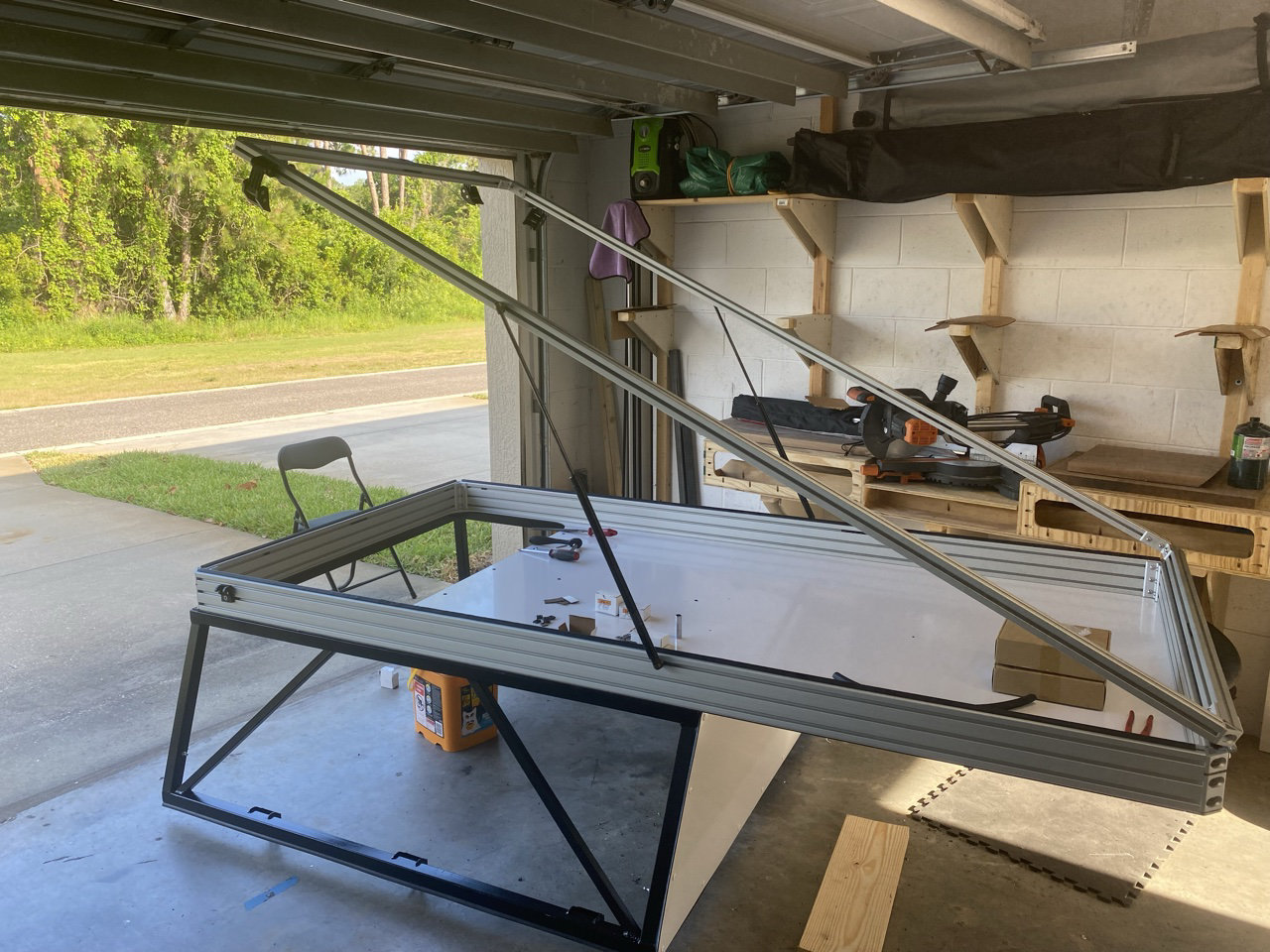

    How in the world does this get sealed?
    and I’m short a ton of extrusion nuts. Wish I had counted before I ordered my overpriced box of 5/8” button head bolts

    I seen a post earlier that someone used the bulbed seal and just trimmed a bit to run over the gap and onto the other extrusion.

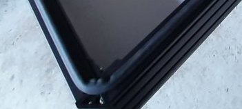

    I've been trying various things, but will probably end up buying more bulb seal and re-running it to go around the corner. Currently have the corner filled with normal adhesive bulb seal, trimmed at 45* angles. Cracks filled with caulking

    dang it.. I wish I had seen this before I did my extrusion seal. I might have enough scrap to make something for the corners and just urethane all of the joints together.

    That looks awesome. One page 2 I have a door hinge solution where you basically wrap/seal with some scrap fabric and a bit of sealant.
    https://www.tacomaworld.com/threads/composite-80-20-wedge-camper-build.681480/page-2
    M61guru and Labbi85[QUOTED] like this.

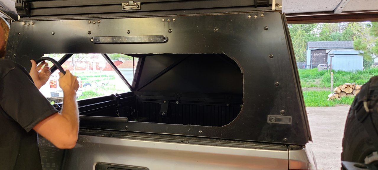

    Windows going in
