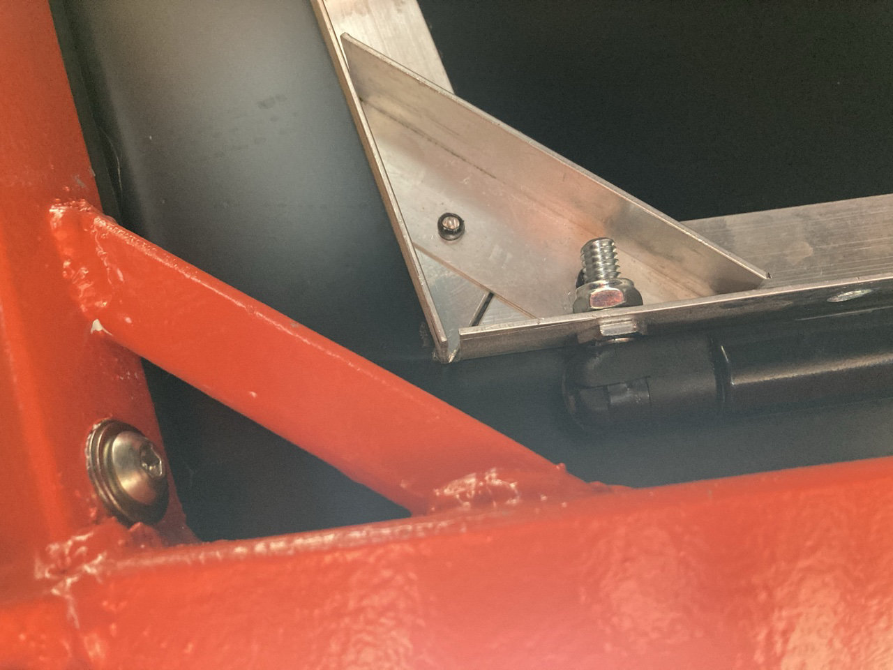

    When installing the gas struts make sure your angled aluminum covers enough length.
    Like in the pictures below you can see that my panel is already denting out.
    i now consider to maybe install 20lbs ones instead892FD634-C504-41E0-9C6E-B2DC9C4F327E.jpgAEF86751-8511-46E1-B6A5-51B1B0F261C8.jpg

    Is that from the corner of the aluminum pushing out? Or from the head of the strut contacting the panel?

    It is from the corner of the aluminum. the gas strut heads are not touching.

    Are there two separate pieces of angle aluminum meeting at the corner?
    if so that might be part of the problem

    Yes it’s two pieces coming together..should be visible on one of the pictures I uploaded.
    I saw this early in the build and was hoping the diagonal piece is helping to support it.

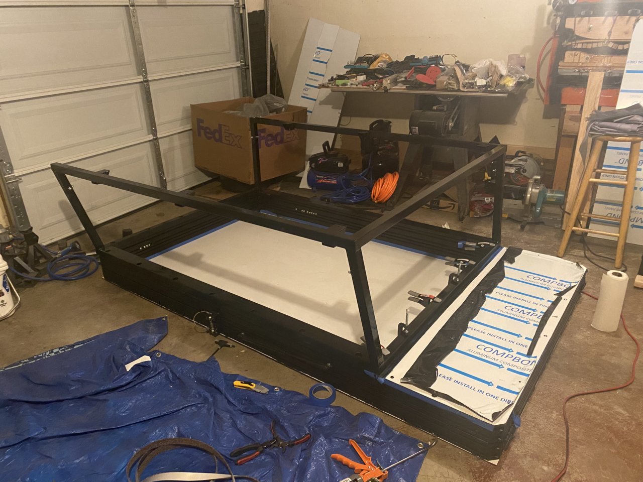

    Got the frame mounted to the wedge today. Are u guys setting any type of torque for the bolts? I did mine a little differently than Ripcord’s though
    JMcFly likes this.
