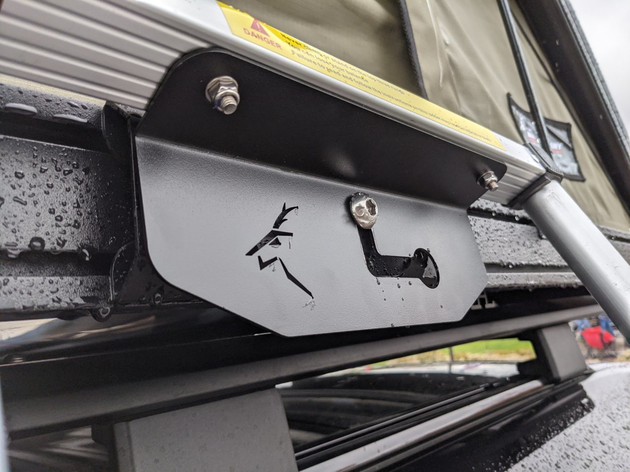

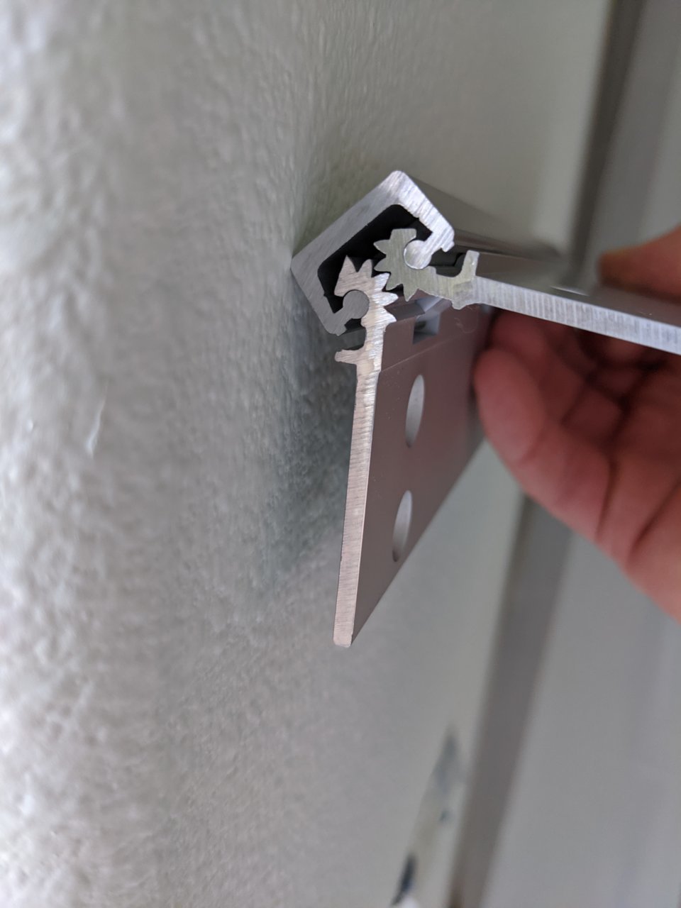

    For anyone looking to add a ladder to the outside of the tent extrusion, here's how the Bush Company attaches their ladders. It is a telescoping ladder that you can get on Amazon for under $100.
    I plan to draw up a bracket in CAD.PXL_20210424_175155390.jpg 82240cb1-8d18-49a0-ae99-aa32840856aa.jpg b20ff737-d9d0-4448-aaa5-68cd6ace6a28.jpg

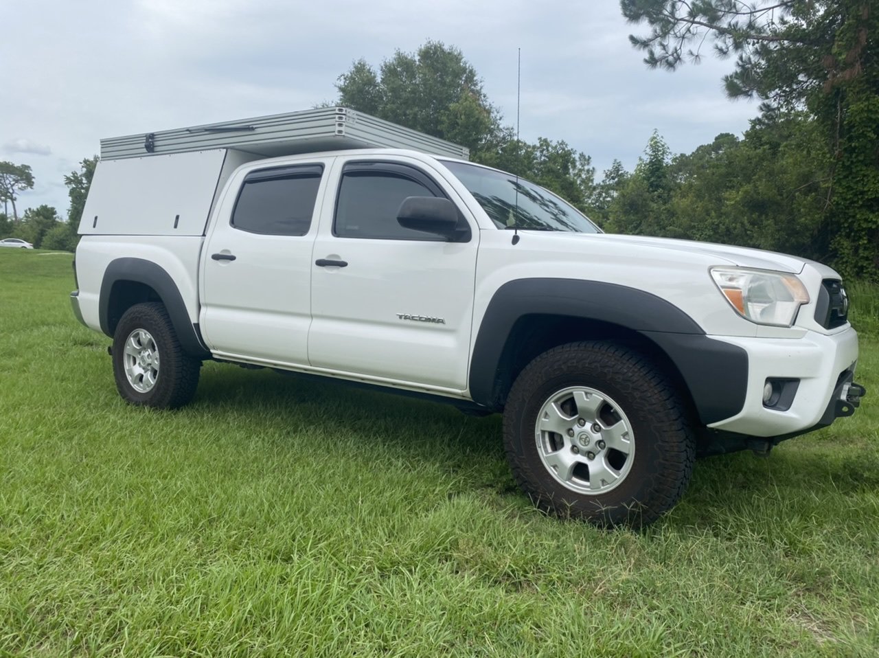

    It’s on! And then I drove it in a typical FL monsoon 30 minutes later. The corners in the extrusion really need to be sealed so I intend to redo the extrusion seals to bend around those corners.
    Doors will go back on tomorrow and then off again eventually when I do the stiffeners.
    I really want to put a window in it now and I highly recommend it to anyone else doing this
    unless I get one of those mirror cameras with constant rear view.

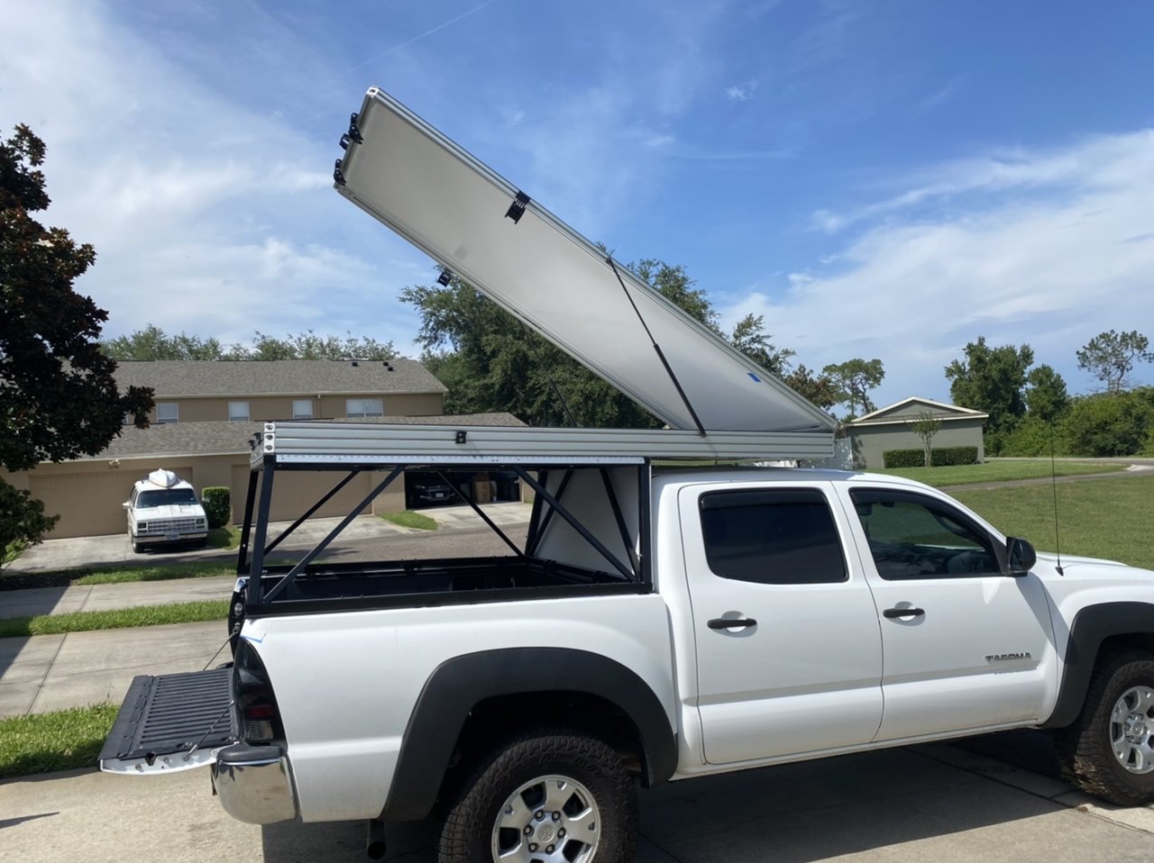

    This is what I did. I recommend putting 1 rivet next to each strut though for peace of mind. Otherwise, it's held up great.
    P.S.: Give the tape a full 24-48 hours to 'cure' before mounting up and putting any type of force on them. It makes all the difference.

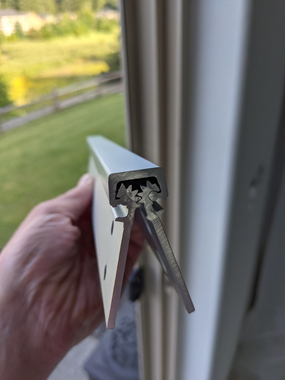

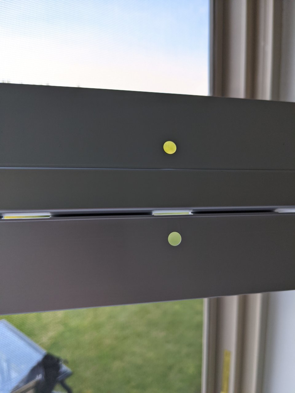

    Got a sample of some gear hinge, this one won't work unfortunately because of how the enclosure rolls backwards.

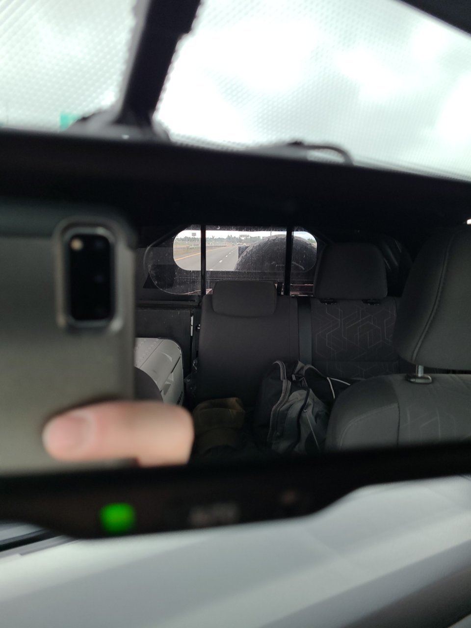

    I installed my VanTop dash cam mirror thing with rear view camera and it’s alright. I can’t use my sun visor since the camera extends to clear the oem mirror. I saw they have a mount to replace the oem mirror. Or if they don’t have one I’ll machine up a piece of delrin to affix the mirror to and mount it to the oem arm.
    It’s sort of weird using a camera as a rear view mirror since it’s a wide angle lens. If I could do it over I’d install windows but this works.
    I did have to flip the rear camera bracket so I could mount it how I wanted on the rear door. I do need to get like a 12” extension to the camera wire. It’s a little tight and I can clean it up better with 12” of slack.
    The 10” mirror works but the 12” would probably be better if you mount it over the existing mirror.
    I ran it from the mirror, down the side of the dash. Poked it through the wiring grommet under the drivers seat, ran it through the frame rail, and up through a hole I made bigger in the bed. I’ll get a grommet to make it look finished at some point and wire loom to protect it all.
