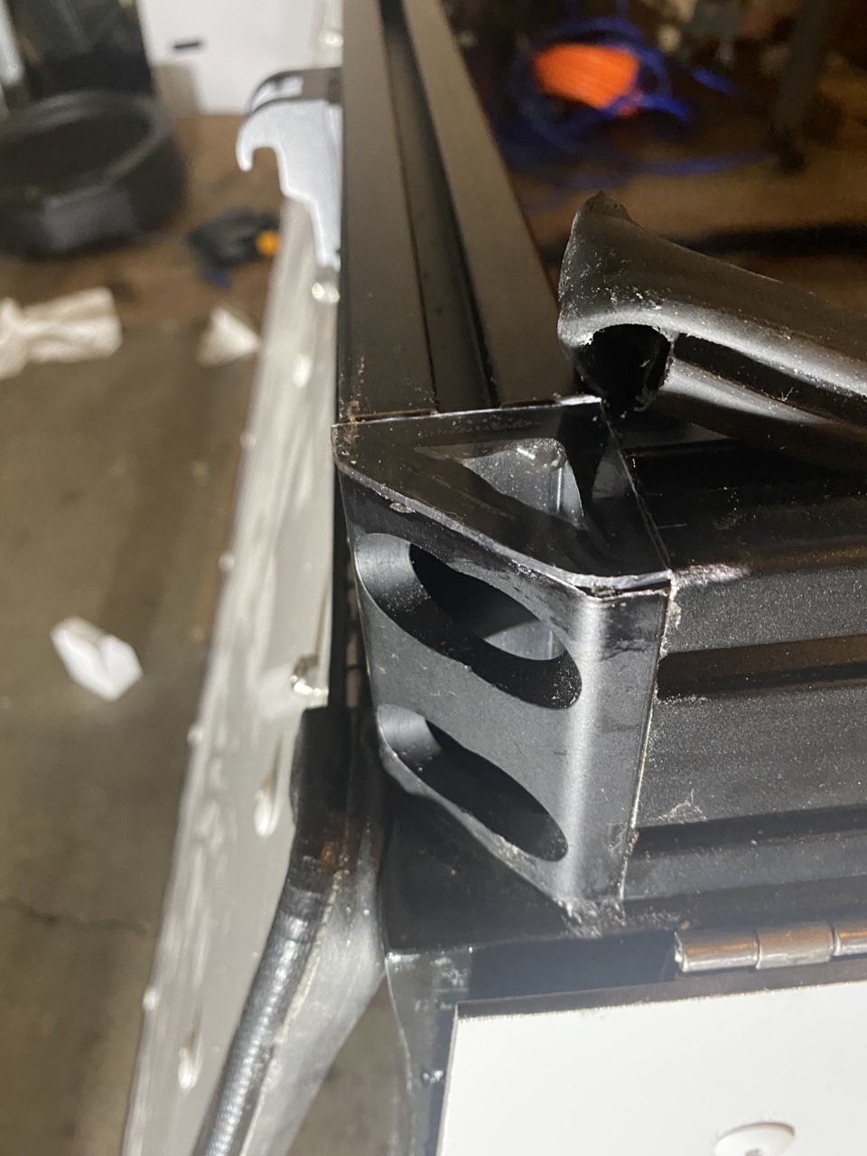

    I installed my piano hinges and when looking at the seal from the frame to the hinge it wasn't always flat(there was light getting through) so I ended up taking them off and put sealing adhesive between and will do the same on the doors. Then I plan to do something like this gasket between the hinges gap. Hoping that solves most of the water issues. Have to get this right since I live in the PNW.

    I bought some plastic/lexan and put on the corner to help with the sealing. I think this will work. I’m on the home stretch!

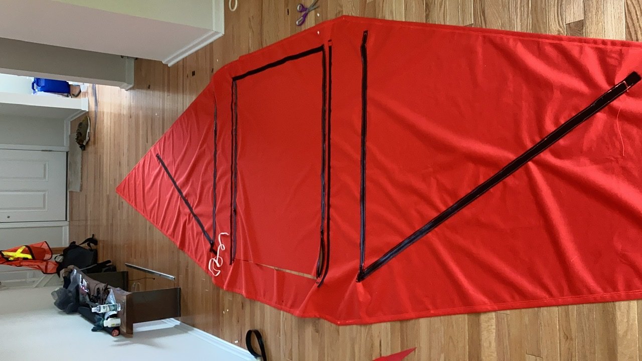

    hey all,
    I've been reading through this and doing a lot of research.
    I've come to the canvas point and I didn't think it would be this challenging. The canvas to me is an important part so I was looking to have it sewn up professionally. I received a quote from a tent/canvas company and they were wanting $1075. Then I searched around for a local seamstress, and provided plans and told her that I would buy all the materials and she came back with $1500 to $2000!!
    Are those prices reasonable? (for a professional job)
    I've searched material prices and the totals are only about a couple hundred dollars.
    For those that have done the sewing yourself, are you happy with the outcome? Any issues/leaking/deterioration?
    I'm leaning towards borrowing a sewing machine and doing it, but just want to get some others thoughts.

    I'm in the middle of the "tent sewing phase" myself. Yeah, it seems simple until you get into it. Multiple hems, and double-zippers around curved edges takes a LOT of time. TIME is the biggest cost driver, especially to have a professional do the sewing. I resigned myself to "just do it". Its a DIY project. I'm actually having a blast re-learning how to run a sewing machine after 40+ years (middle school...?). Oh, and my design has NO curved windows, which lowered my stress-level considerably. ok, back to sewing...

    Do it yourself and take your time and don’t rush it and your a going to be ok. Paying above 1000usd for someone else to I do it is absolutely not worth it.
    My soon to be wife and I worked on it for maybe a week in the evenings and I think it turned out really good. And all this on a entry level sewing machine. Attached some pictures

    Do it yourself. Definitely need 2 people, one to hold the bulky fabric while the other feeds it through the machine. And basting tape is your friend. I believe I used about 130ish yards of it.

    My wife makes quilts and we start at $300 for a simple T shirt quilt. There’s a ton of prep and labor involved in sewing people are not really aware of.
    $1000 to sew the tent doesn’t seem far off
