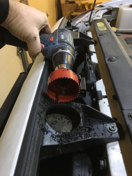

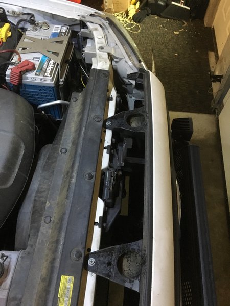

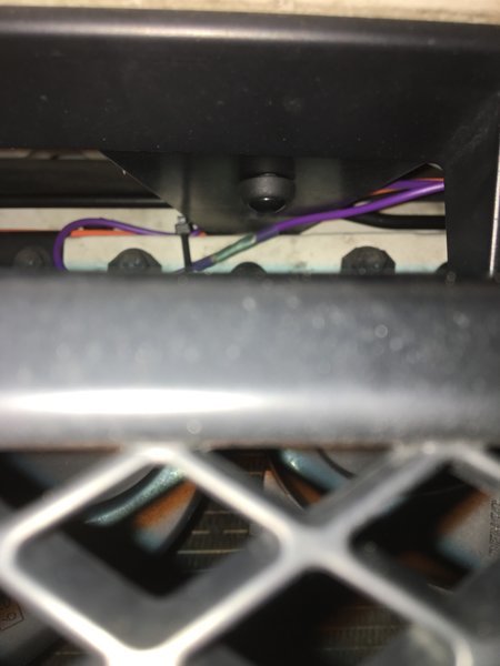

  19. Jan 16, 2017 at 11:23 AM
    #39
    EdinCincinnati
    EdinCincinnati Well-Known Member
    Mar 11, 2013
    #99457
    2,429
    Ed
    Ohio
    2014 4x4 TRD OR
    So I did this today...lock / unlock buttons but I separated mine so one button per grill support. Also, rather than dremel out the bottom, I used a holesaw and took out the top and attached the button to the lower level support than the OP did.
    Here is the lock button:
    My truck is a 2014 DCSB...my wire colors were the same and in the same location.
    I'm going to add a double pole toggle to disable both the lock and unlock but I don't have the switch yet.
    EatSleepTacos[OP] likes this.
