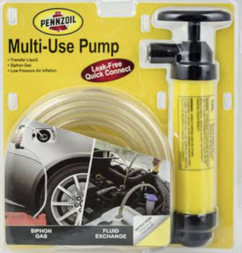

    1. Attain a $10 fluid pump from
    your local auto parts store
    2. Extract all the fluid from the power steering pump reservoir
    3. Fill the reservoir with new fluid
    4. Start the truck, let it run 5 min while you turn the wheel completely left then completely right
    5. Repeat steps 2-4 two more times

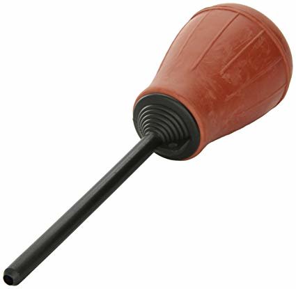

  5. Apr 5, 2020 at 5:18 PM
    Lord_Wrath
    Lord_Wrath [OP] New Member
    Apr 5, 2020
    #323882
    4
    16 OR Tacoma
    That sounds like a good idea.

    I use one of these and Maxlife ATF.
    MannyS and kahanabob like this.
