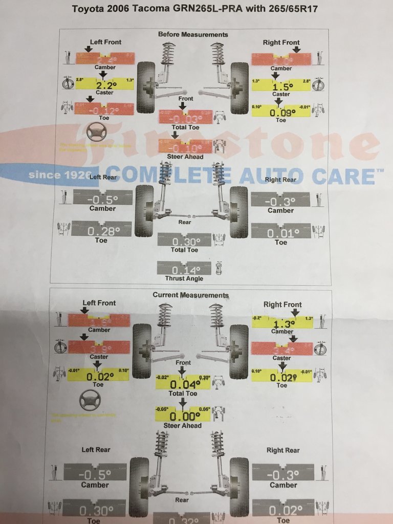

    Throwing this out there for every one to chew on.
    Firestone alignment last night!
    Ask for as close to 3* caster rest 0*
    Mind you the day before I replaced inner outer tie rods, Lca bushings and bolts, lower ball joints. And I have spc uca's.
    My tires are 285 not 265?
    I sat on it for the night to calm my self.
    Anyone think I have something to bitch about?

    I certainly don't like those camber numbers. I would sacrifice some of that castor to get camber back in spec.

    Hey Jason do you have any links about how adjusting camber and caster effect each other?
    Think I'm gonna have to do it myself, as I sit here and watch the tech realign it I'm getting madder by the minute.
    They've had it since 11 am it's now 5:30 and said it would be done by 5:00!

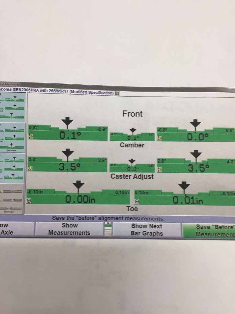

    IMG_1006.jpg Well I guess I'm doing the alignment myself. Here's their next try...I just don't get why this is so hard. And get this their printer was not working today. So the tech wrote the #'s on paper.

    It could be the tech but it could also be your truck. They should be able to get the toe to zero but the caster and camber are related (as is clearance if you're running 33's!)
    Caster and camber are adjusted by the same cams. Think of your LCA as a triangle where the ball joint is one point and the two cams are the other two points. The cams adjust laterally, that is they move their points of the LCA closer to or further away from the middle of the truck. Moving both cams out will create negative camber. Moving both in will create positive camber. Moving the cams in opposite directions changes caster. It's possible to run up against the limit of the cams adjustment when adjusting for one and then not being able to get what you want on the other.
    For instance, if you are lifted you will have to run the camber adjusters further in (I think thats right?) to maintain zero degrees but you then will leave less room to adjust for caster.
    But again, I think toe should be <0.1* bit camber and caster are a littile more forgiving.

    I'm gonna say tech. They have plenty of room for adjustments. Already done a cab mount chop and trimmed inner front fenders.

    I have a feeling you will have to give up caster to get the camber to zero. Have you lifted the front? My numbers look similar and camber is maxed. No room to adjust the LCA outboard without sacrificing caster, which doesn't bother me but the rubbing does. Good luck! I think the home align is the way to go!

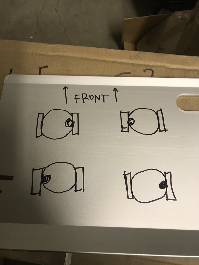

    Here's what I was going to do. Max out the caster. Then adjust the camber into spec.
    Do I have this part right for max caster. It's o. A 2016. This would be looking directly at the cam (front most and rear most).
    N-C.nebulosus and mcharfauros like this.
  20. Jul 29, 2017 at 3:13 PM
    #220
    tetten
    tetten Cynical Twat Waffle
    Nov 2, 2014
    #141581
    2,504
    Andy
    Socal
    Correct
