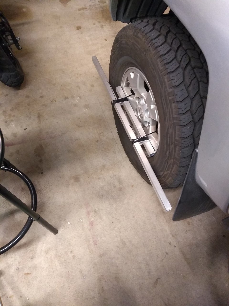

    As an amendment to the OP i found doing it slightly different provided easier / better results.
    The key with alignment is getting things equal. Tire killers are toe and camber. Caster not so much. Luckily toe and camber are the easiest to set.
    CASTER:
    For caster you want to be equal on each side so if you follow the same procedure on either side and get the same numbers you can be very accurate.
    1. Turn wheel you are measuring so that it points out (if you are measuring caster on driver side, that would mean turn to the left first)
      1. 20* of steering angle is right at +- 1 turn of the wheel from center. Figures calculated below can be multiplied by ~1.4 to get actual caster number OR do +- 1.25 turns of the steering wheel from straight and get more accurate numbers without having to multiply by anything
    2. Line up angle finder on the rim to measure for camber and ZERO IT OUT
    3. Turn wheel same number of turns so it points in, and then measure camber angle with angle finder. (zeroing out the angle finder on the first measurement simply makes the angle finder do the difference math for you!)
    And those are your caster numbers. Like stated doing the 20* in and out yeilds a difference figure that needs to be multiplied by right around 1.4 to get actual caster numbers (i have verified this with doing my calculations then taking it to get computer alignment checked). I then did a bigger caster measurement sweep (1.25 +- turns of the steering wheel) and came up spot on to computer alignment numbers calculated. I noticed when I watched the alignment guy he was turning right about the same 1.25+- turns for his caster sweeps so this makes sense.
    CAMBER:
    For my and my SPC uca's this is INSANELY easy to adjust as its one nut, slide the upper ball joint in or out without affecting caster adjustments at all. Its also easy to measure as like stated above, simply zero out your angle finder on your straight edge on the ground next to your tire (on the same plane as vertical of your rim) and then measure camber (degrees off of 90* from the ground)
    TOE:
    This one is kind of a bitch especially if you are doing it by yourself. But last night I came up with a super simple way to measure by yourself INSANELY accurate. Make two long straight edges that you affix to rims that extend out past the tires so you can hook a tape measure on one side of the truck in front or behind the tire and measure on the other side then measure the difference in toe in or toe out. I was always able to ball park it with a line on the tire like in the OP but now i can be confident in saying i have 1.5mm of toe in.
    Anyways. I gotta say to the OP. Thanks for this thread. It made it to where I am confident doing alignment on my truck, know i can get it dead nuts accurate and the satisfaction of doing it myself as well as saving $$$
    mallege, Calion, BRONSON and 4 others like this.

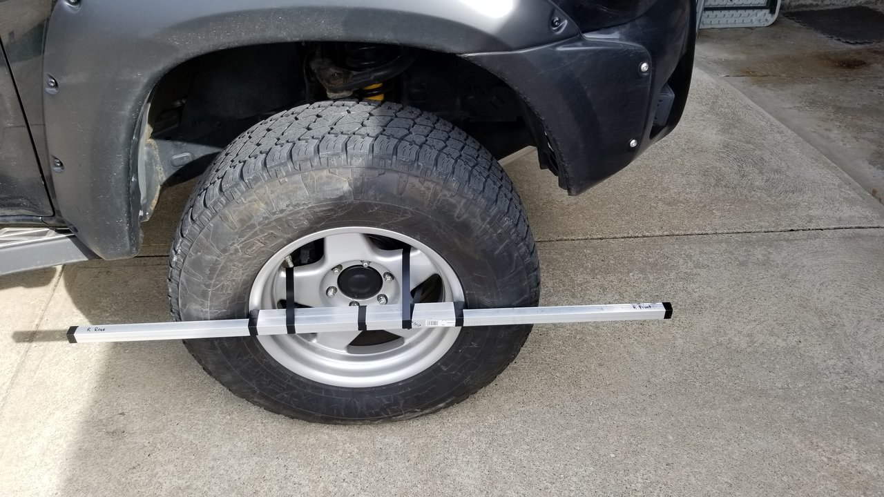

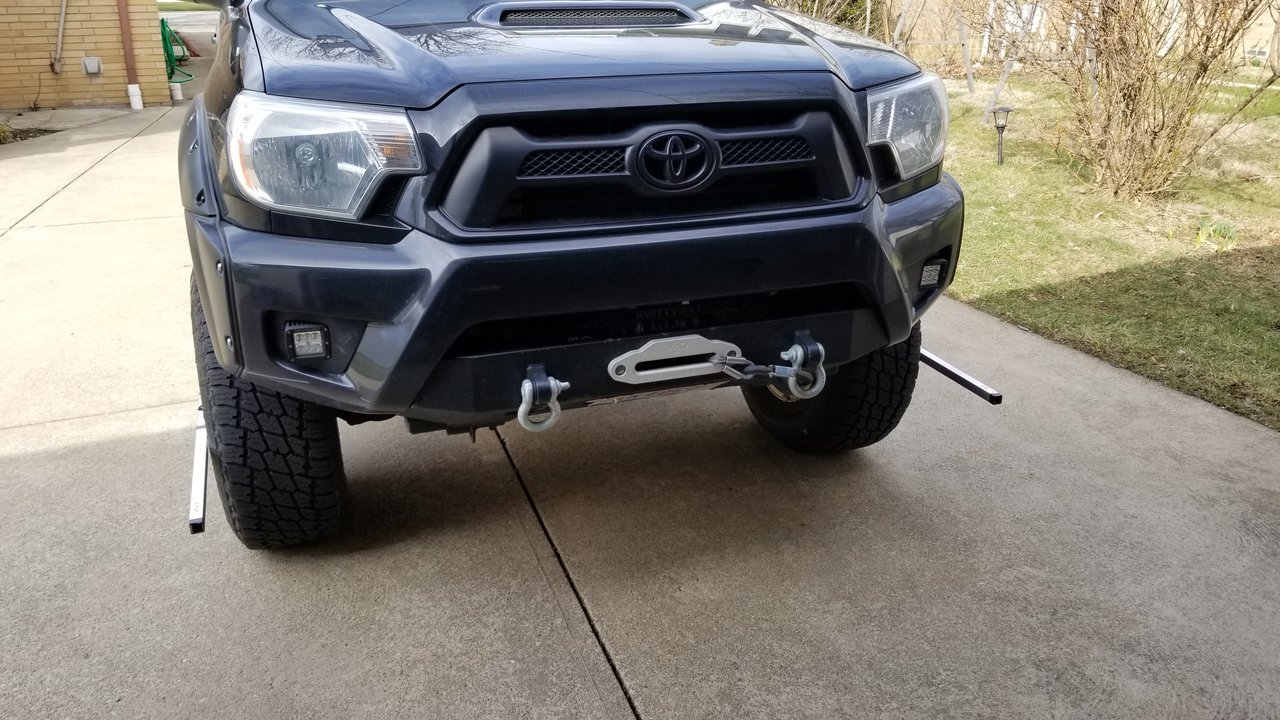

    I just did your toe method and it worked like a charm! I used electrical tape to hold the aluminum in place and a digital angle finder to level them, then measured. As suspected, I have way too much toe in after installing some OME trim packers... 8mm of toe in, or .45 degrees! Adjusting that down to acceptable numbers around 1.5mm today.
    Thanks for the advice.

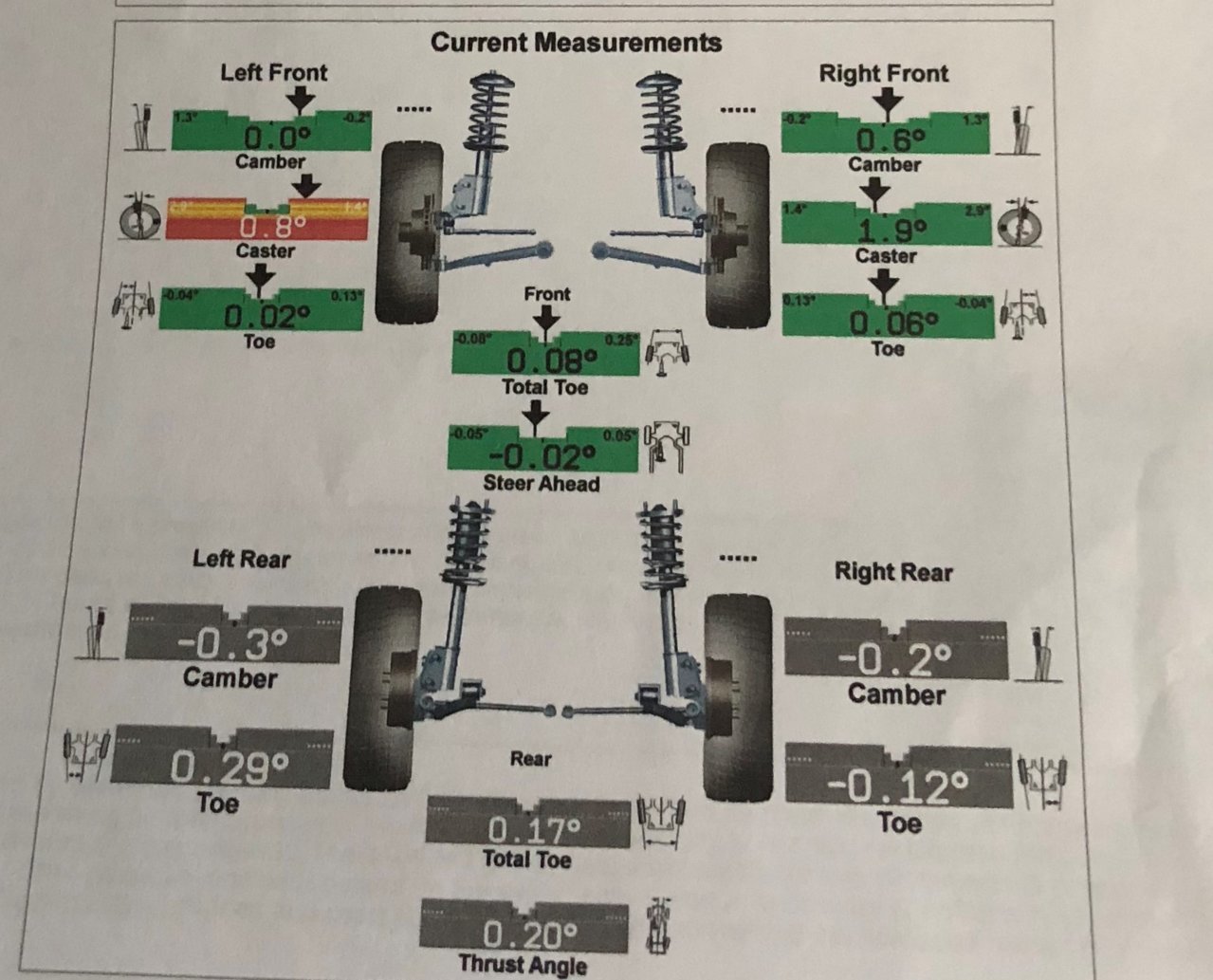

    Haven't attempted this yet. I was wondering if you know how many degree of camber/caster.
    went and got my truck aligned from "reputable" shop but they didn't attempt at the caster is was .8 first and still .8 when they finished.
    Based on what I've read here, If i shorten the the front of the driver side, it will add caster, add camber and in my head probably toe in the driver wheel too. all things that could be adjusted to still be in spec.
    I'm wondering how much per a mark on the cam bolts, turns per bolt affect the camber/caster. Maybe even if a rough estimate.
