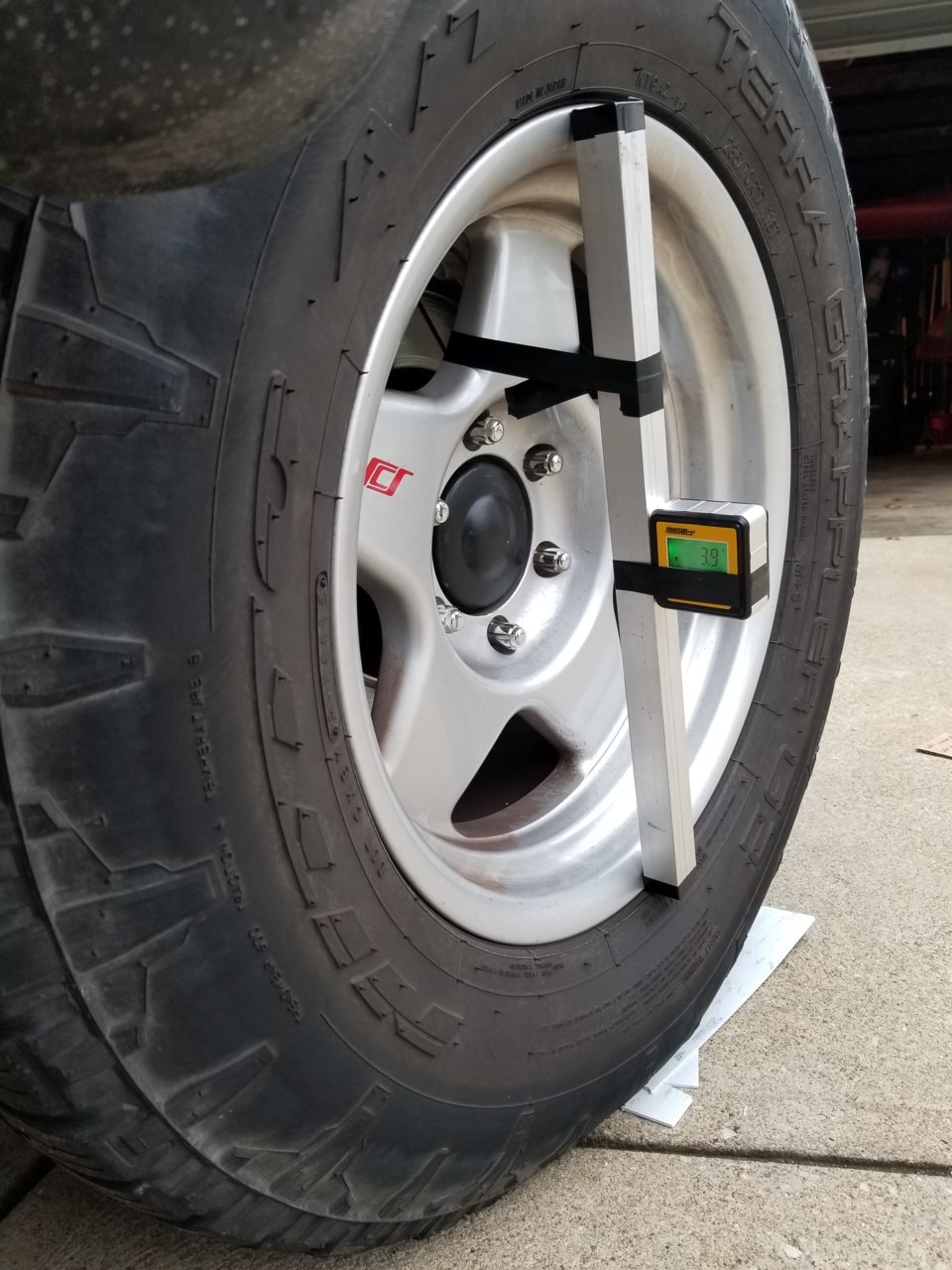

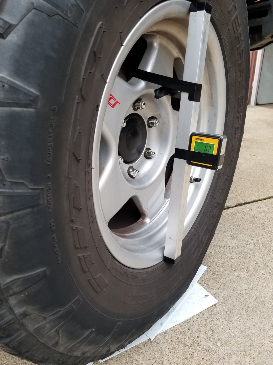

    @nd4spdbh your amendment to measuring caster is spot on! I zeroed the angle finder behind each tire, mounted it to the wheel with electrical tape, then turned the wheel 1.25 turns each way. I did it 3 times on each wheel for an average, but each time the results were literally identical.
    My caster is 4.0 on the drivers side and 3.7 on the passengers side. I'm going to increase the passengers side to about 4.2 for the correct cross caster for road crown, reset toe, and call it a day!
    Centered:
    1.25 turns right:
    1.25 turns left:20181117_150512.jpg

    For the caster, turn the wheel out (left if measuring drive side), zero the angle finder on the vertical, turn it back in the same amount (1.25 turns from center in this case) and the angle finder calculates the difference for ya.

    So I turn the wheel 1.25 turns out from center, zero the angle finder, then turn it back 1.25 turns to center and the reading is my caster on that wheel? Or do I continue 1.25 turns in for the final reading?
    Edit: disregard. After reading your post again, I see that I need to turn 1.25 turns out, zero the angle finder, then sweep all the way through to 1.25 turns in to get the caster reading.

    Yup you got it +- 1.25 turns from centered.
