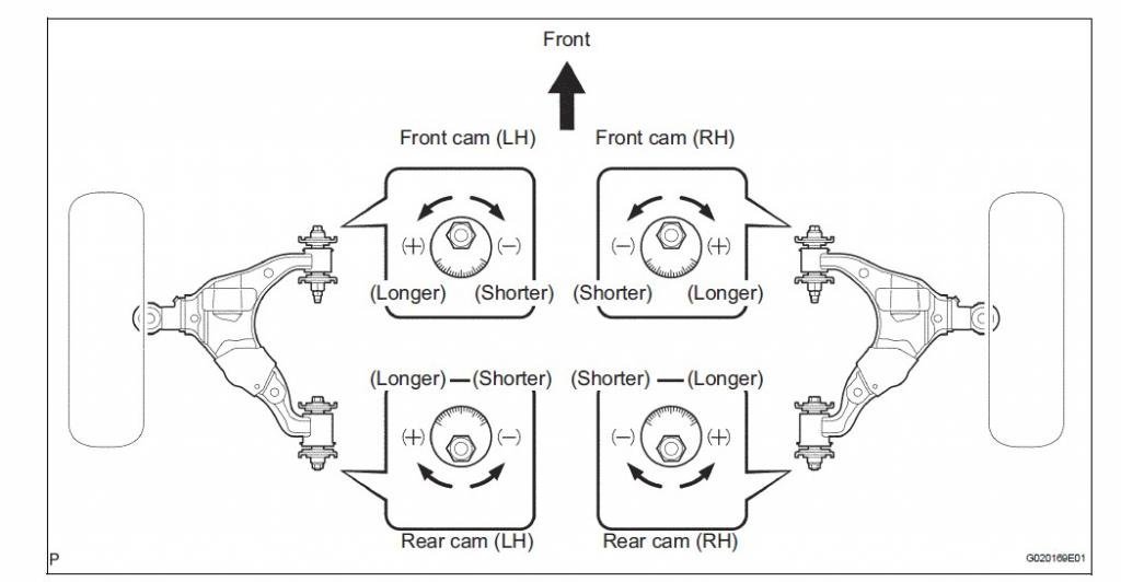

    If I'm understanding this correctly, the eccentrics from factory for a 2nd gen should be top justified in the front of the lower control arm and bottom justified in the back of the lower control arm as a starting point creating a "rake" in the arm when looking at each face on or is this drawing viewed from one dimension where the image would be flipped upside when viewing the forward miss-alignmnets face on.
    I really hope that makes sense ant isn't convoluted and I'm not over thinking this.
    I've had a hell of a time getting my truck aligned and being happy with it, been considering the at home method and I'm wondering if this is part of my problem as both my eccentrics (while clocked this way or that) are more bottom justified in each arm.
    Already did the Total Chaos cam tab gusset plates and my alignments still won't stick.
    I think I'm going to take it to a shop one more time, fine tuning at home and then tack welding my miss-alignmnet washers in place, apparently I play to hard to keep an alignment longer than a week.

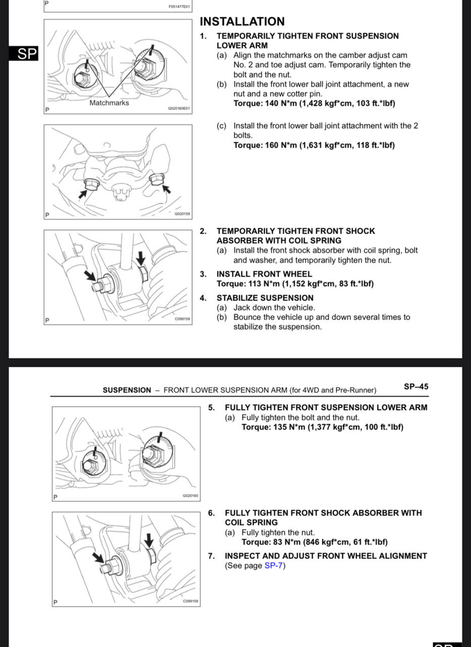

    Question: For adjusting caster and camber, I’ll be making the adjustments while the front of the vehicle is off the ground, lightly tightening things, lowering it back down and then torquing, correct?

    I adjust on the ground just make sure to drive back and forth a bit/turn steering wheel so it transfers. If on the ground thought may have a lot of resistance turning the bolt as the wheel has to move at least without something under the tire to allow it to move freely.
    …and yeah tighten the bolts. I fucked up the other weekend got distracted checking out a hot realtor at the house next door forgot to tighten backed the car up a bit and cam bolt shifted out of place (slightly out of the tabs it sits in). It was a cluster fuck to take stuff apart to push it back in place. Luckily nothing broke…from what I can tell at least.

    This is from the FSM for a 2006

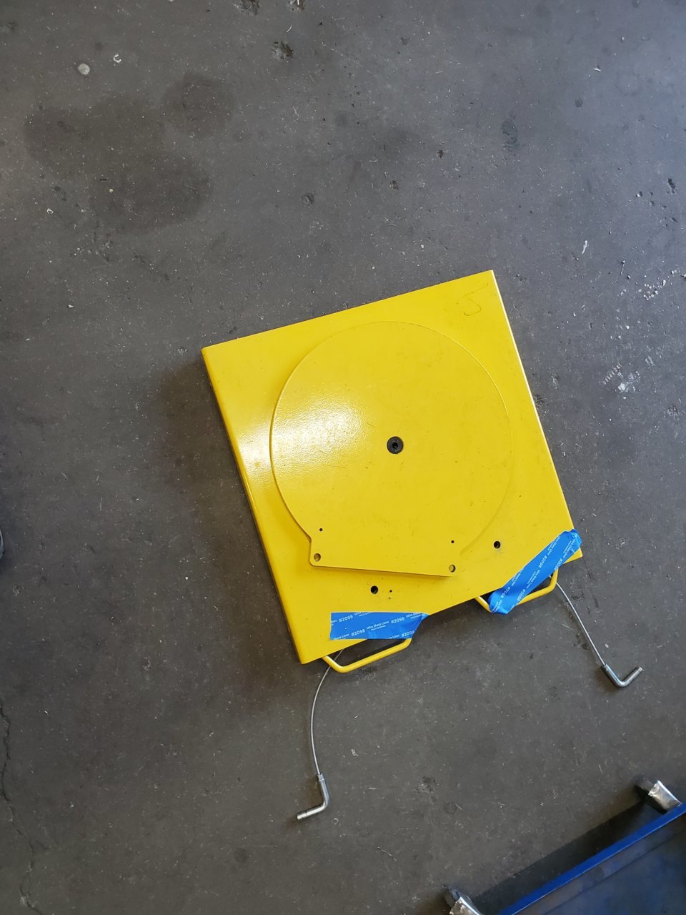

    When I jack my truck up I can freely move all 4 alignment cams in both directions and get the max range of adjustment in both directions. I also have the alignment turn plates that measure the 20 degree and they move 1.5" in all directions allowing the suspension to reset.
    Is the proper procedure to be making cam adjustments with the vehicle on the ground under its own weight? When the vehicle is resting on its own weight (no jack) the cams do not move freely and I can't get them to turn enough to make proper adjustments.
    My current process is to raise the vehicle make adjustments then lower back onto the alignment turn plates and check my numbers.

    @wtmorgan1
    I did mine with plates loaded.
    Used a 19mm box wrench and tapped it with a 2.5lb hammer to make cams move.
