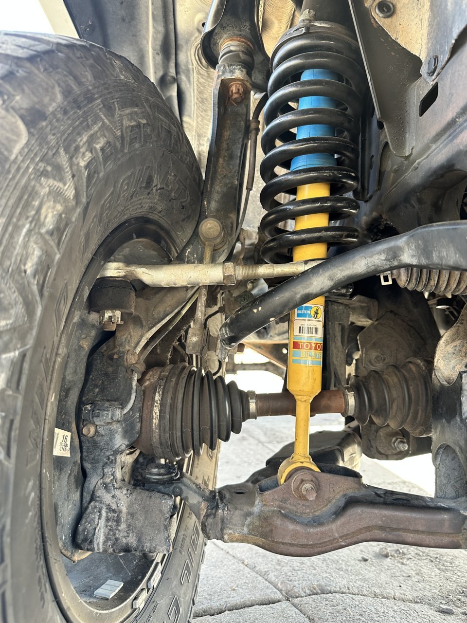

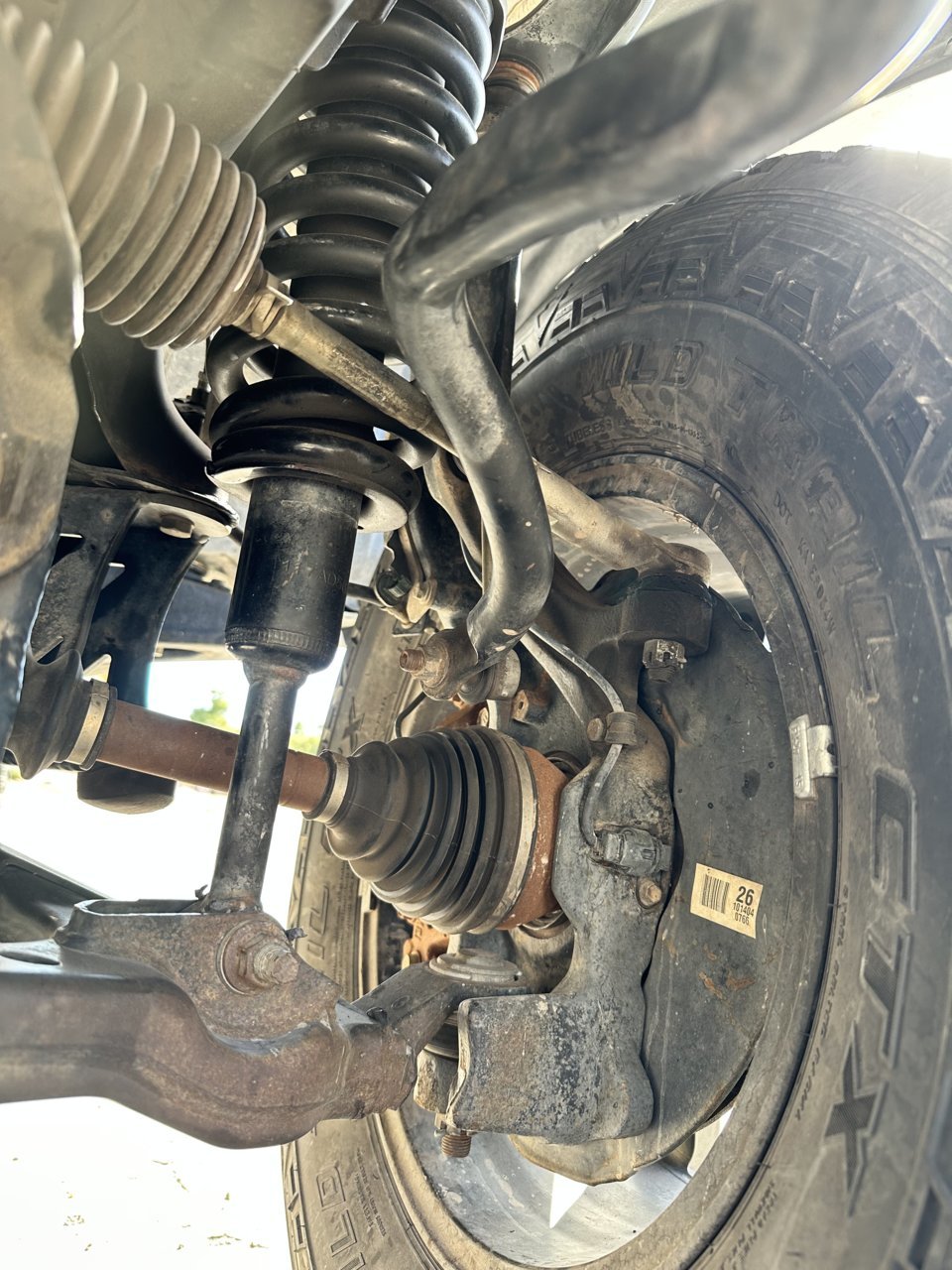

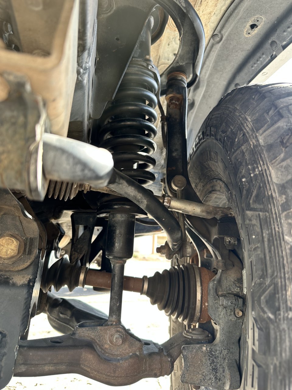

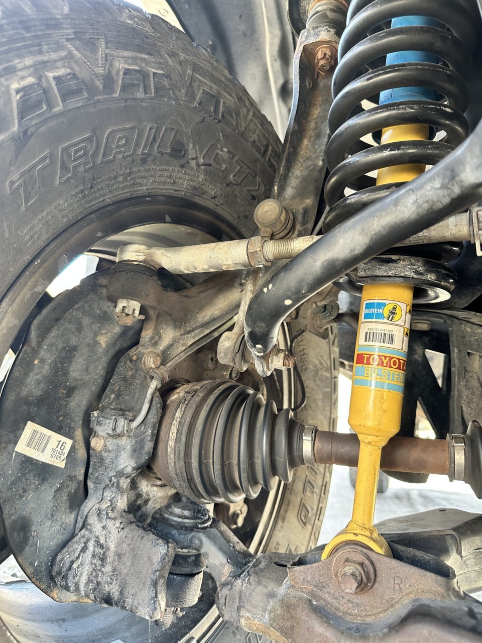

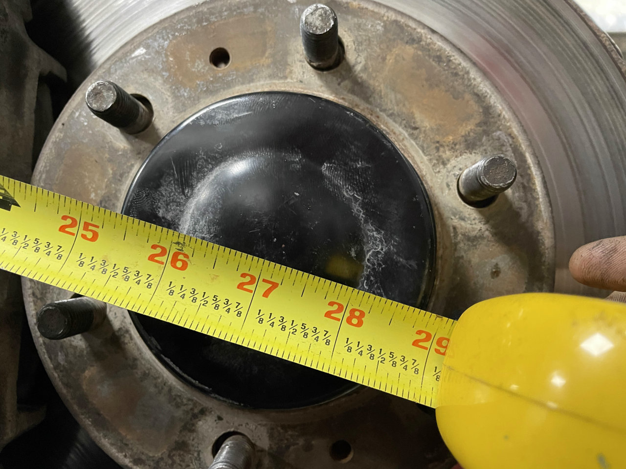

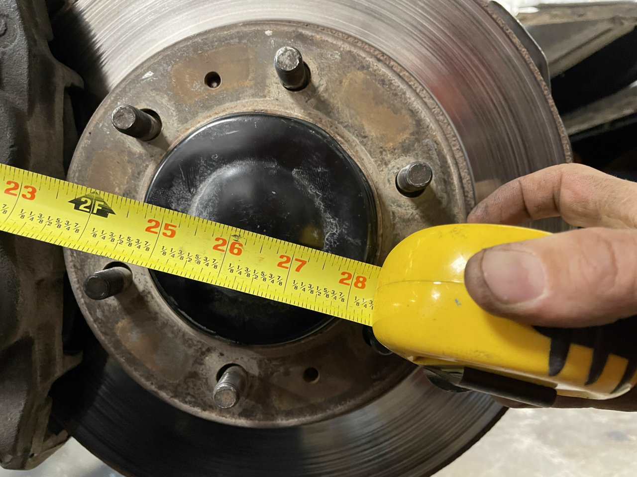

    Got any other pictures? My guess would be a bent spindle. But throw up a few pictures of both sides to compare.
  2. May 7, 2023 at 4:09 PM
    #382
    05Taco4bye4
    05Taco4bye4 Active Member
    Apr 19, 2023
    #422800
    27
    William
    2005 Tacoma 4x4 4.0
    The first 2 are the bad side and the other 2 are the driver which seems fine

    Sorry ignore the last one this is correct lol first 2 are passenger which have negative camber pretty bad and the driver side is the second 2 which seem fine

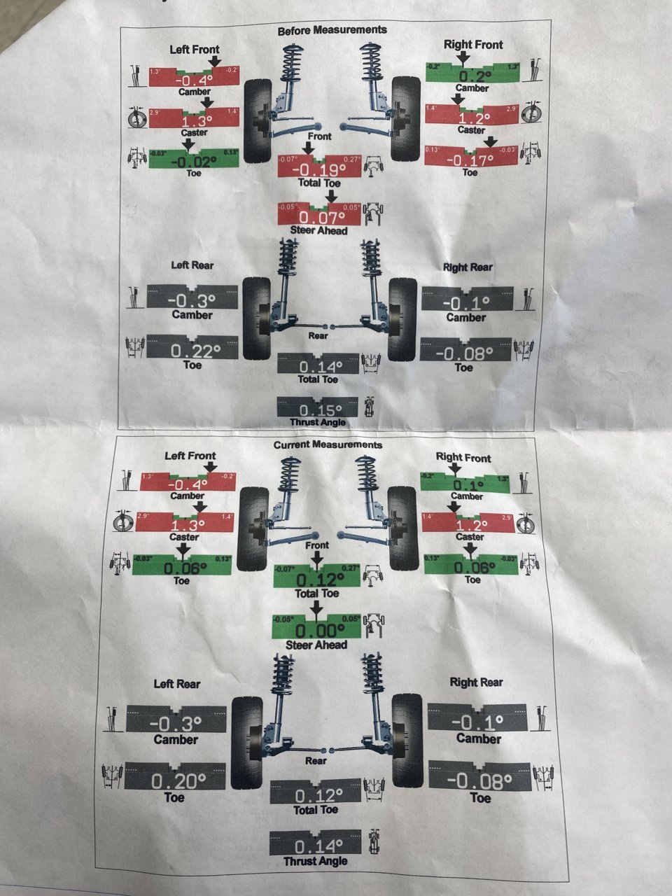

    I got an alignment this morning. Took it to the stealer, they only adjusted toe… should I take my ass back down there?

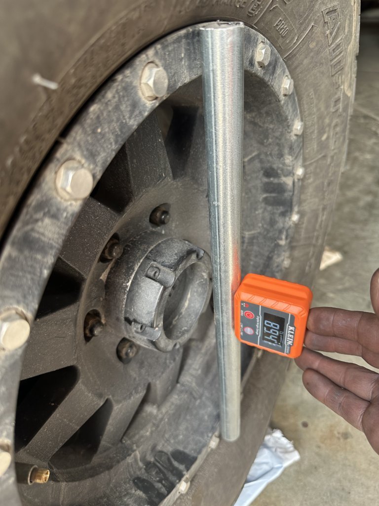

    I don’t know if anyone has posted anything like this but I found this a reliable way to measure camber when using a digital angle gauge. It’s just a piece of conduit, and it works well because the groove in the angle gauge fits positively onto it magnetically. It’s also dead flat/straight. No bowing.
    I find that the angle finder being off in terms of plumb can effect the number given, and the finder being able to nest firmly on the conduit means that you don’t have to worry about its position on flat stock and can focus on holding the conduit plumb and square to the wheel.
