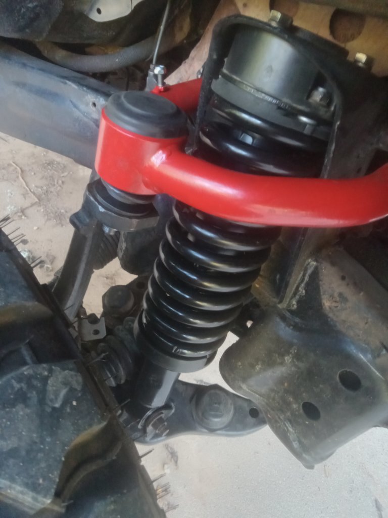

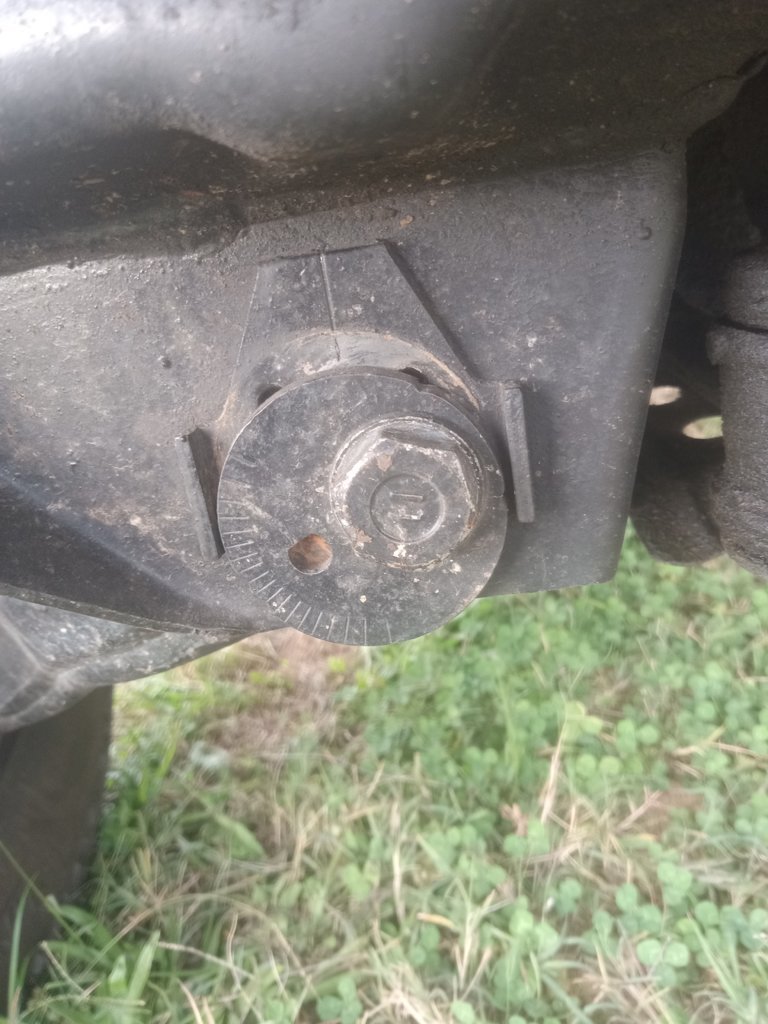

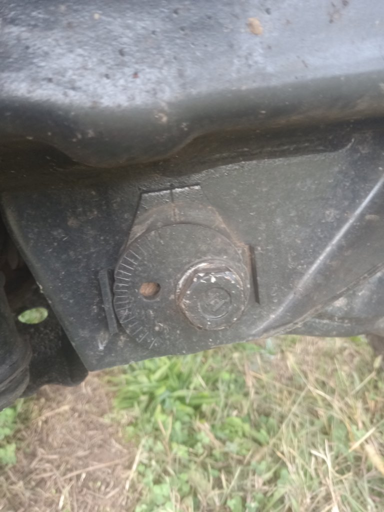

    I'm building this truck and just out new upper control arms on it along with struts now I need help doing an alignment so I can drive it to a local shop any advice on how to do it .. somebody told me to turn both front cams inward then the back ones outward and adjust my toe is the true

    Get 2 flat equal length prices of wood and push them against the face of the tire flat on the ground. Get 2 tape measures and measure from one peice of wood to the other. Adjust the tie rods until the front and back measure the same distance apart. That's close enough to get you to an alignment shop.
