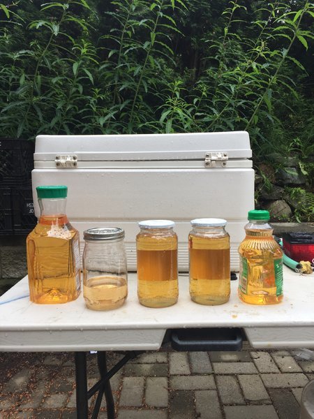

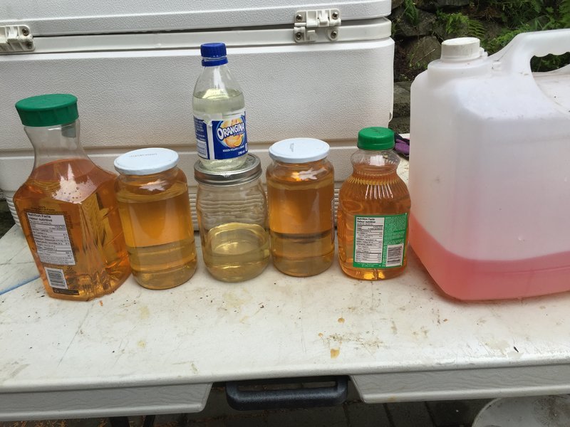

    Looks like off road diesel.

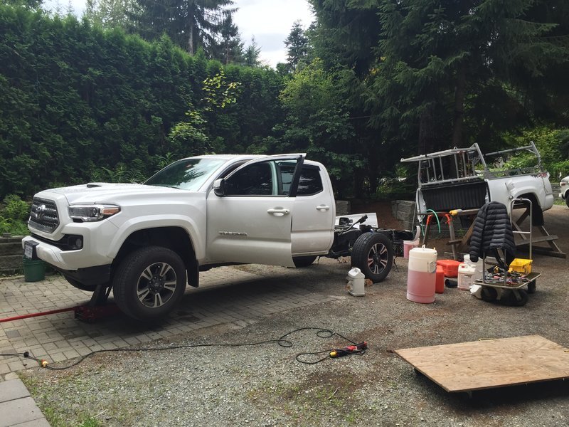

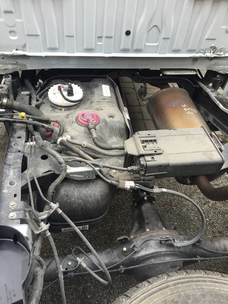

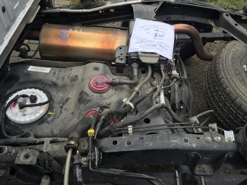

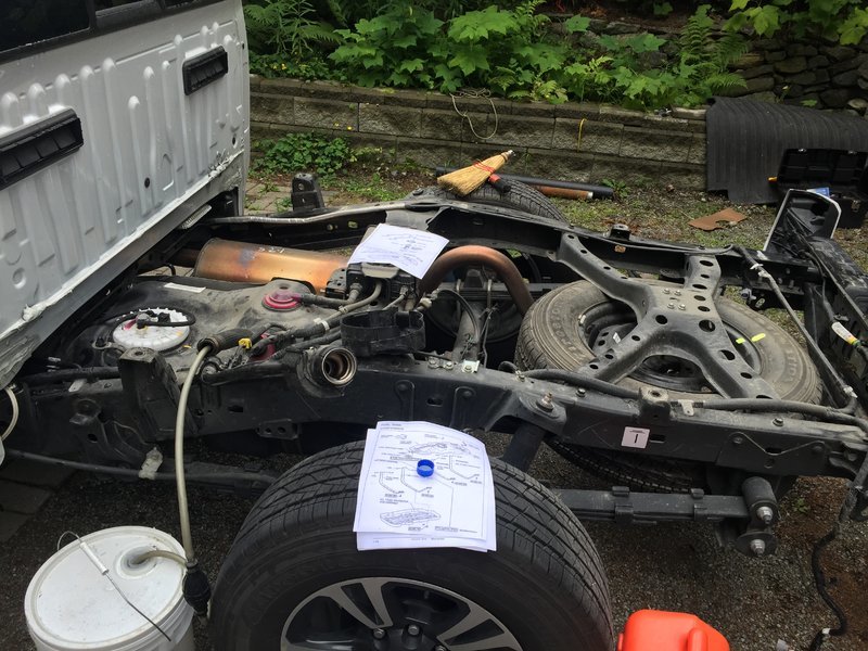

    For me, the easiest solution has generally been to remove the bed. That exposes the tank. Now you have access to everything including the filler neck. Remove the hose, and you can get most of it out with a siphon hose or manual pump. However, that being said, you REALLY do need to know what it is (the liquid).
    I dislike dropping a tank from the bottom, particularly if it has a lot of fuel in it. My old ranger made that impossible due to the T shape of the tank with ears over the frame cross-members. But with the bed removal (easy on the Yota with the obvious bed retaining screws) that certainly seems easier to me.

    If you're positive it isn't diesel, it sounds like valvtech marine gasoline. Which is basically a stabilizer added to E10 regular 89 octane fuel. It is just fine to run in your truck.

    I've used a mityvac to do mine. Small hose like 1/4" will work as well. Mity vac comes with rigid hose, so it is easier to get into the tank

    box came off real easy, just make sure all your wires are undone
