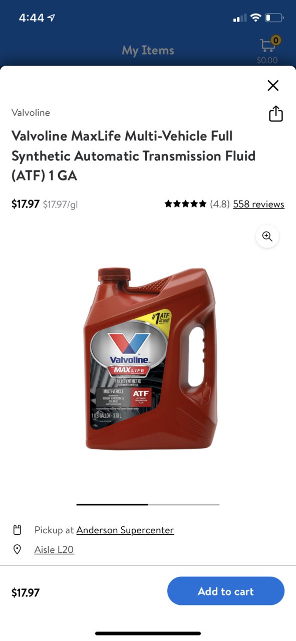

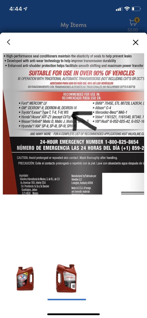

    Looks like a lot going on in this thread. To dumb it down a bit:
    My 2nd gen manual recommends "Genuine Toyota ATF WS"
    1st page of this thread (2008) says there is no alternative fluid that meets the specification. Is there a cheaper fluid that meets this spec 14 years later? TIA

    There are many compatible non-Toyota fluids.

  15. Jan 26, 2022 at 4:46 PM
    #1995
    Sicyota04
    Sicyota04 Slowly but surely.
    Jan 9, 2015
    #145940
    3,558
    Morgan
    California
    04 DC 4x4
    This stuff works just fine. Compatible too
  16. Jan 26, 2022 at 4:55 PM
    #1996
    Doc Samson
    Doc Samson Well-Known Member
    Feb 1, 2018
    #243142
    662
    Almost NoVA
    2009 Tacoma TRD Sport
    None... yet.
    Second that! I did a lot of reading before attempting and it got great reviews. I've done three drain and fills with Valvoline and zero issues...
    Sicyota04[QUOTED] likes this.

    My daughter's WS spec'd Yaris has been using exclusively Maxlife for many years without issue
