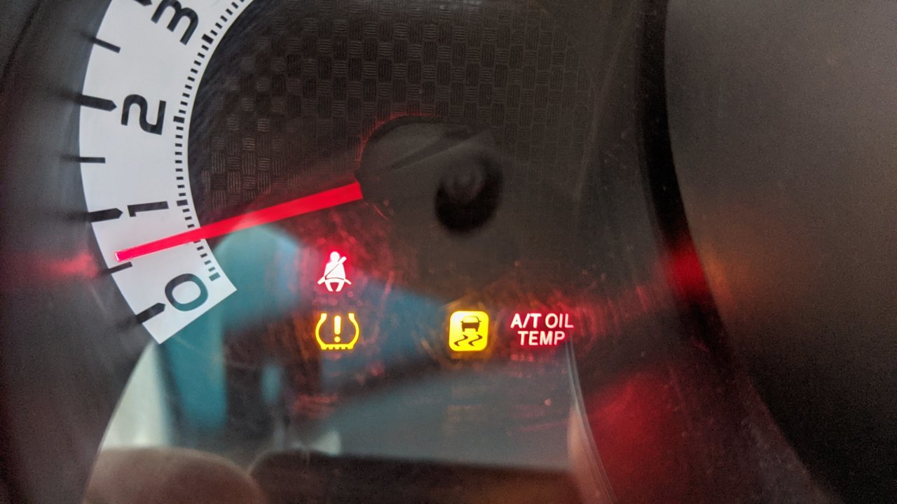

    Many ways to do it, just that nobody has posted it or shown when their light comes on and when it would blink. Your post and my post should help out others who have a 2.5 gen.

    Ok I could only make it through 30ish pages before having to ask. I have a 2012 Off-Road and I did the entire process but got hung up at the A/T Temp mode. I got it to illuminate after shift 6 into N but never again going into P. I did it maybe 12 times and never got it to illuminate going into P. Still ran the truck in idle….for 40 mins…here’s the variable though. Its 26F out. (MN )
    anyone else get the A/T Temp to come on after not seeing it in park. I also left it in neutral once but didnt do anything either.
    thanks ya’ll. I’ll give detailed writeup of the woes and wins after I get the overflow temp level thing figured out.

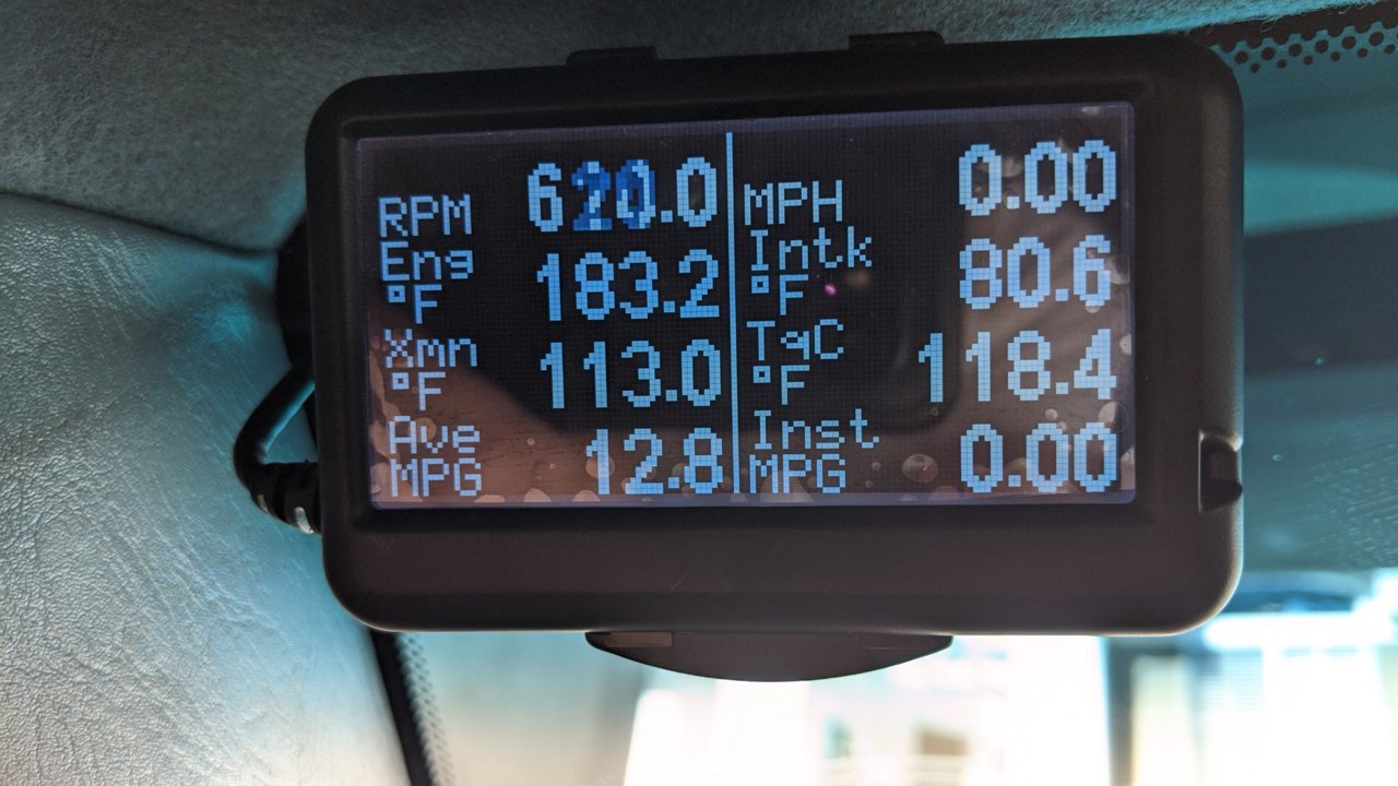

    I'm about to perform the ATF flush/fill for the 1st time and constantly read about the difficulties getting the truck into AT Temp Check mode using the jumper wire method. And also about the length of time it takes while doing it "blindly".
    I do have an Ultragauge and can display trans temp and tq temp.
    @hoffengineering and everyone else,
    How confident/accurate would you say it is....to do the ATF fluid level check based purely on the UG trans temps showing 113deg?
    Gut tells me this method is more accurate than an IR thermometer on the pan.

    For context, I've never done it by UG alone. I have drained/filled my transmission 3 times so far, and each time I've verified the trans temp with the jumper wire and dash light. Personally, I would have to do it a few more times to get some more data points to see how well the UG readout aligns with the dash light. That being said, I would expect it to be more reliable than an IR thermometer on the pan.

    Just did the 1st ATF pan flush/fill since my ownership of my truck. Process was insanely simple and just a notch above an engine or gear oil change.
    1. I realized that I couldn't do the jumper wire method and also monitor the AT temp via Ultragauge because I didn't have a Y-spliiter. Because of @hoffengineering 's advice, I knew I couldn't rely on the UG AT temp output because of the lack of adequate data to prove that it was an acceptable method. So, I had to do the jumper wire way.
    2. The jumper wire method was simple. Everything that the video on page1 from the OP was accurate and true. Jumped the pins on the ODBII connector, move the AT shifter, dash lights started flashing, do the P-N sequence, AT dash light lit up for 2 seconds, put it in P, AT dash light lit up again.... and was in ATF Temp Check mode.
    3. Took about 30 mins for the ATF dash light to light up and for me to drain the overflow. Ambient temp was in the low-mid 60s on a sunny N. CA morning.
    4. Drained the overflow to a trickle, verified the AT dash light was solid still. Pulled the jumper wire and plugged in my Ultragauge. AT Temp read 102.9 degrees. (I'm sooo glad I asked @hoffengineering about this!)
    5. Road tested and transmission feels good/normal.
