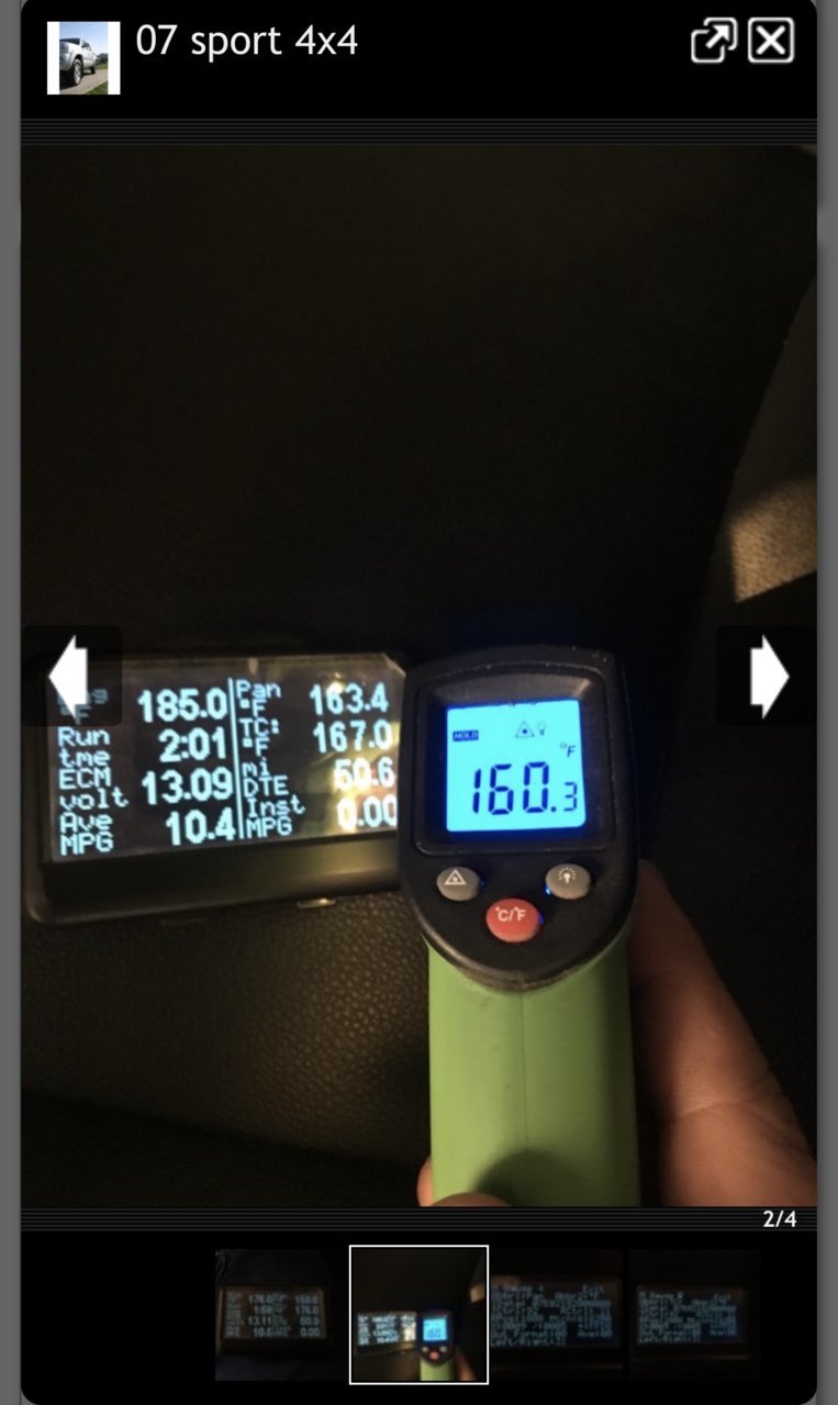

    My brothers 2010 Tacoma and my moms 2016 4Runner use the same codes for the UG. My IR temp gun shows similar temps to the UG. The IR reading in the pic with the UG is in the 16 4Runner.

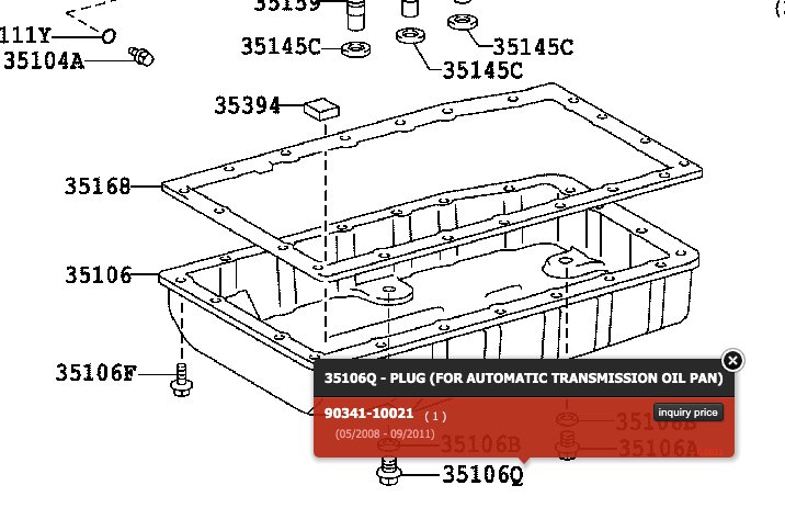

    is the hex plug, overflow/check plug part number 90341-10021? One of the toyota parts websites says it's not compatible with my 2011 4.0 4x4. I think it's the right part. Thank you for confirming.

    The parts site I checked says that check level plug for the A750F 5-speed auto is for Tacomas manufactured from 09/2011 and beyond.

    That part number looks correct. I guess they just split the parts compatibility date ranges between the 2.0 2nd gen (2005-2011) and the 2.5 2nd gen (2012-2015).
    Don't forget to get replacement "gaskets": 35178-30010
    Same part number for the check plug as the drain plug.

    Thank you. Mine is the A750F and was made in 5/2011
