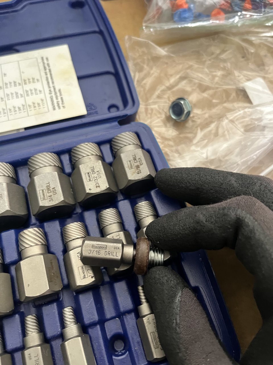

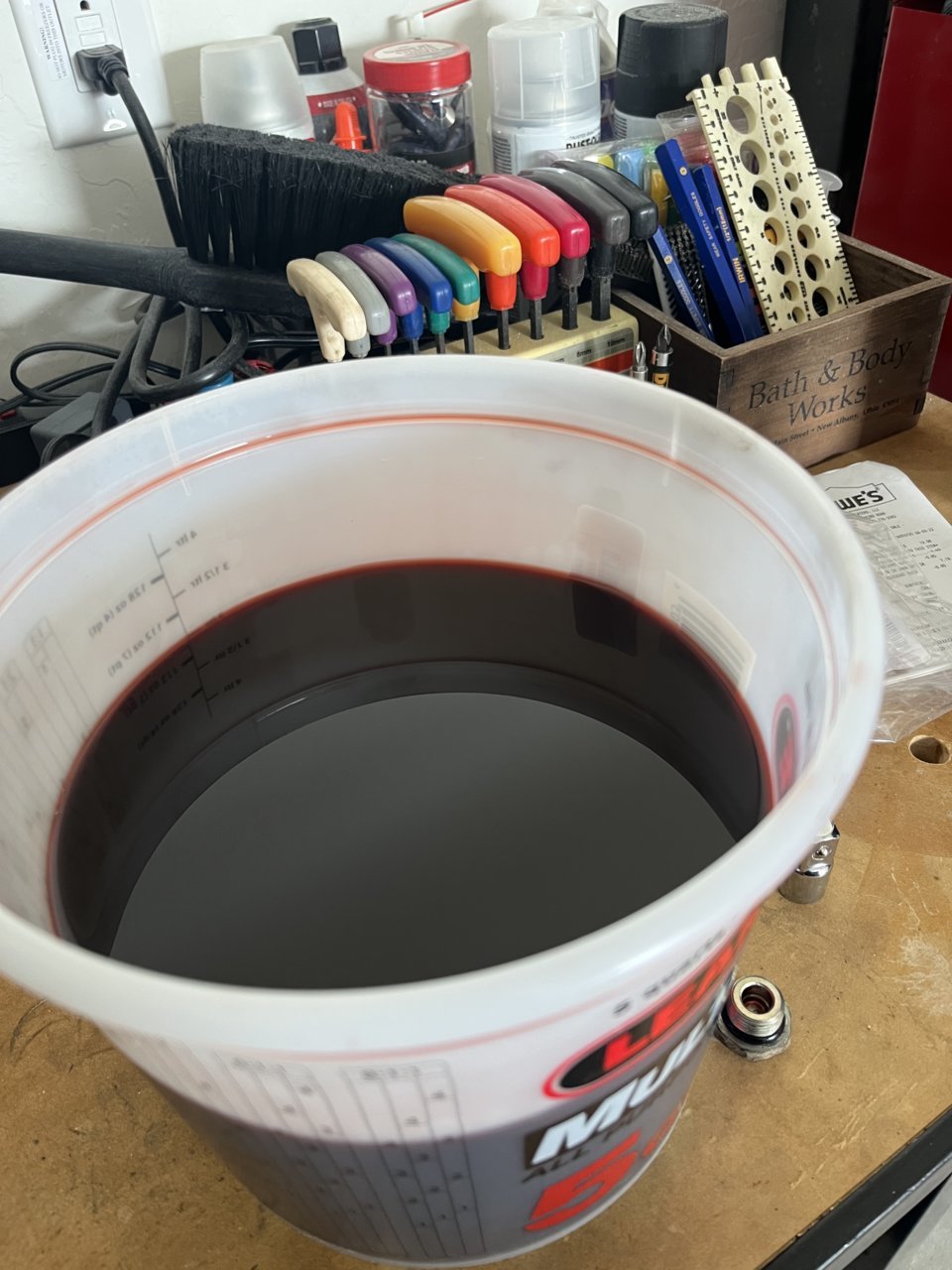

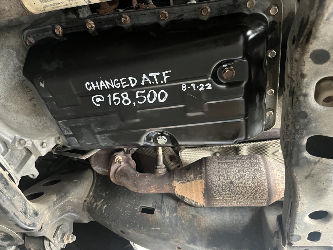

    Just performed my first drain & fill this past weekend. Previous (OG) owner flushed atf @ ~90k miles per Carfax. I drained & filled atf @ ~158k miles, and the fluid looked like it had more life left.
    I refilled with Toyota WS transmission fluid. Roughly 3.3 quarts drained and replaced.

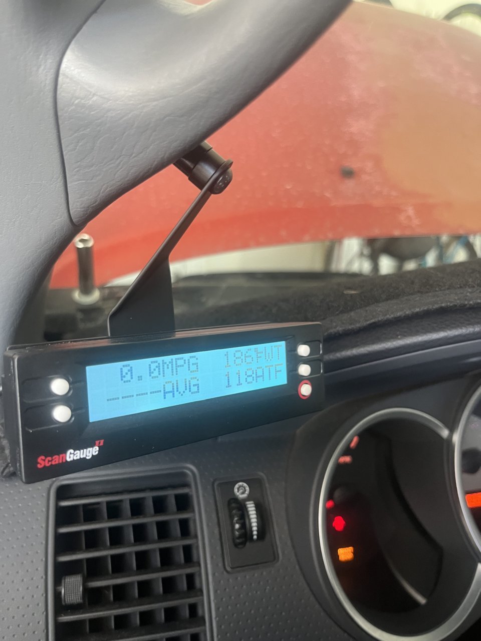

    The ScanGauge makes it super easy for temp & level checks. I knew exactly when I was at the right temperature with no shifter ritual.

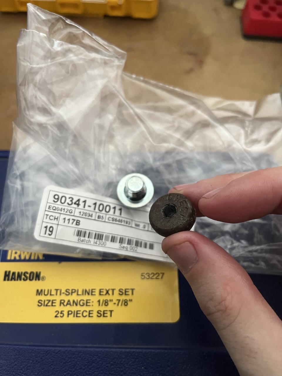

    Rusty check bolt stripped out. Thankfully I was prepared and replaced with standard hex bolt.
    This Irwin extractor set is insane. Gotten me out of two hairy situations with Toyota drain/fill plugs now. Worth its weight in gold.

    Why is the shifter ritual superior to using something like a ScanGauge or UltraGauge for the temp check though?
    Theoretically, both the SG and UG get their information from the same sensor that the shifter ritual does.
    The only thing that's different is instead of waiting for a blinking light, I waited to see a specific temperature on my gauge.

    Correct. And with the TSB @Dm93 recently discovered we know the temp range for all Tacomas with the A750 5spd is 97-115*F
