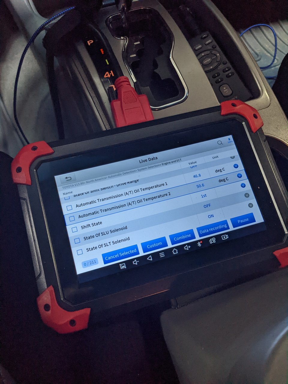

    Great info! I just put new trans cooler lines on since one of mine was starting to leak. This thread helped a ton!
    I used my XTOOL D7 to watch the trans temps rise.. worked like a charm.

    Did you use 46 to 50c? Or it is just a shot of after the fact?
    Toyota released an update stating 35-45c was intended and correct temps.

    That's pretty close to the temp I did it at since I didn't get the memo. Too bad page one wasn't updated. At any rate the truck has a quart more oil in it then it did before. I'm not going to re-do it just because I was about 1-4° high. At some point I'll probably drain the filter and change the oil. I'll make sure it's below 45 then.
    Thanks for the info by the way. I obviously didn't read through 105 pages of thread.
